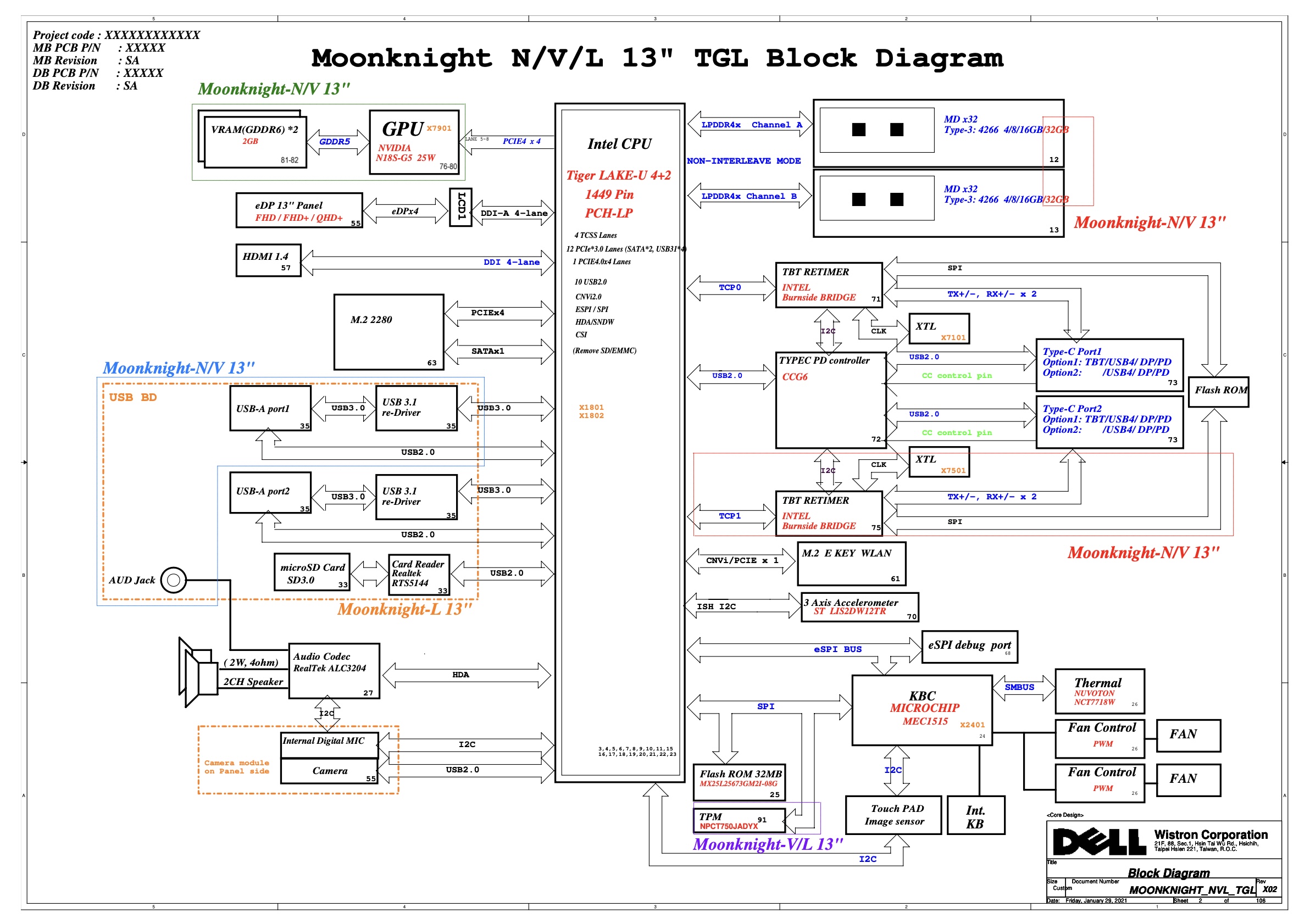

View attachment 188156Wistron MOONKNIGHT_NVL_TGL A00 19880
Schematics
