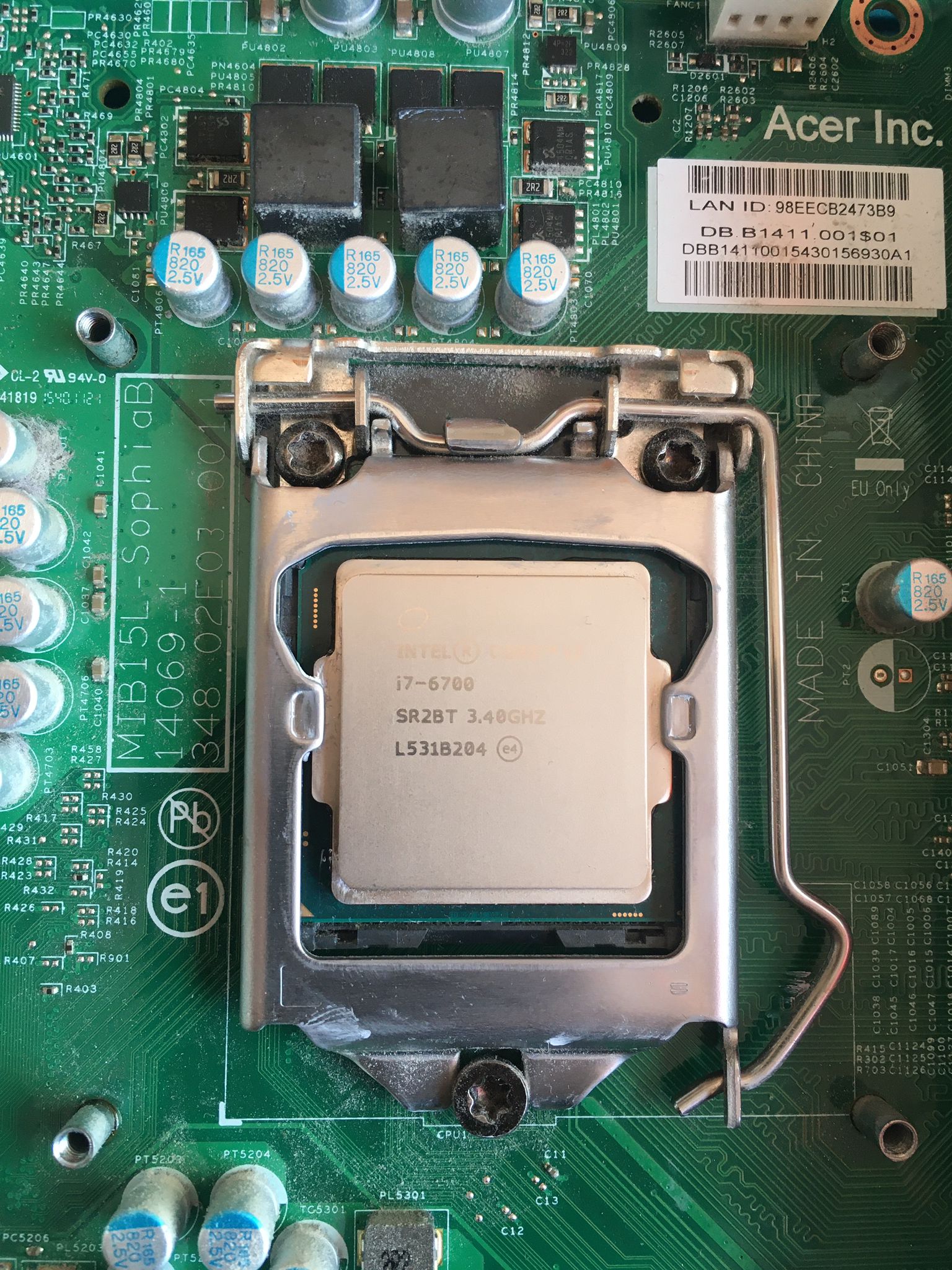

Thanks but on this bios no CPU voltages, no boot.
I was replacing shorted PCH. Looks like it needs correct bios now.
Yes exactly the same SR2C7.
On old bios the same problem.
But then I downloaded bios from Acer website but it's only 7MB. So I copied this 7MB part and paste into the old bios. After this I have voltage on CPU but no boot, no display.
On your bios and on original bios no voltage on cpu.

This 710 was the best so far but still no display :(
There is a CPU voltage on this bios and after flashing computer restarted 4 times but still no boot...
Maybe ME must be cleared?
710 Available clear, i think you need again CPU
