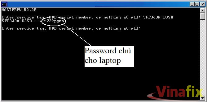

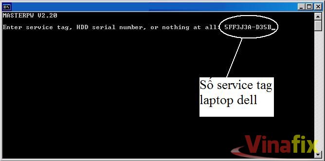

Dell Password Removal - How to use
Service Tag: D35B
1. Turn on the notebook. Let it boot to the Primary or Administrator Password Screen.
*Example of the Screen Below:
2. Open up "DellMasterPassword.EXE"
3. Then once its opened enter your service tag in all caps just like it appears on the screen.
Example of how to enter it Below:
4. Then press enter after you have entered it correctly.
5. Your password will be generated. Once it's done your password will be after the "-->"
*Example of the password "r729pgmn" Below:
6. Now enter your password on the Primary or Administrator Password Screen. Then hold down the Ctrl-key and press Enter twice
Tips:
1. On a German keyboard The key: Z = Y
2. This System does not work with Service Tags: *******-595B
