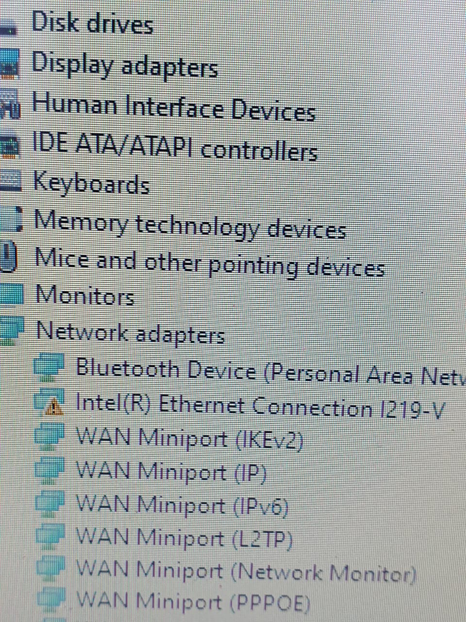

i need FMEPSY2 bios, i have not orignal backup of this machin but i have one ok machine i read data and after clear me bios work but issue is LAN show yellow mark can you make this ok bios becouse i undestand that me region problum plz try,i send you ok backup
clear me not fix problem thisi replace chip but same isshue ,i send you file plz clear me this file
you understand that this not bios isshue,but i confarm that becouse i put many bios on working laptop same problum,so if this not ME problum but problum in bios so plz fix if possibleclear me not fix problem this
all BIOS have the same problem it shows good BIOS, you need to check the hardwareyou understand that this not bios isshue,but i confarm that becouse i put many bios on working laptop same problum,so if this not ME problum but problum in bios so plz fix if possible
dear plz try to understand i aske you i have one working laptop LAN and wifi working on this laptop when i put any other bios on this working machine same problum comes on this machineall BIOS have the same problem it shows good BIOS, you need to check the hardware
