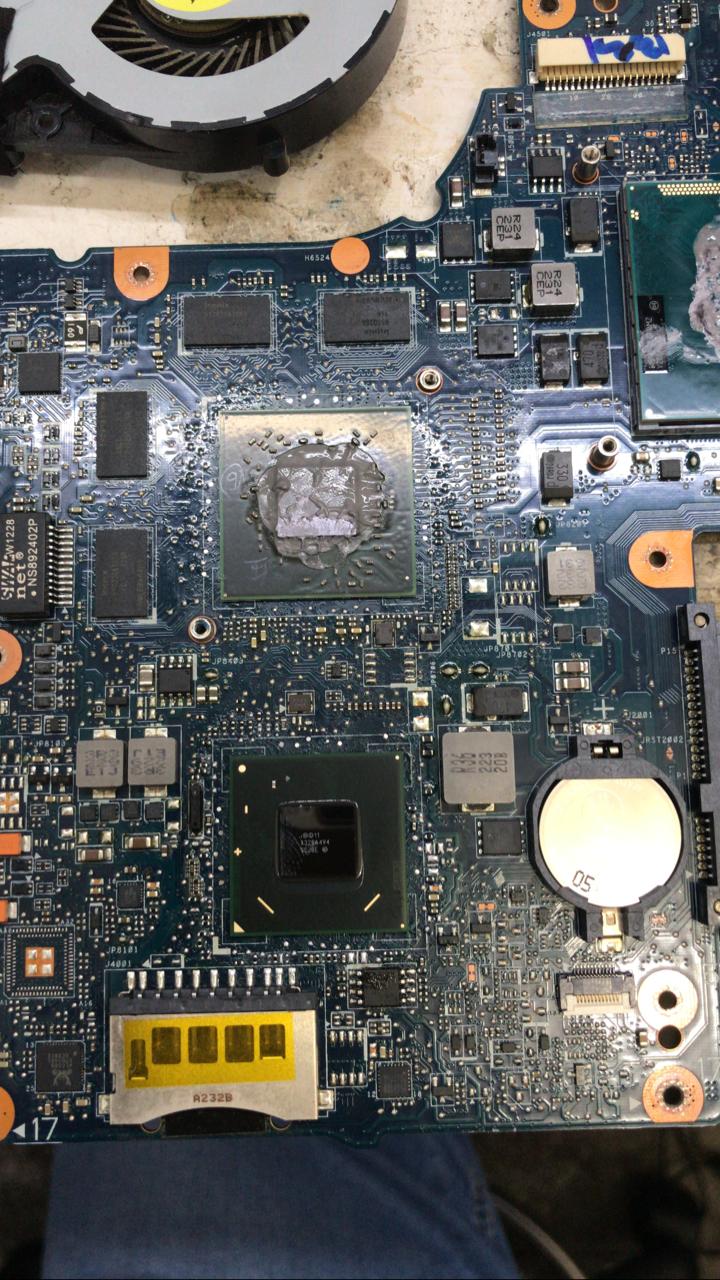

are you sure this bios/ec is for C855-2j5 PLF/PLR/CSF/CSR-DSC Rev: 2.1 with Ati?
i flash it and now the DCin light is flashing but nothing happend.
thank you
yes, and above have many BIOS you can try more and I think you need check more GPU
its not a GPU Problem, i have 3,3V on Bios pin 8 and 3,3 on PowerButton that they get 0 when i press it, but rsmrst is not present so either is a Bios/EC Problem or IO itself.
