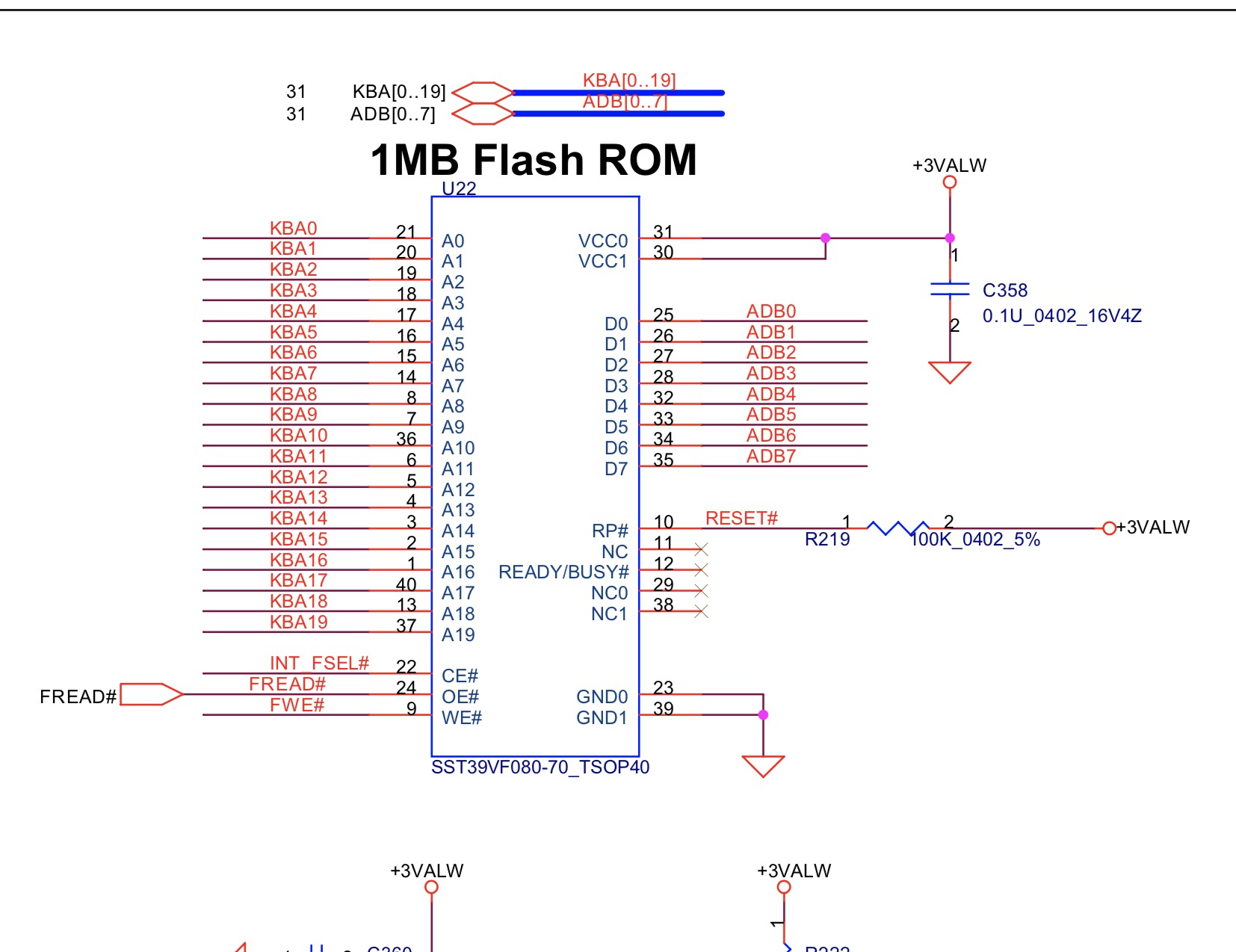

Is the BIOS component the U23 ? AT24C16N-10SI-2.7_SO8 ? because I can't read it.Toshiba Satellite A110 (Compal LA-3171P)
EQUIUM A110-233 PSAB2E
1KB ? only have info.Is the BIOS component the U23 ? AT24C16N-10SI-2.7_SO8 ? because I can't read it.
Sir, I don't know. It does not get detected on the programmer. What to do to reprogram the bios in this Toshiba ? Could you check the schematic you got there and tell me maybe ? Thanks.1KB ? only have info.
Thank you for your time.You have chosen the wrong BIOS chip
