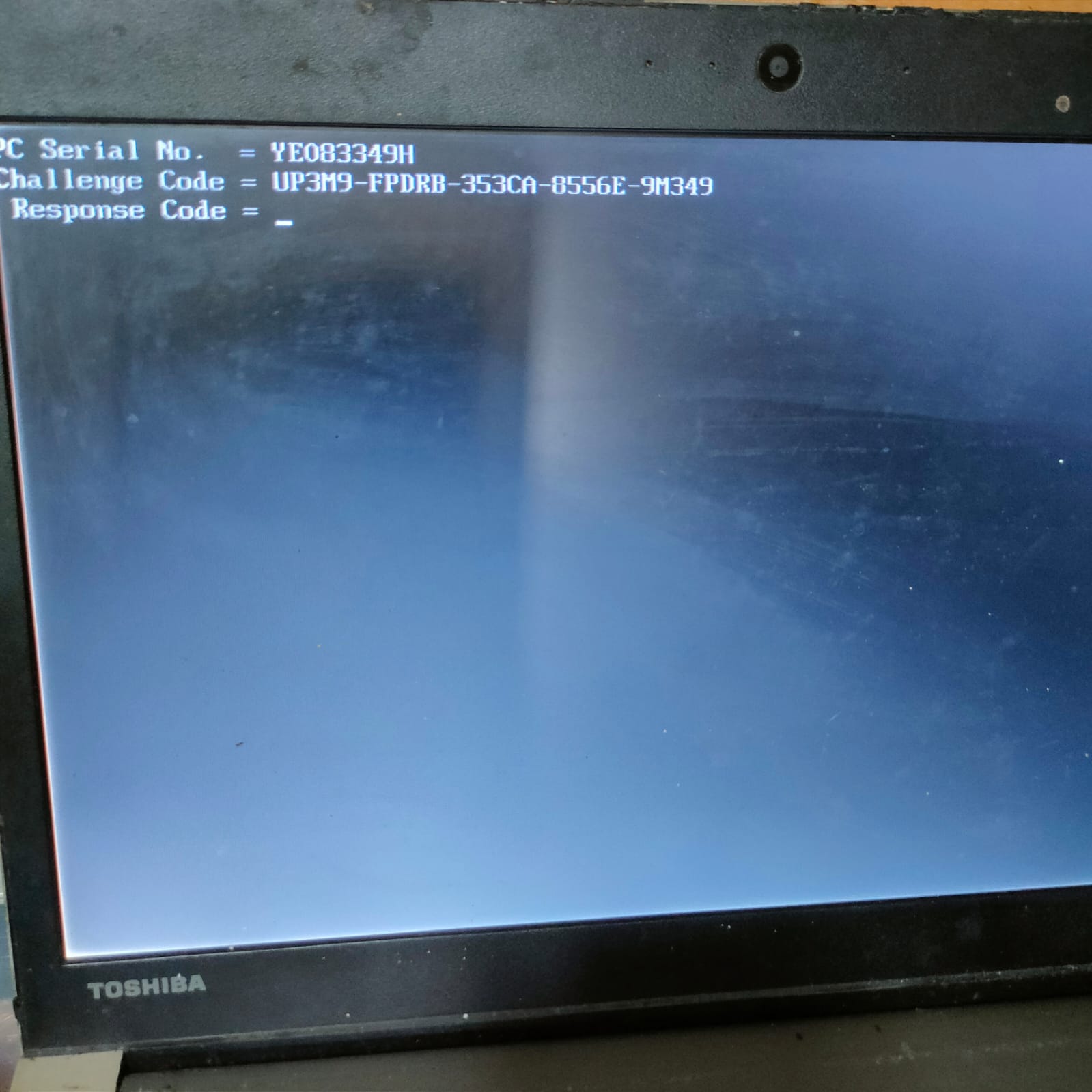

can you send me the respond code... because im flashing ic bios cant change nothingdòng này đâu có remove từ BIOS được, phải mua key 30$ bạn ko nạp BIOS

Note: The Challenge and Response Code makes it possible to bypass the BIOS password. Clearing must be done in the System Setup (BIOS).
Switch on the notebook, when the boot logo appears press [F2].
"Password=" will be display.
Press keys in the order [CTRL], [TAB], [CTRL] and [ENTER].
The Serial number and Challenge code will be displayed.
Take a picture of it, and send to me
Please do not mix up "0" and "O" or "C" and "G" or "8" and "B".
IMPORTANT :
Do not switch off the laptop or restart, cause response code ll change, NO REFUND if so
You will receive the "Response code"
Enter the Response code (do not mix up "0" and "O" or "C" and "G" or "8" and "B")
and press [ENTER] key.
The "TOSHIBA Setup Utility" (BIOS) appears.
Go to the "Securtiy" tab by pressing the cursor right key [->].
Check if the line "User Password Registered" is marked.
Press [ENTER] then [space bar] and [ENTER] key three times to set the password to "Not Registered".
Press [F10] key to save the changes and confirm this by pressing the [Y] key.
The BIOS Password is deleted.
Press F2 go bios setting and enter agian this code then unlock remember
Note: Please take photo or video when enter code
25$can you send me the respond code... because im flashing ic bios cant change nothing
