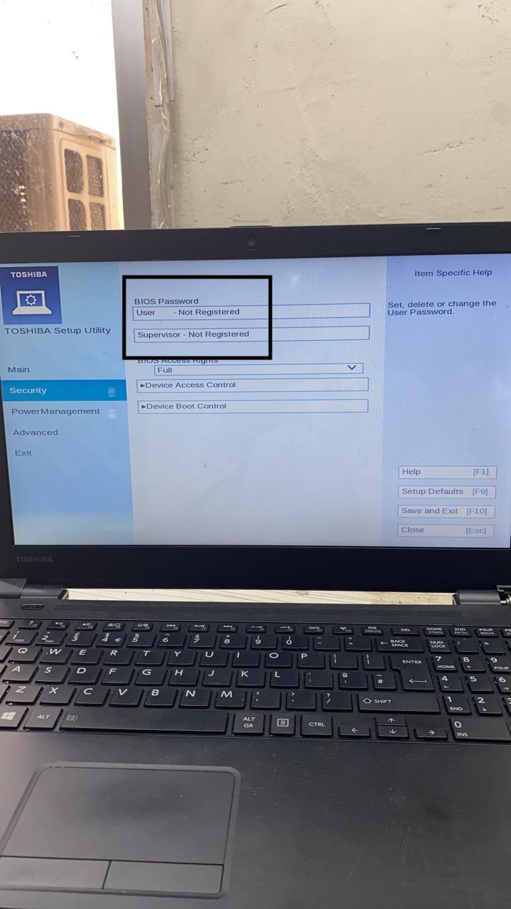

Toshiba challenge response generator
You will receive the "Response code"
Enter the Response code (do not mix up "0" and "O" or "C" and "G" or "8" and "B")
and press [ENTER] key.
The "TOSHIBA Setup Utility" (BIOS) appears.
Go to the "Securtiy" tab by pressing the cursor right key [->].
Check if the line "User Password Registered" is marked.
Press [ENTER] then [space bar] and [ENTER] key three times to set the password to "Not Registered".
Press [F10] key to save the changes and confirm this by pressing the [Y] key.
The BIOS Password is deleted.

It just ask me to press f2 to set date and time, then it boot straight to windows. I'm scared if i try to enter set up after restart it will still request for password
It ask for password after I shut down and turn it back on, but I click enter and it showed certified then boot straight to windows. Should I try entering set up to clear the password?
