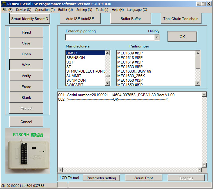

Need to Program both Areas in SMSC MEC1633L (SP and 256K ) ?
Or only SP ?
Mec1633#SP for onBoard
Mec1633@BGA169 in Adapter
Mec1633_256K for Serial and DMI Data
Need Power only connected or Power switched on ?
( my Unit switch on for only 3 Seconds and then off )
yes, all power to the motherboard, no need switched.What is correct EC File for my ?
Or only SP ?
194kb
no 192kb is size file rom, name in menu you only use right name MECXXXXRT809H have no 192K
