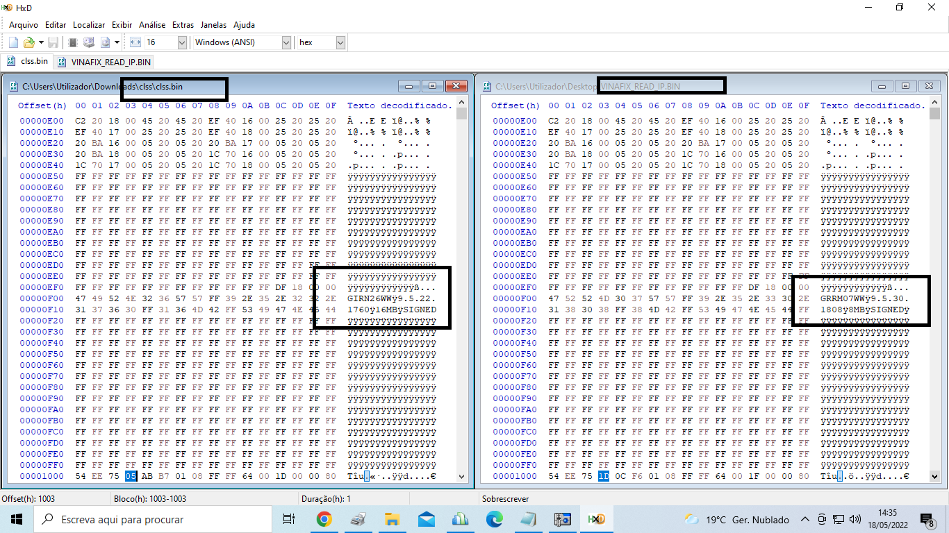

PLEASE BUILD or repair this bios orig not display.
laptop display with another file but have problem ME REGION
my mother
LQM-1 12298-2 48.4LY06.021
BIOS:
25L6475E (read with tl866)
motherboard:
LMQ-1 MB
12298-2
48.4LY06.021
PROBLEM: POWER LED GREEN OK, NO IMAGE. BACKLIGHT KEYBOARD LIGHT ON (PSU 20V AT 0.4A STABLE)
BIOS CORRUPTED ?, FIX AND GIVE CLEAN ME.
VINAFIX_READ_IP.BIN
no the bios i send is : VINAFIX_READ_IP.BIN and pc power on, dont turn off but no image.
the bios you send me clss.zip pc power on 1 sec fan spin 1 sec, no image and give error blink 3 times power on and goes off.
that shows the problem isn't coming from the BIOS, it only makes sense if you send the original BIOS don't send back those BIOS you downloaded from the interne
