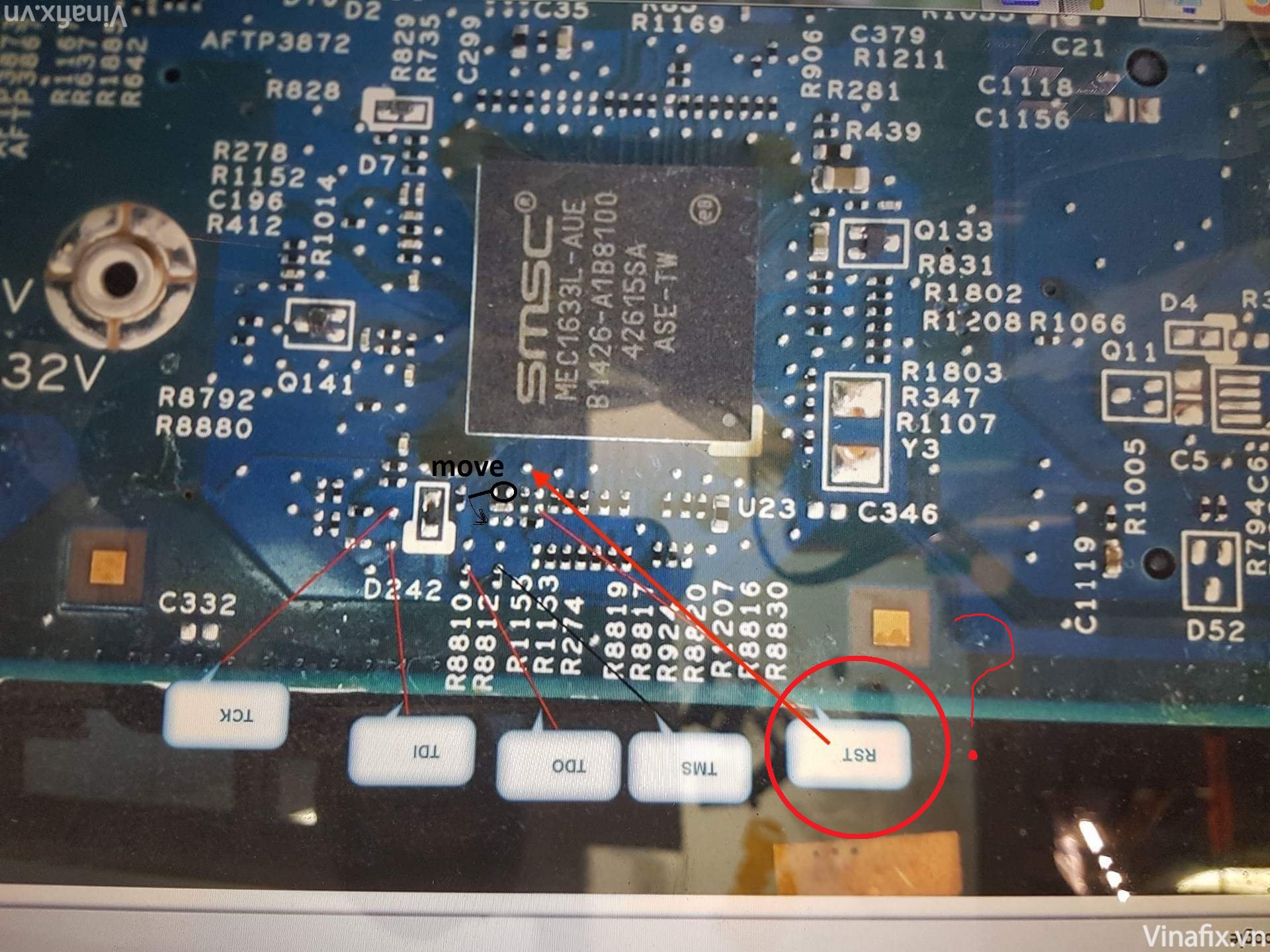

Lenovo X1 Carbon 2th Gen Schematic & Boardview – Wistron LMQ-1 12298-2 Schematic & Boardview
12298-2 Carbon X1 MEC1633 connect
Mystique-1 Shark Bay Block Diagram

LMQ-1 MB
12298-2
48.4LY06.021
MEC1633L-AUE

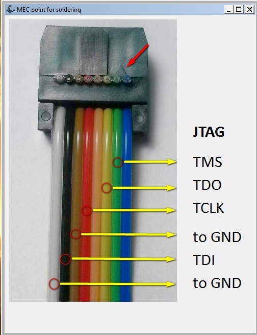

Mi programador MEC: SAS PROGRAMER REV: 3.4
Como soldar pin de este programador?
