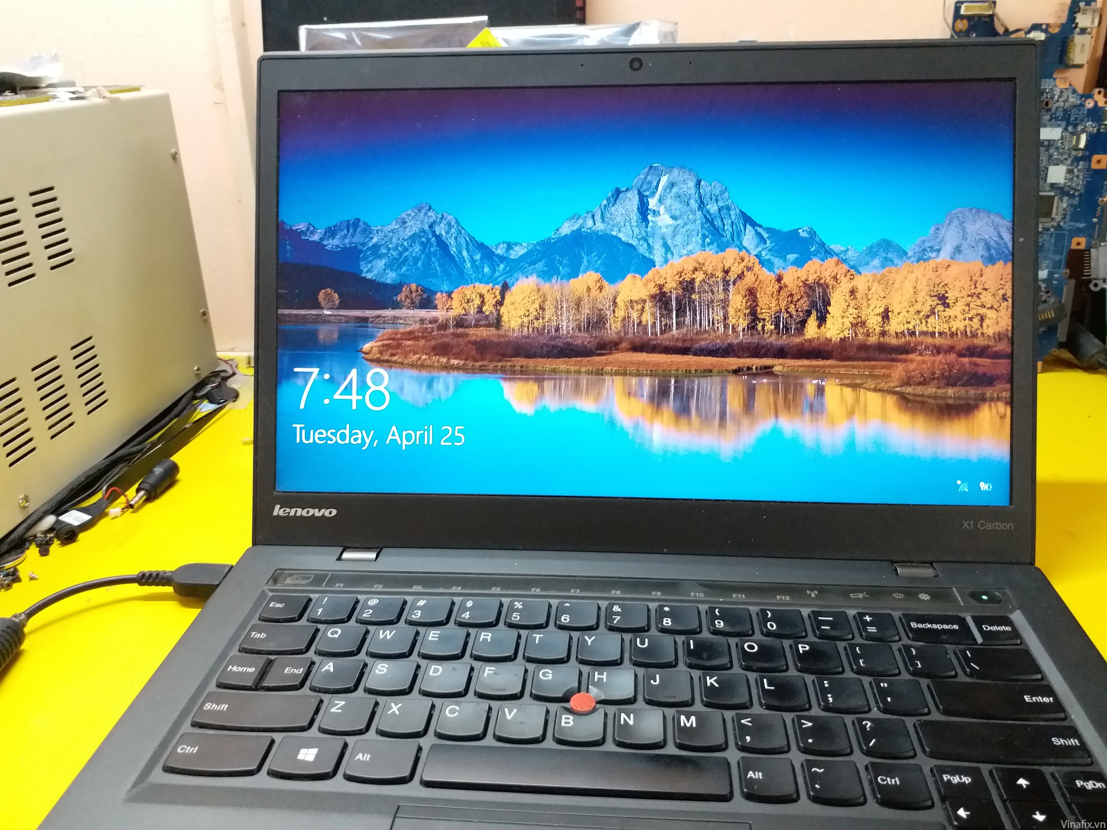

got this unit on my bench , symptom of him is turn on no image , stay like that for 3 second then it shutdown and turn on again and is constantly doing this. mine is a 16MB , tryed all from the site here , and some make the same , others bios stay turned on but no display , i notice touch bar is working , but no display at all .
i can give you all info and chek if you can get a bios or maybe possible to fix my original bios ?
its a LENOVO X1 carbon
I5 CPU with PCH ,
NO GPU
motherboard is a LMQ-1 MB 12298-2 48.4ly06.021

can have one error other ( no is BIOS ) ?
not sure of what you're trying to say but :
well cheking motherboard , it does not show signals of short or bad connections , all seems fine , except that machine with original bios , turn on and off in loop without giving image (and stay on for max 3 second)
i tryed some bios of this thread but 2 bios make the same as mine , and the outher 3 computer turn on , stay urned on , keyboard have light , touch bar is working , but no display ! (no image)

Because all bios above can not work.
