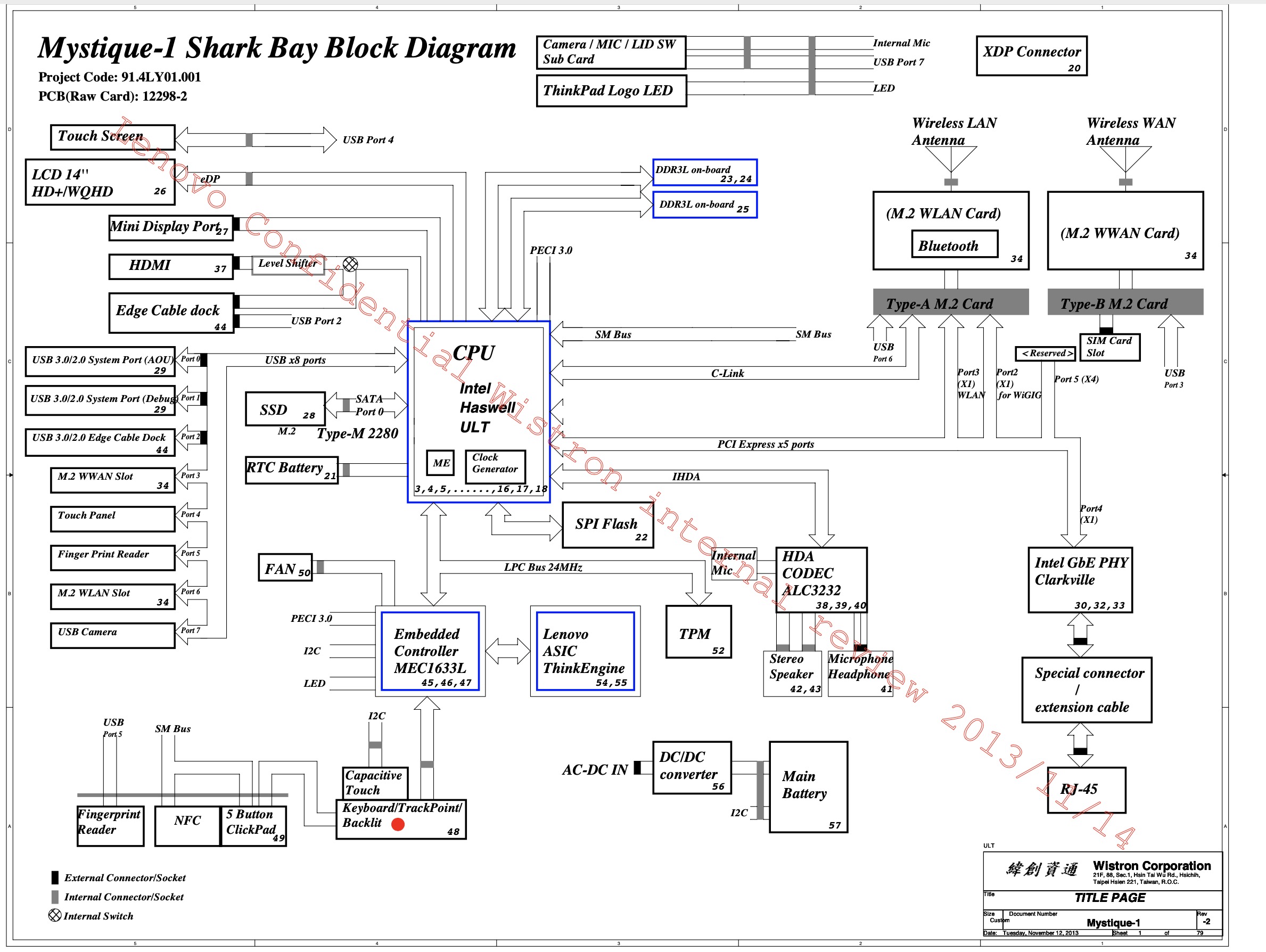

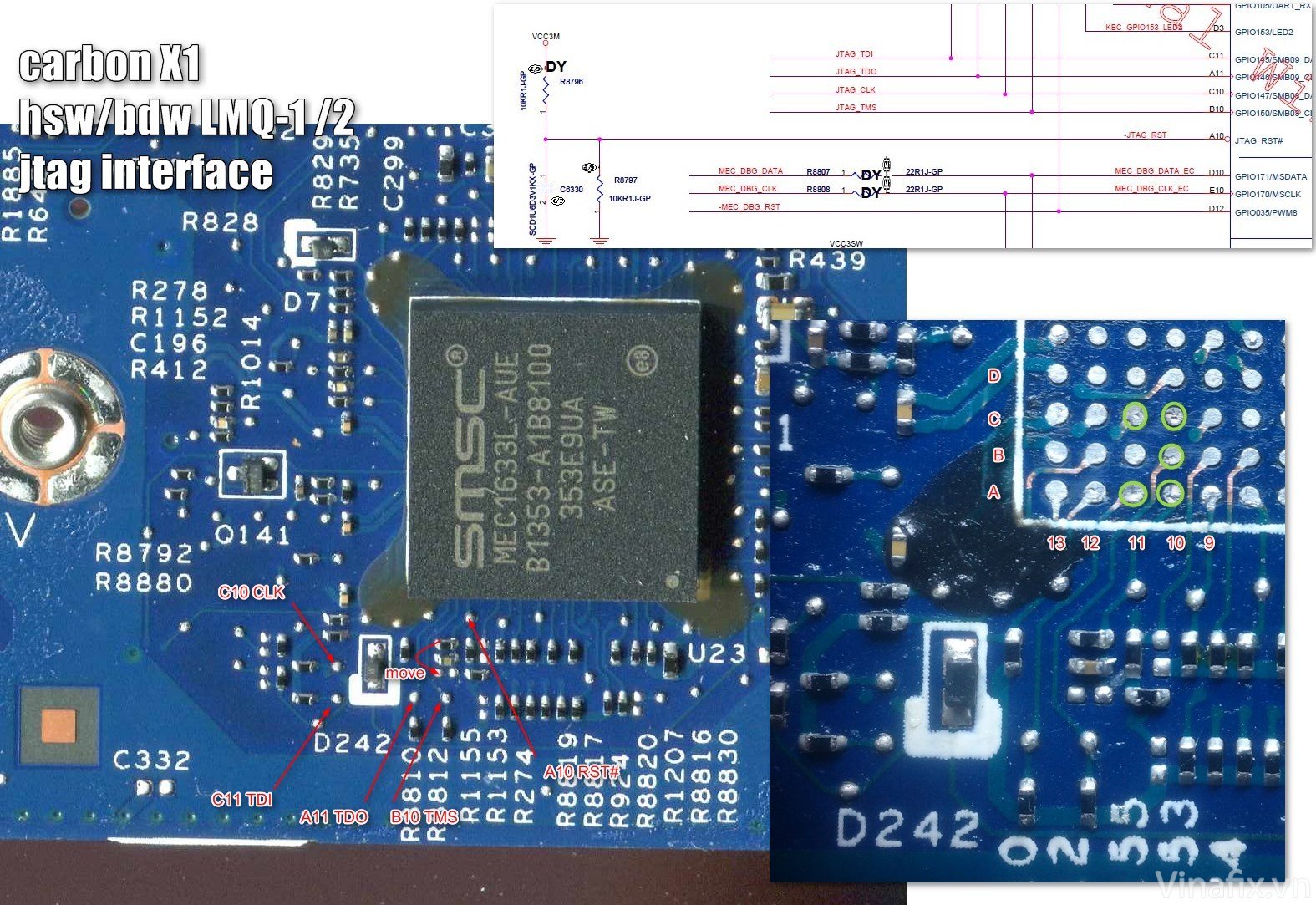

Hi ! Could U fix my old BIOS , the screen stay black after power off , laptop was turned off during bios update .

Hi Can You repair my old BIOS LMQ-1 MB 12298-2 48.4LY06.021
There is a black LCD when its turning on , it was turned off during BIOS update
