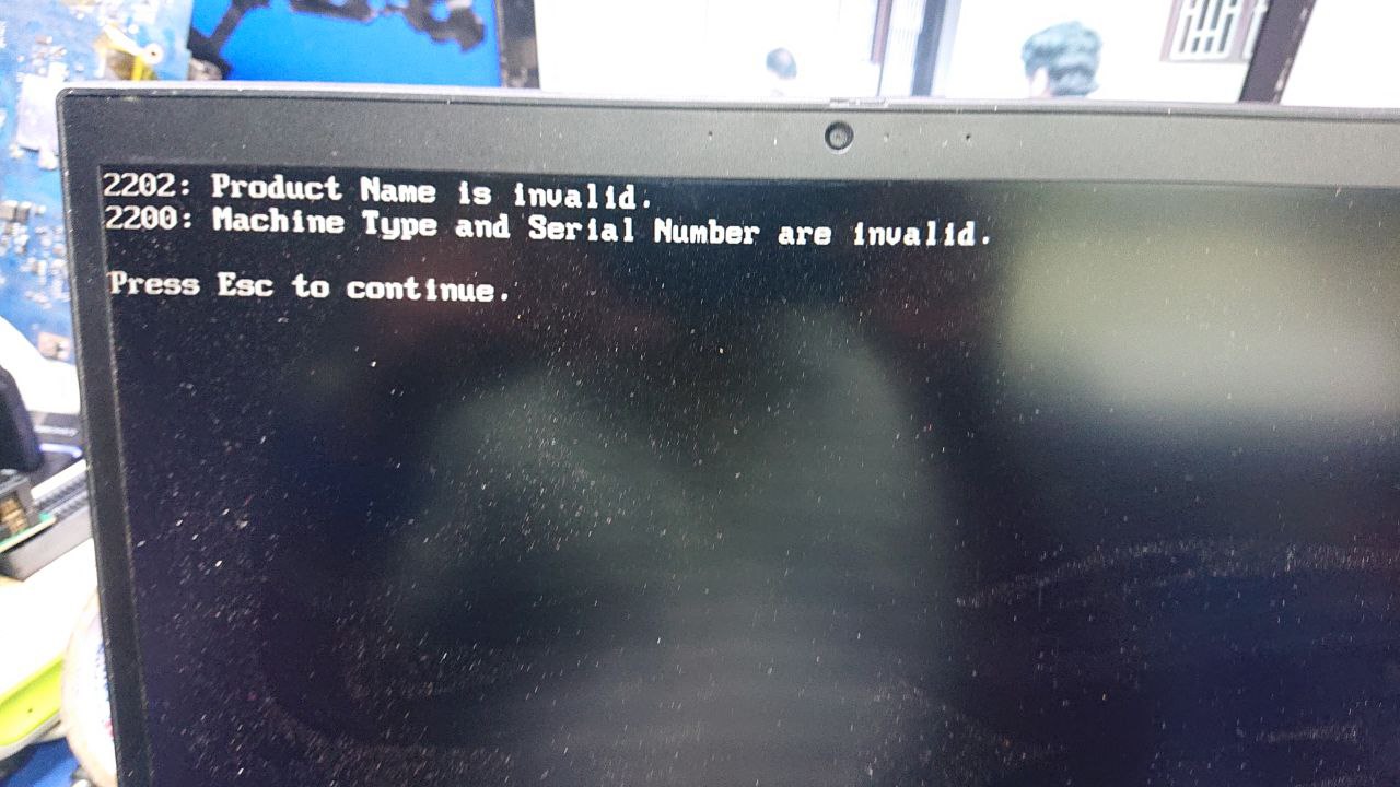

After programing laptop wont turn on, only 3 times led blinking. After i used old bios and same problém. Now not turn on with every bios, do you now where could be problem - program MEC?

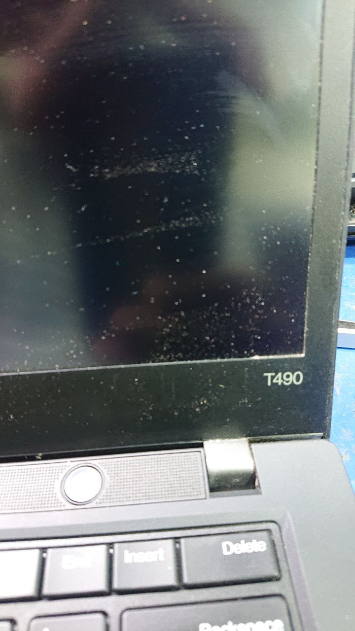

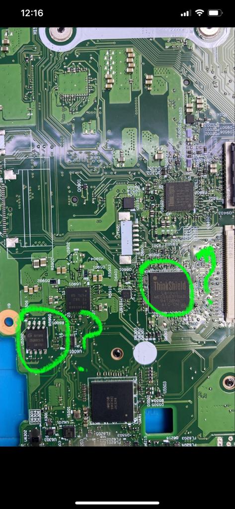

i have t490 laptop can u fix this problem si.. plz find the out the below images sir.. can u clear this problem
if possible sir ill sent the backup to u
This is an error caused by your EC programming
