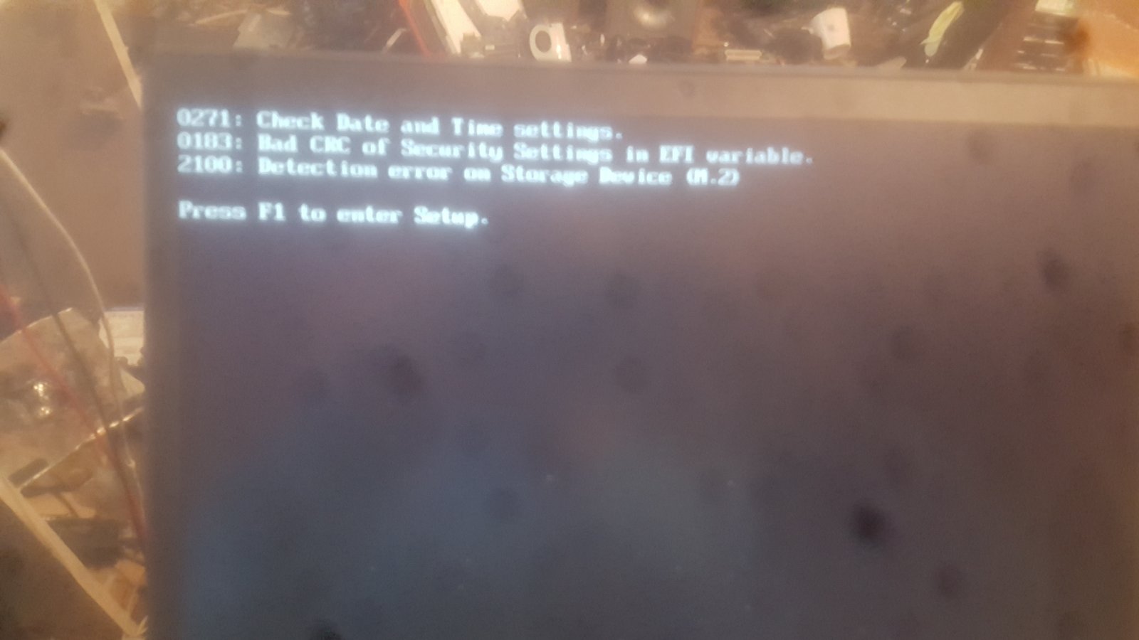

Hi,i have t460s and when i press F1 to enter bios,that show me computrace,please need help to remove computrace,i attach board model and the image show computrace
Hi
I need help to read mec1653-ba1 with rt809h on this laptop t460s
I know where is jtag points on board but no want work say this message
Chip may be damaged or encrypted
Damaged cant be because laptop working but have password
Any idea ?
Thanks

laptop have password ?
backup bios PCH send i check before,
MEC programming is difficult and difficult to succeed
Hi
Yes have password but i think is not bios password is supervizor password i think
And this password is on mec?
Thank you
