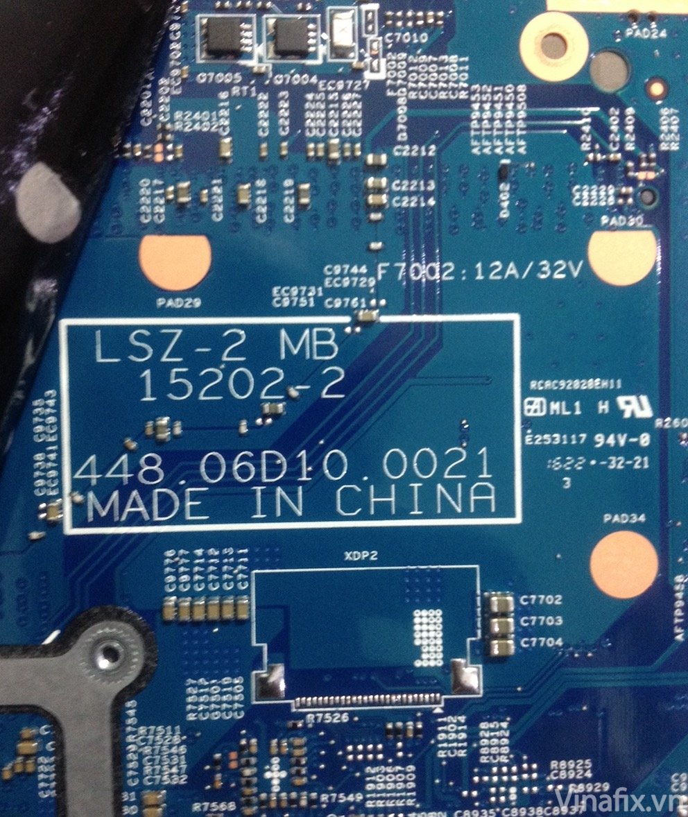

Hello
After flashing this BIN file no video on output, it´s Lenovo T560, with this motherboard assebly inside. The board N.O. is correct, also tried the other BIN files from the model (15202-2 - you have it on other thread. That flash did an shutdown on the laptop. ) this one is good, laptop doesn´t shut down but no video. Please try to send me another one, MB is just same as on picture above (all numbers matches)
Customer said the laptop died when updating BIOS. Can´t cut the file from manufacturer for this model.
Yes we caompared. Beginning is same, but there are some differences... It ´s reasonable,SN and other ID´s won´t match. We managed to extract manufacturer BIOS to 2 .FL files , but it´s 9 MB only we need 16MB flash for the 128mb chip
Attaching the FLfiles- can you cut it for us ? Customer is waiting for it and we have to give him answer until Monday if we are able to fix it. Colleague said there was one flash it was working with,.. aftrer a week cutomer send it back it´s no video again

hi thienbui,
i have t560.
bios is working after 20 sec and no boot options (USB - HDD) only network .
bios have no password.
can you build a working bios? all bios above not working

hi thienbui,
i have t560.
Not sure you need try BIOS other and compare
