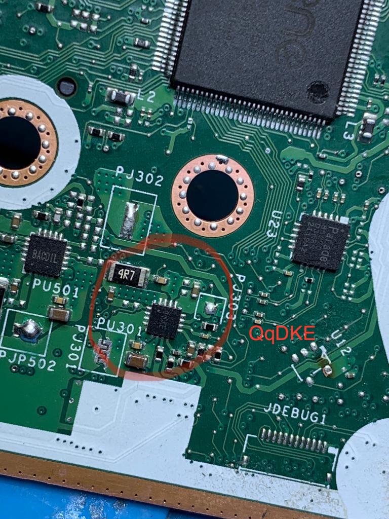

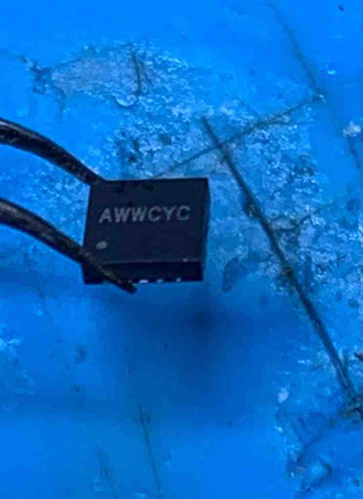

anyone have ThinkBook 15 G2 -ITL LA-K052P schematic ?or any one know this IC number ?View attachment 242075
How many pin this ic?anyone have ThinkBook 15 G2 -ITL LA-K052P schematic ?or any one know this IC number ?View attachment 242075

Thanks and do you know this number also ?

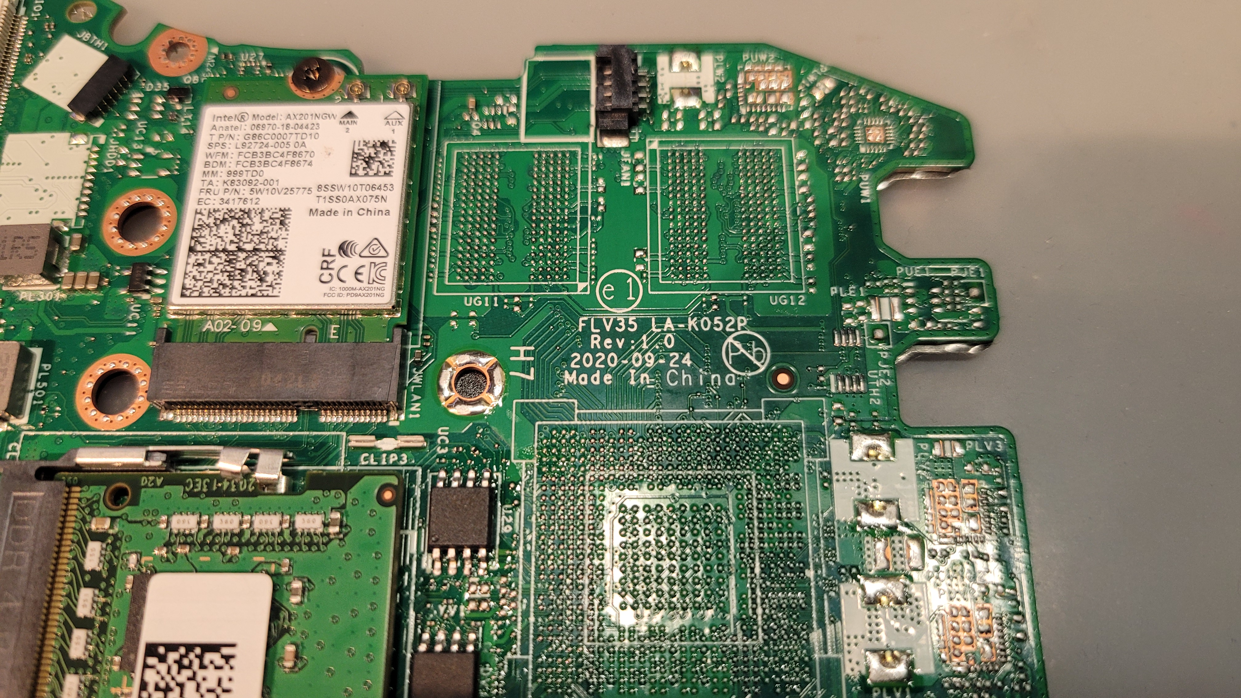

model and Motherboard code ?I have BIOS 4MB and 8MB not 8MB and 16MB
FLV35 LA-K052P REV: 1.0
UC3 is CHIP MXC QH64AHIG
UC12 is CHIP MXC QH128AHIG
Notebook model ThinkBook 15 G2 ITL
64=8mbUC3 is CHIP MXC QH64AHIG
SY8388DThanks and do you know this number also ?
clearme is the cause of the GPU error until now you still don't understand the problem??The laptop does not detect the graphics card
does the clear me resolve this problem if it is
clear me Bios
Yeah it's New information for me thanks alot for thatclearme is the cause of the GPU error until now you still don't understand the problem??
