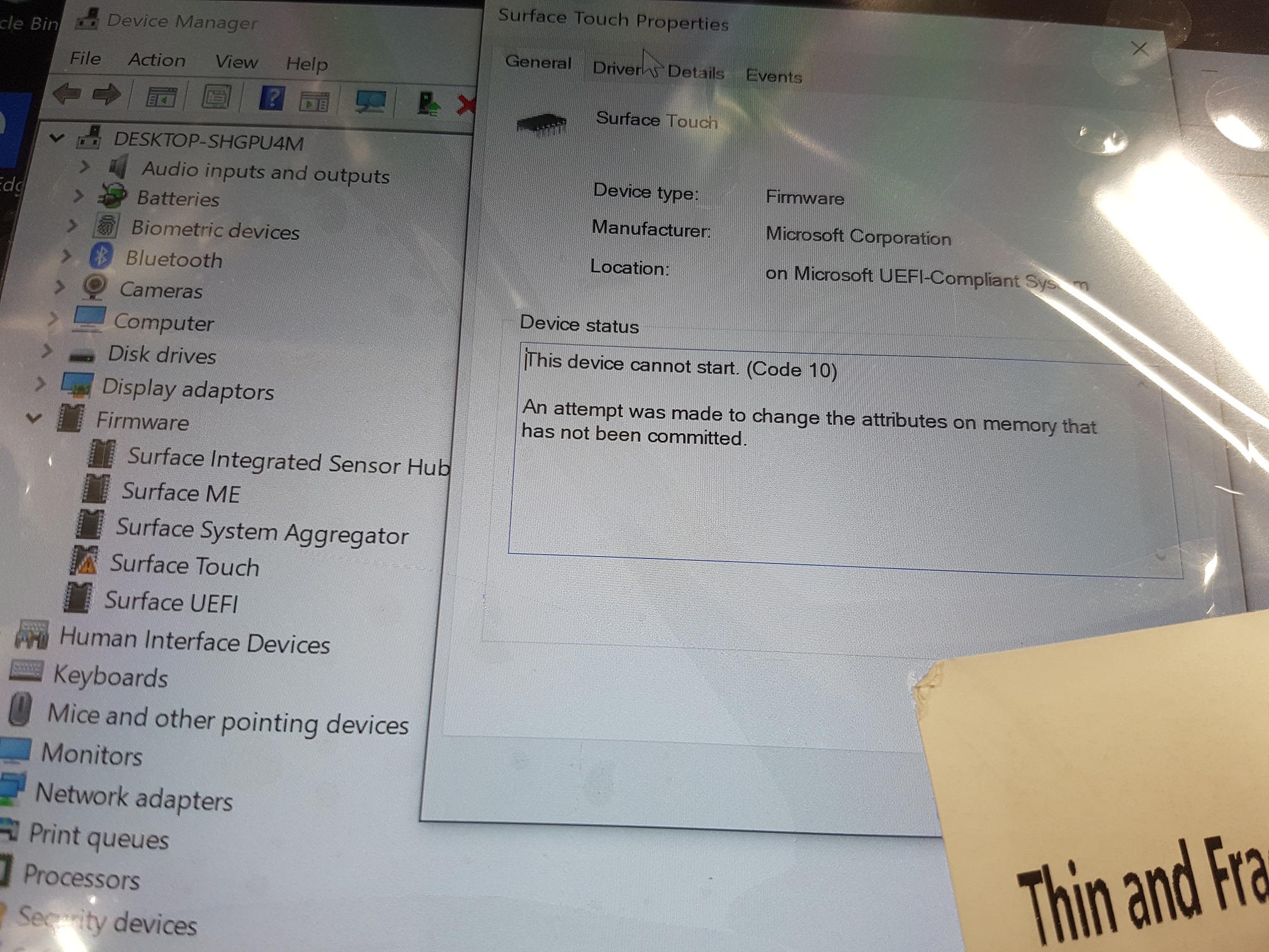

I have a Surface pro 5, M1007506-015 board, was not booting correctly.
Microsoft logo came up, 4 secords and off. no boot
Flashed this dump, Surface boots to windows, but touchscreen does not work.
Same with new screen.
I attach here the original non-working bios dump.
Can anyone help here to clear ME?
Thank you!

why need clear me? make video i check
above have many BIOS unpasss good you can use
well with original bios no boot, only Logo for 1 sec
with bios from post, device works but no touchscreen.
Tried an unpass bios, same thing, works but no touch
I wonder if its something wrong within the bios or motherboard itself.

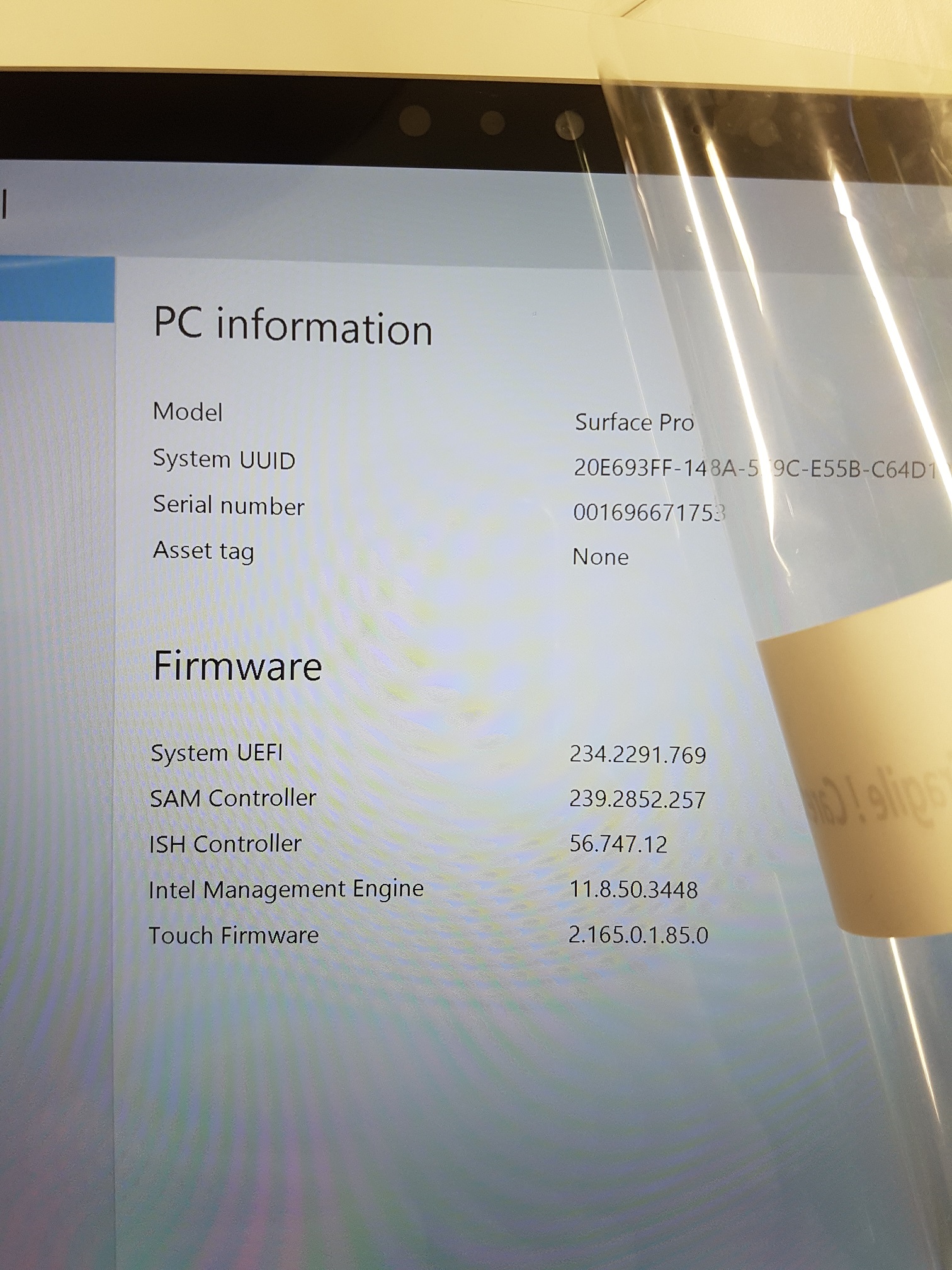

heres the pics i get in windows for the touchscreen firmware.
Any idea?
Any idea?
yes, need have Original and builds
