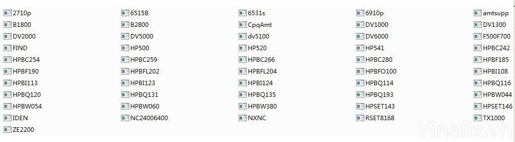

Collection Series Number Notebook HP (HP DMI) NbDmiFit, DMIFIT
HP provides the following tools for re-flashing the DMI region:
  • HP Mobile Firmware Interface Tool (DMIFIT) — this tool, introduced in 2009, combines the previous consumer and commercial notebook DMI flashing tools (HPSetCfg and BrandIT) into one package. This combined package enables one version of the utility to support all consumer and commercial product families that shipped after 2C08. This tool replaces HPSetCfg and BrandIT.
  • Windows DMI Firmware Interface Tool (WNDMIFIT) — HP business notebooks made after 2011 must use the WNDMIFIT tool to update DMI information.
To use the WNDMIFIT utility to update the DMI information:
