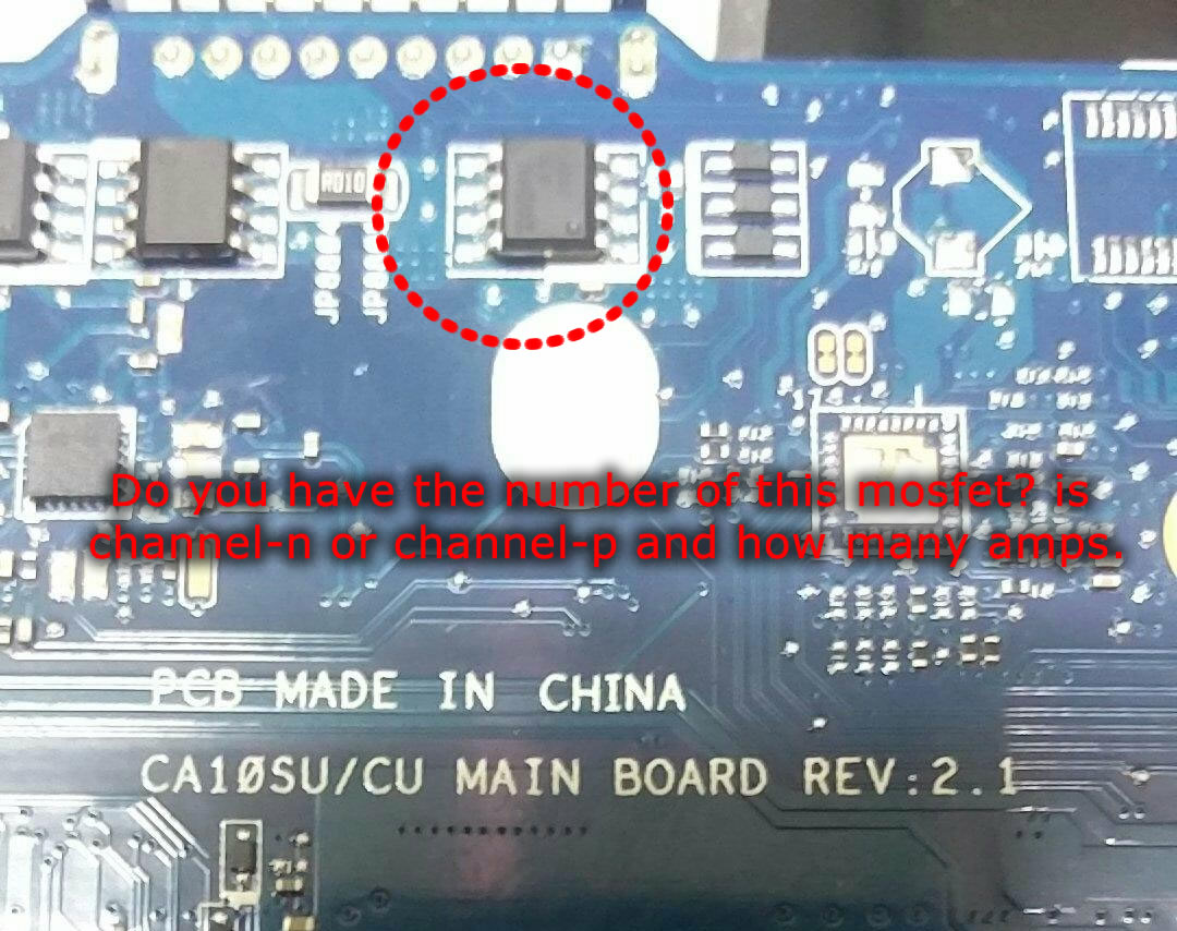

hi, i got a board without this component. it is the Q8806. What code will it have? I don't know if it's channel-N or channel-p and how many amps.
I appreciate your help.
regards
regards

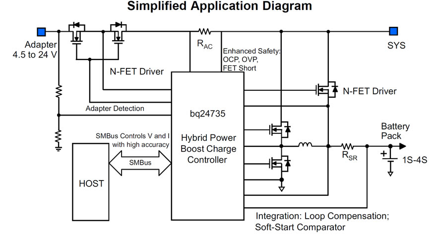

look up the charge controller IC BQ735 information and use an n-channel mosfet; I put a mosfet with that characteristic and the plate was operational
