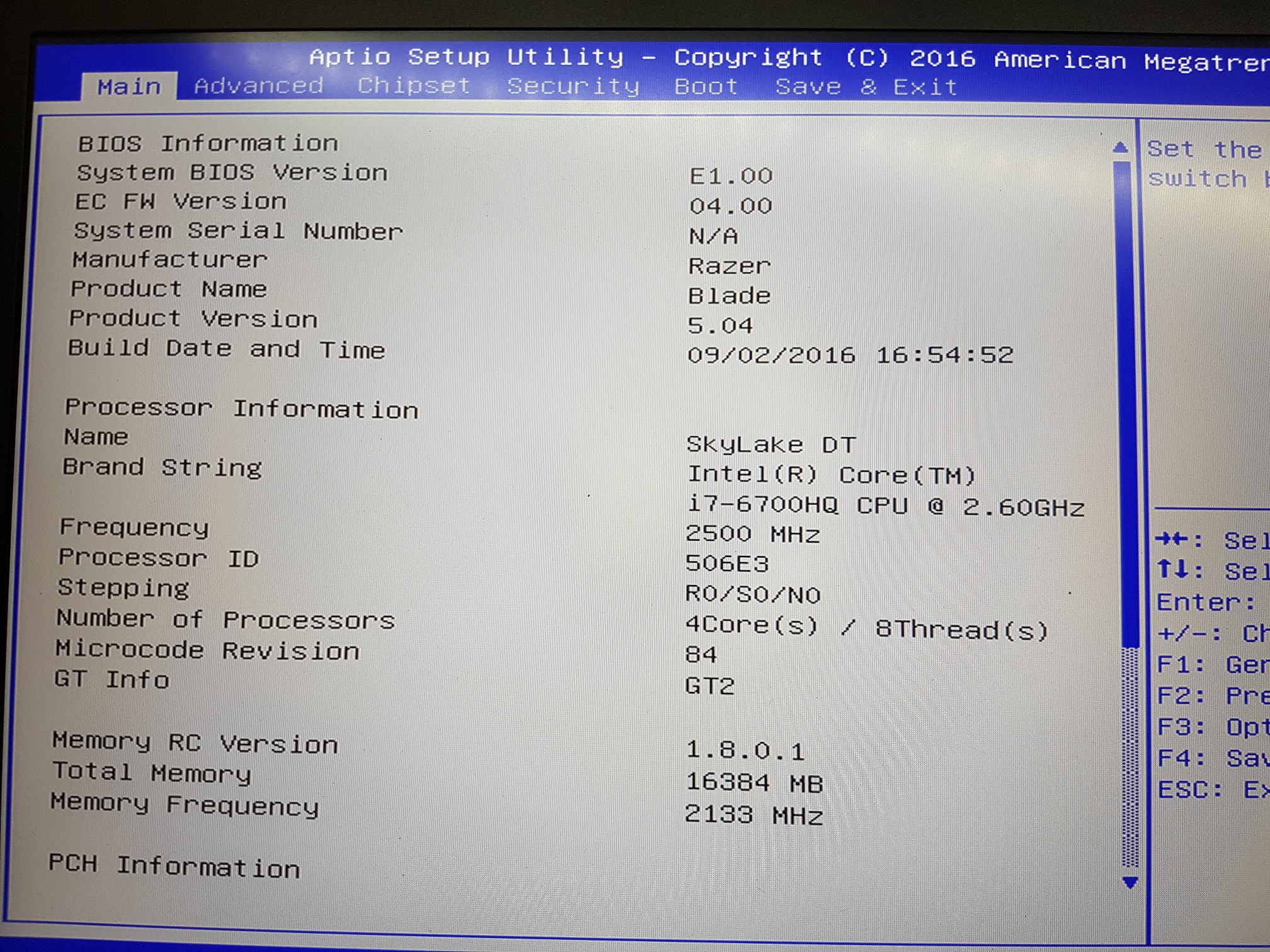

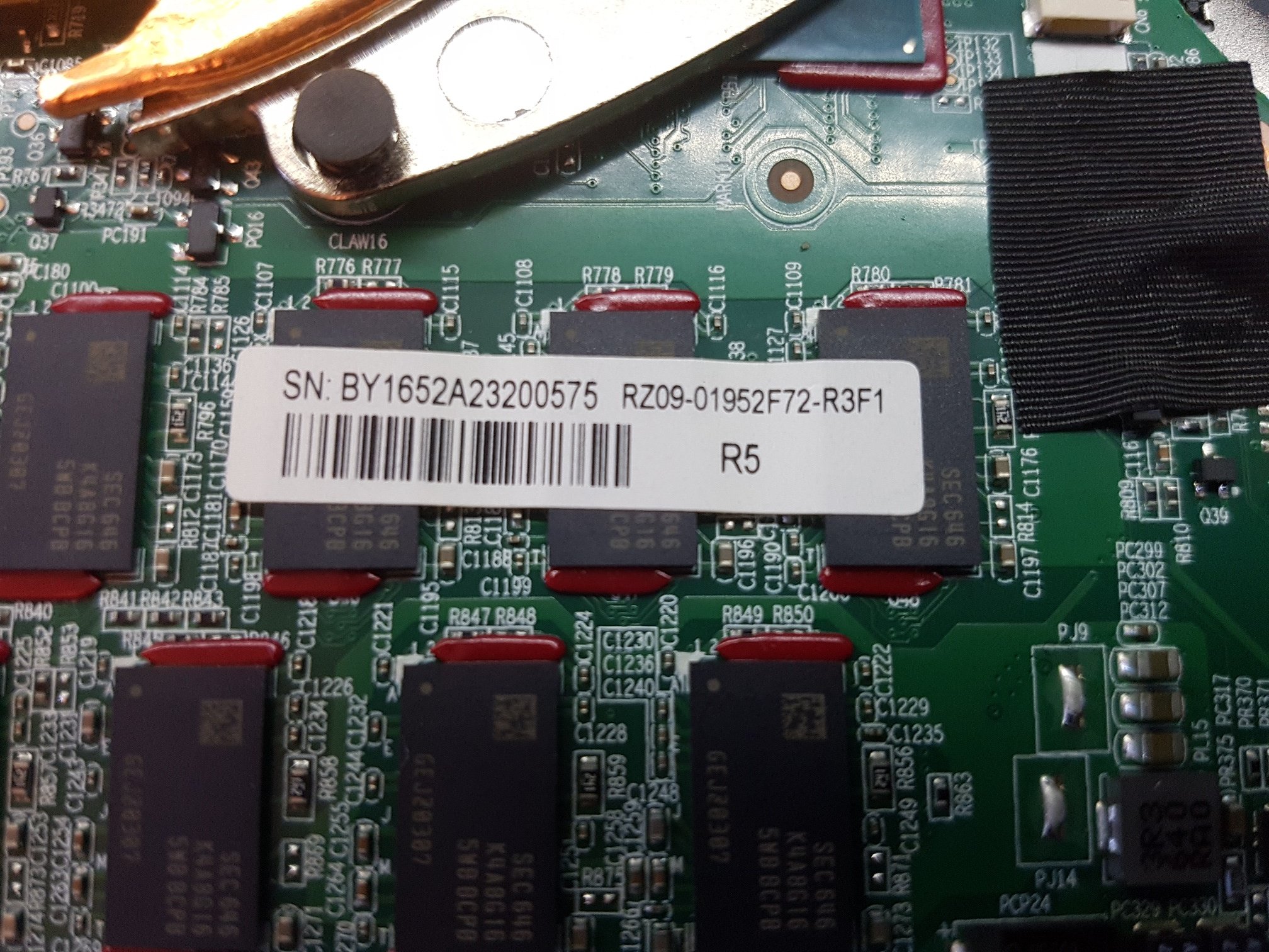

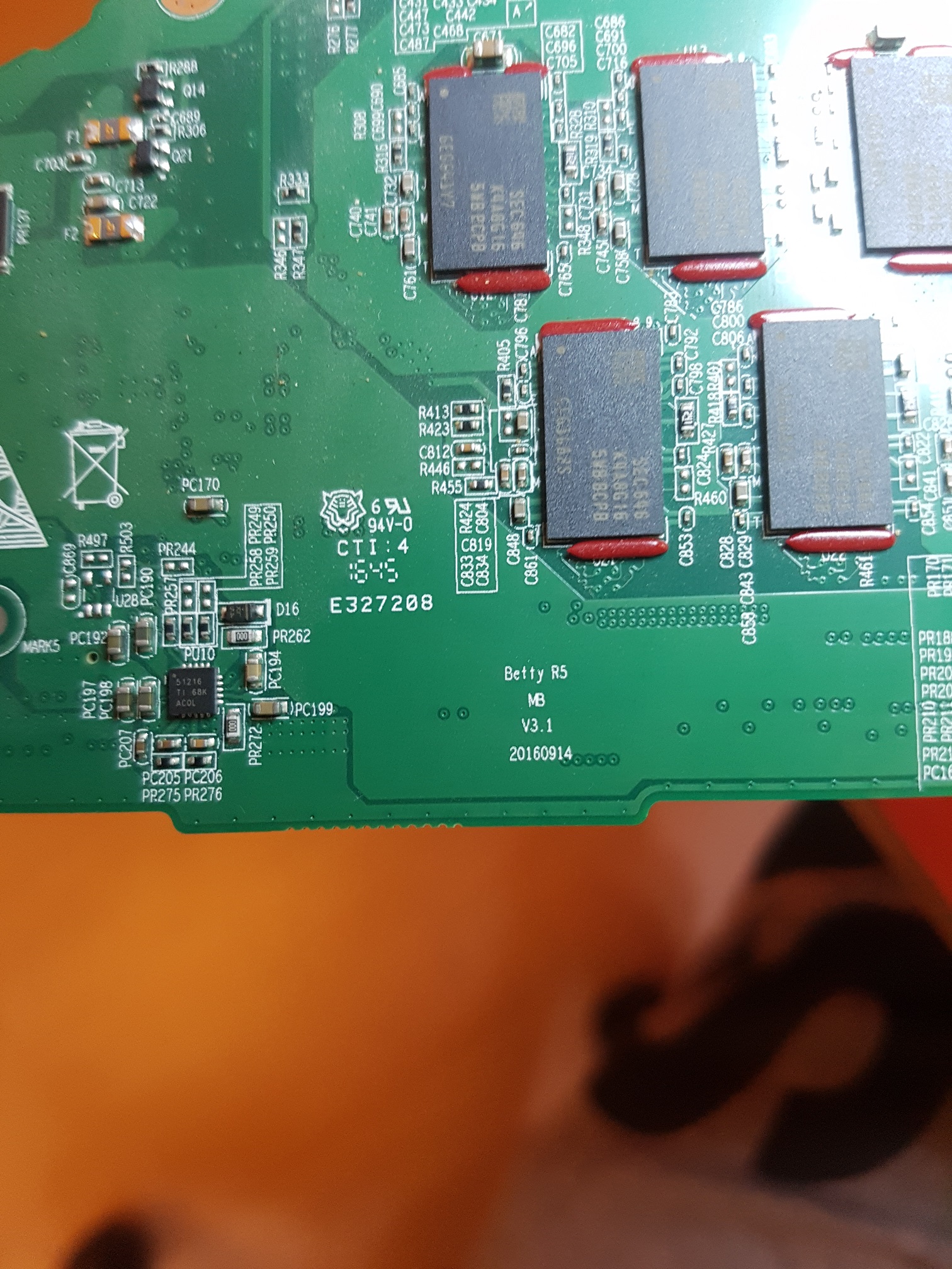

I have this Razer model RZ09-0195 motherboard Betty R5 V3.1
Laptop turns on, I can get to the bios, but I dont see serial number and after bios screen stays black with backlight on. No CPU activity no more.
Sometimes image goes black even when on BIOS.
Unable to boot to any USB media or SATA device. just stays with black screen
Can it be BIOS related?
I tried the BIOS you have on this thread for RZ09-0195 MX25L6406 BATTY R5 MB V3.0 OLD.BIN but with this file laptop does not turn on.
Motherboard has no water damage or any visible problem. Looks factory.

Not bios related for sure?
Why no serial in the BIOS screen?

no s/n i don't know why, i think i need to ask you about the laptop's origin or has someone fixed it before you.
Laptop motherboard is mint, never touched, no soldering ,nothing
Laptop was never serviced apparently.
What would you try on this case?
