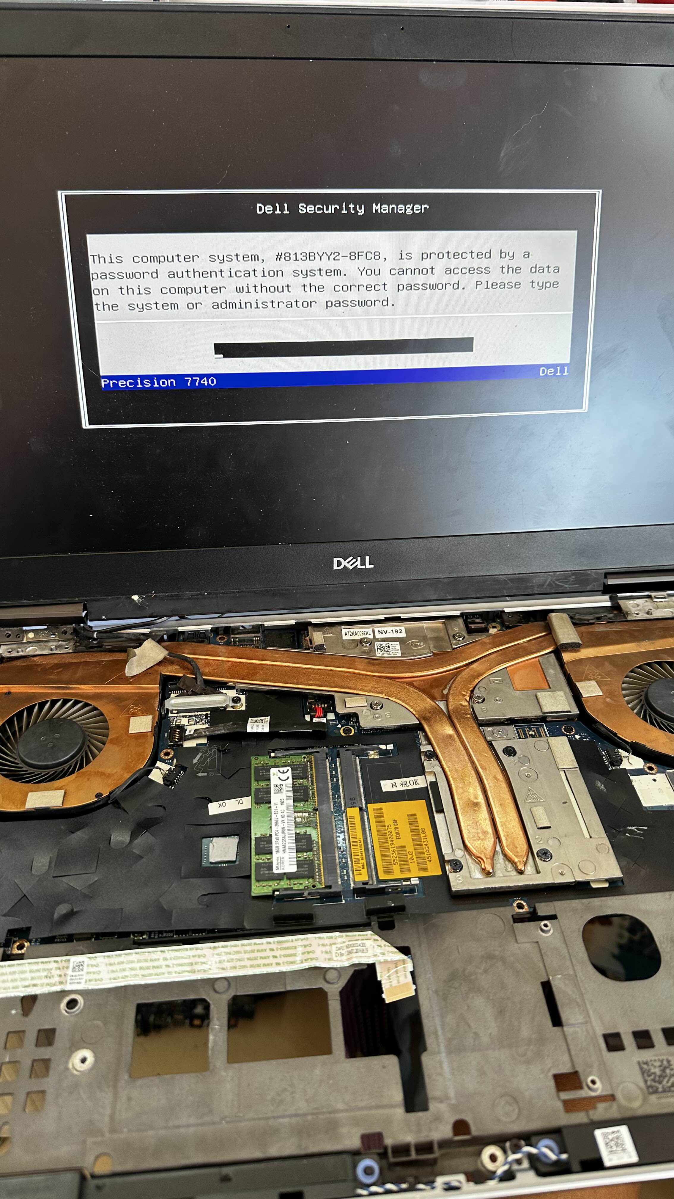

it starts but after restarting several times it turns off, after pressing the power button it starts for a while and turns off.
When changing the graphics card in this laptop, do I need to reprogram the appropriate bios to make this laptop work? I changed the card, the symptom is a bit different but still no image
Graphics card changed from N19E-Q5-A1 to N19E-Q3-A1
Not related to BIOS, including other BIOS programming, there is no BIOS as you want, I think the problem is only in the graphics card
the laptop worked for me on this bios, it started, it gave an image, but it doesn't want to work with all the ram memories connected. when I connect them separately it works, it even works when there are two connected, but when I connect more it stops giving an image. I think it's a bios issue, because I checked the ram and they are OK, the ram banks are also OK, because the laptop also works separately
