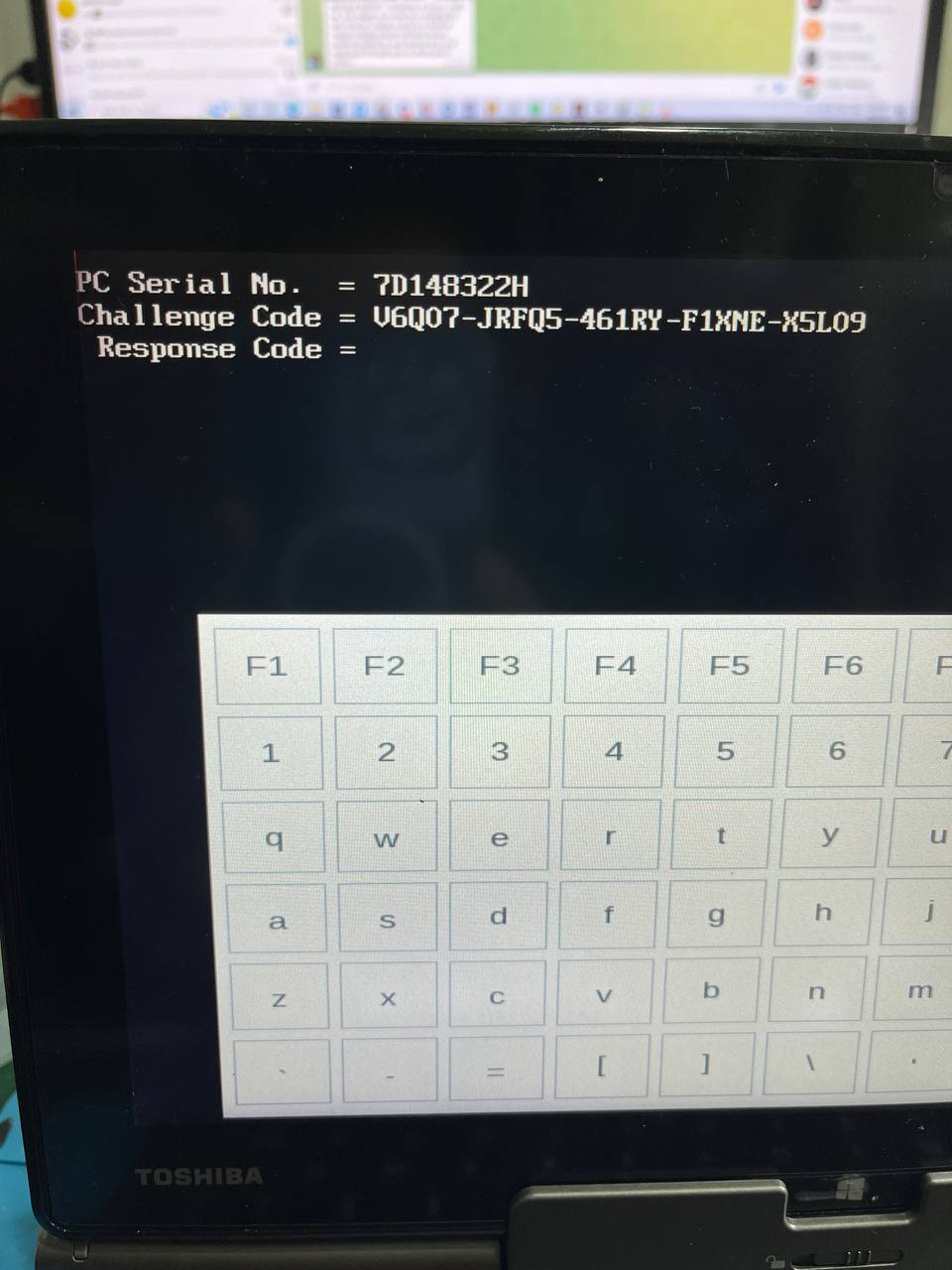

Dear All,
Kindly assist in get working bios dump for my portege z10t.
It have corrupted bios and few damages in the bios structure.
If someone can fix it & get serial transferred & clean me pls.
Currently my laptop doesn't post. CPU gets hot without FAN spin & keeps restarting.
i am attaching my corrupted bios and few screenshot.
System Identity Manufacturer: TOSHIBA
Product Name: PORTEGE Z10t-A
Version: PT141E
Intel core i7 -3689Y CPU @1.5Ghz
PT132V-00R017AR
Serial Number: 8D021945H
UUID: 60D20670-4927-11E3-8E56-F8A963493D17
Firmware Details
BIOS Version: 1.30 - Not sure?
Release Date: 06/13/2013
ME Firmware Version: 8.1.31.1351
ME SKU: 5MB (Corporate)
Flash Chip: Winbond W25Q64CV (8MB / 64Mbit)
W25Q64CV-ORIGINAL.rar
