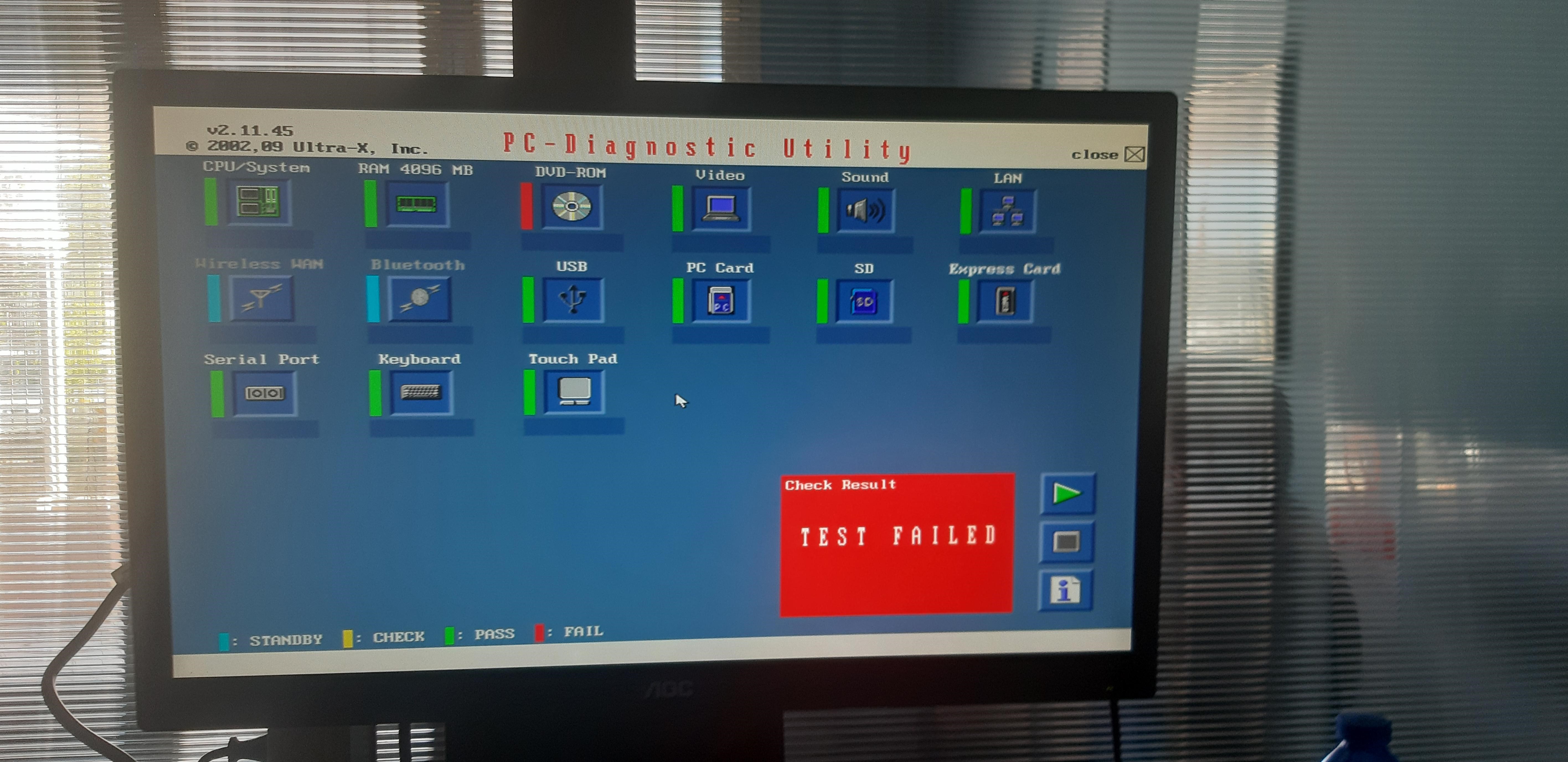

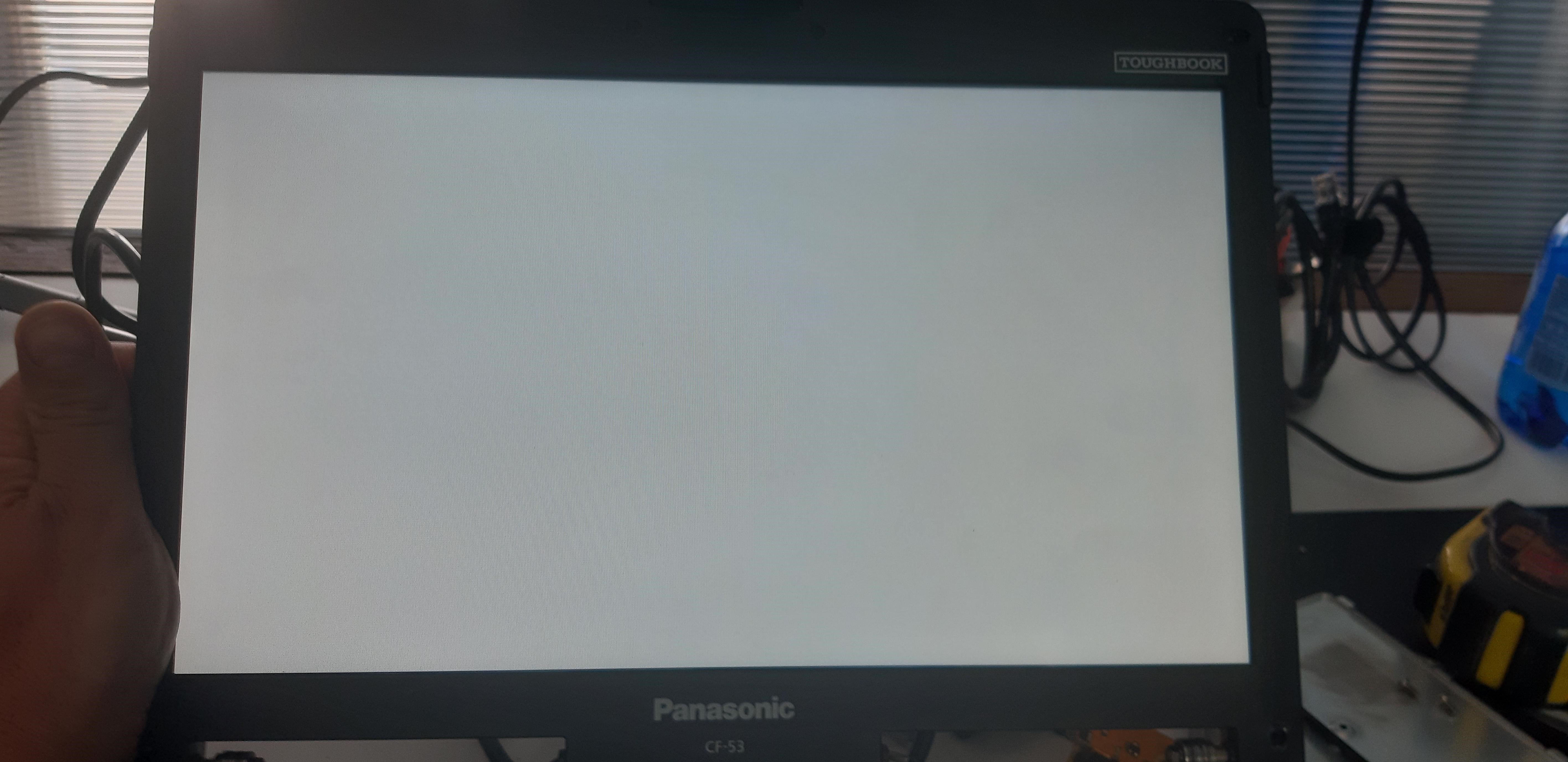

HI , after upgrade firmware on this machine I have get blank screen (white) . Graphic card work fine if liked to external monitor . I need a new dump file to write in eeprom. Also I have the orignal copy extract from bios chip . Can you help me ?
try BIOS on top
Ok this , original bios file. I have buy new coaxial cable lvds , try another panel led and try other ram stick . I have do a bios self check gpu is ok . In attach two screen shoot . In extarnal video all work
