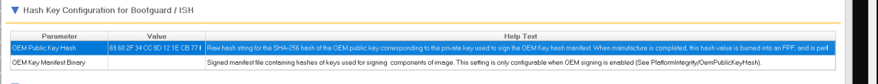

i program the first file of this topic but same problem, try computer turn on and after 10 sec. shutdown and see de orange light.
indicate the problem with SPI.
I try to clean it and not work.
Checking the file witch FIT utility see have public KEY OEM.
Can remove it or reprogram?.
Can repair de public key from new PCH?
I changed for another new PCH and same problem.
