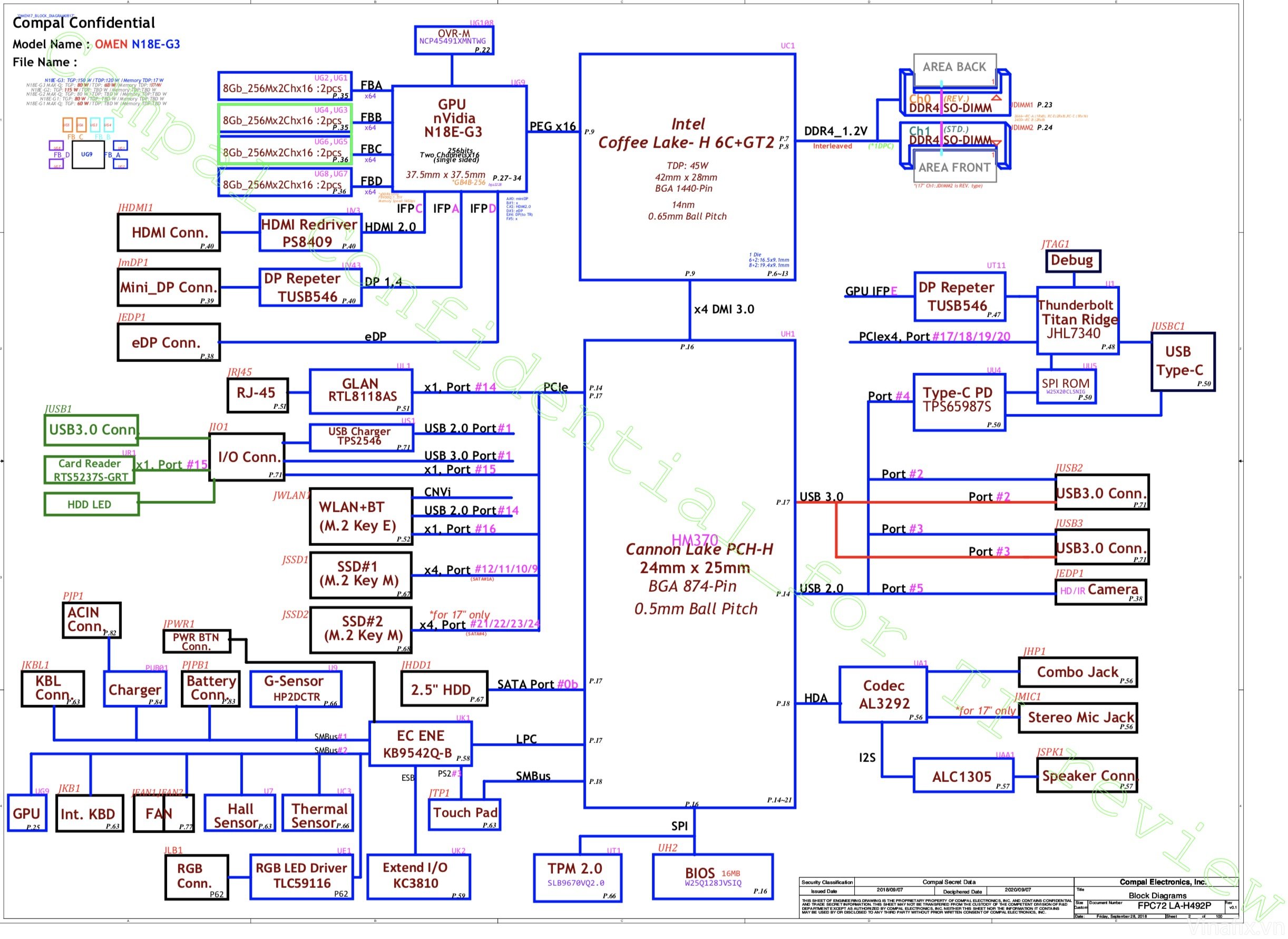

OMEN by HP 15-dh0008tx LA-H492P LA-H481P
OMEN by HP 15-dh0008tx LA-H492P Schematics
Intel MB Schematic Document
2019 OMEN 17.3" Santorini
FPC72 LA-H492P R01
Date : 2018/09/28
Version: v0.1
Coffee Lake- H
BIOS 08600
LA-H492P v0.1.pdf
08600.bin
is 15 inch and 17 inch use same bios because i tried bios that you uploaded laptop can turn on caps and num is working but no display i tried external monitor also but same if both models dont use same bios please share for 17inch model
