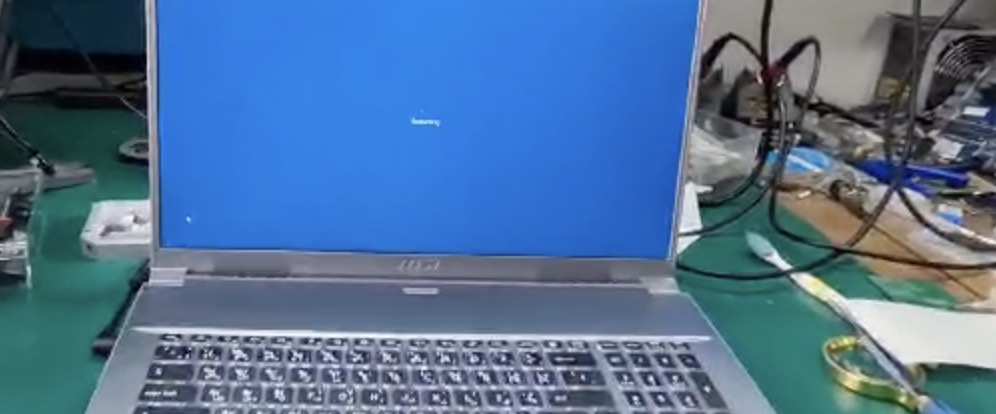

BIOS MSI GF75 THIN 9SE MS-17F31
OLD BIOS IS WORKING FINE , BUT I REPLACED PCH.
STILL DELAY AND SOME TIMES NEED RESTART TO BOOT , CAN U HELP WITH REBULID AND CLEAR PLEASE
If after replacing the PCH there is only one delay display error then it is a bios problem. In addition, all other errors cannot be fixed from the bios.
YES CORRECT ONLY DELAY , BUT THE BIOS YOU CLEAR SOME TIMES NOT BOOT AT ALL AND WHEN I RESTART LAPTOP IT RESTARTS SEVERAL TIMES BEFORE BOOT AND DELAY STILL NOT FIXED
I RE-FLASHED OLD BIOS WORKING FINE ONLY 30 SEC DELAY !
CAN YOU CLEAR AGAIN PLEASE :)
That could also be a problem due to clearme which is why I said clearme doesn't always work well
return old and make one video I check
