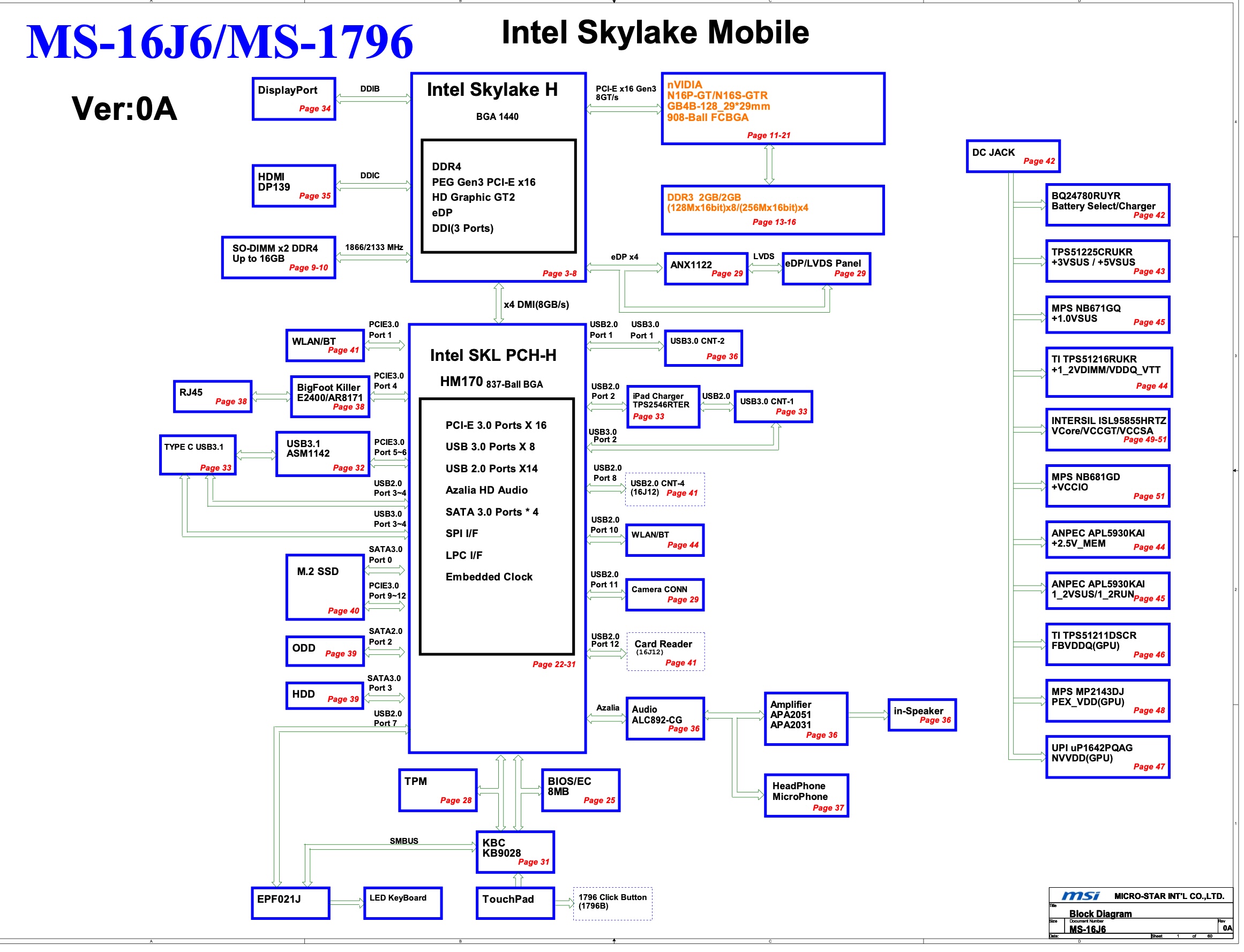

dedicated graphic problems, try reballing but same.
It's possible disable dedicated graphic by bios?
