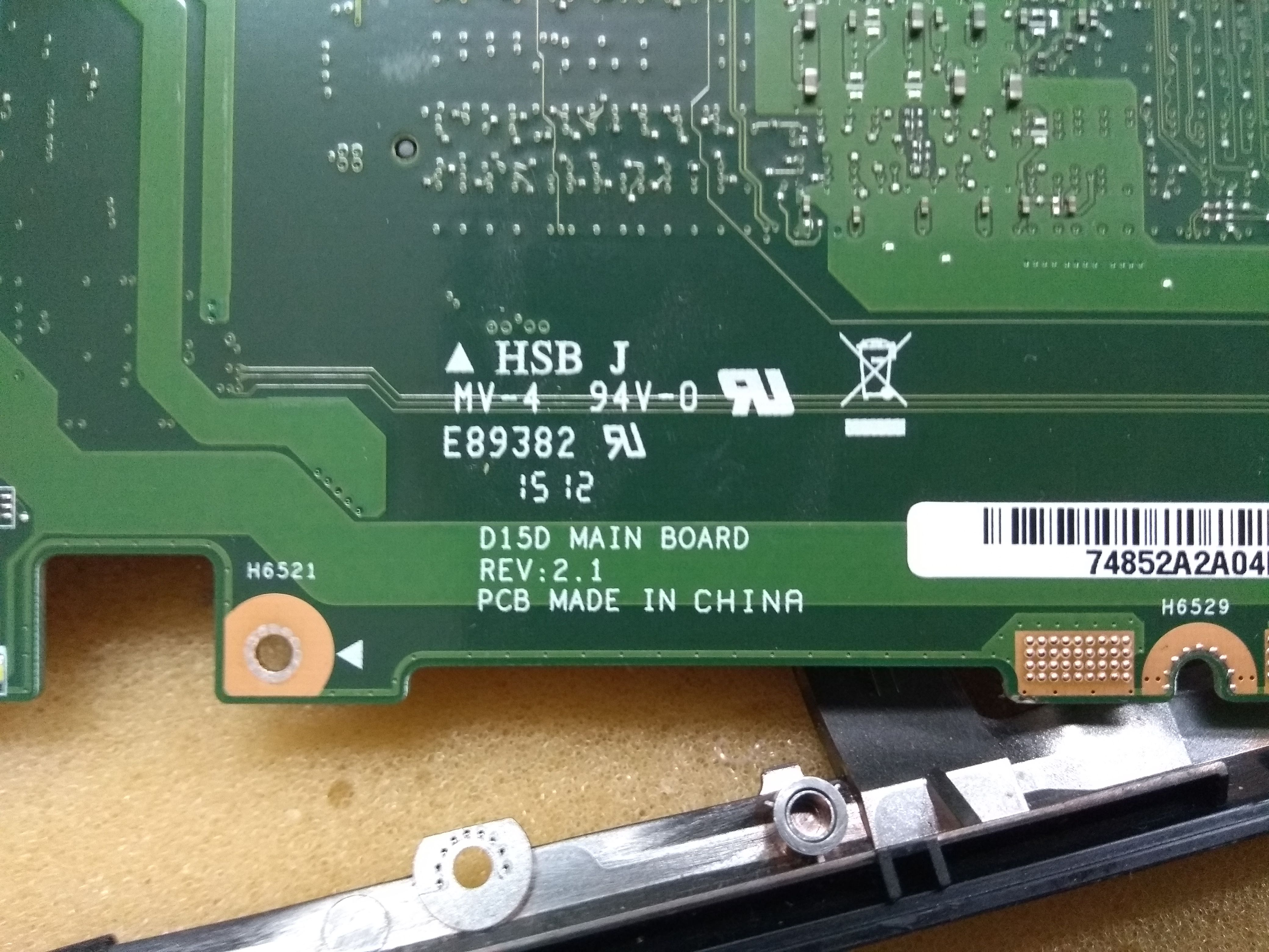

MEDION akoya E6418 MD99620 Pegatron D15D REV 2.1
Have a nice day..

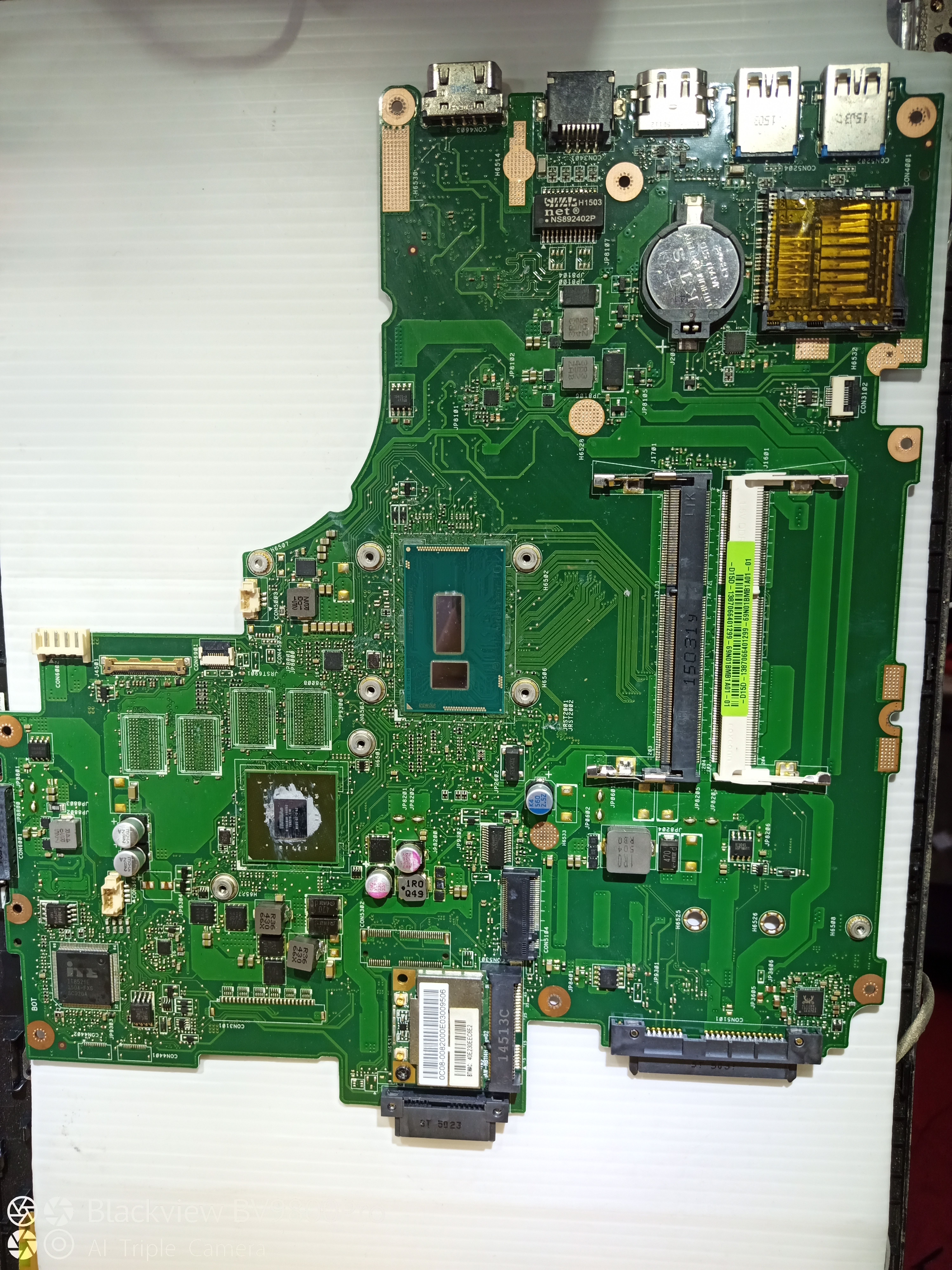

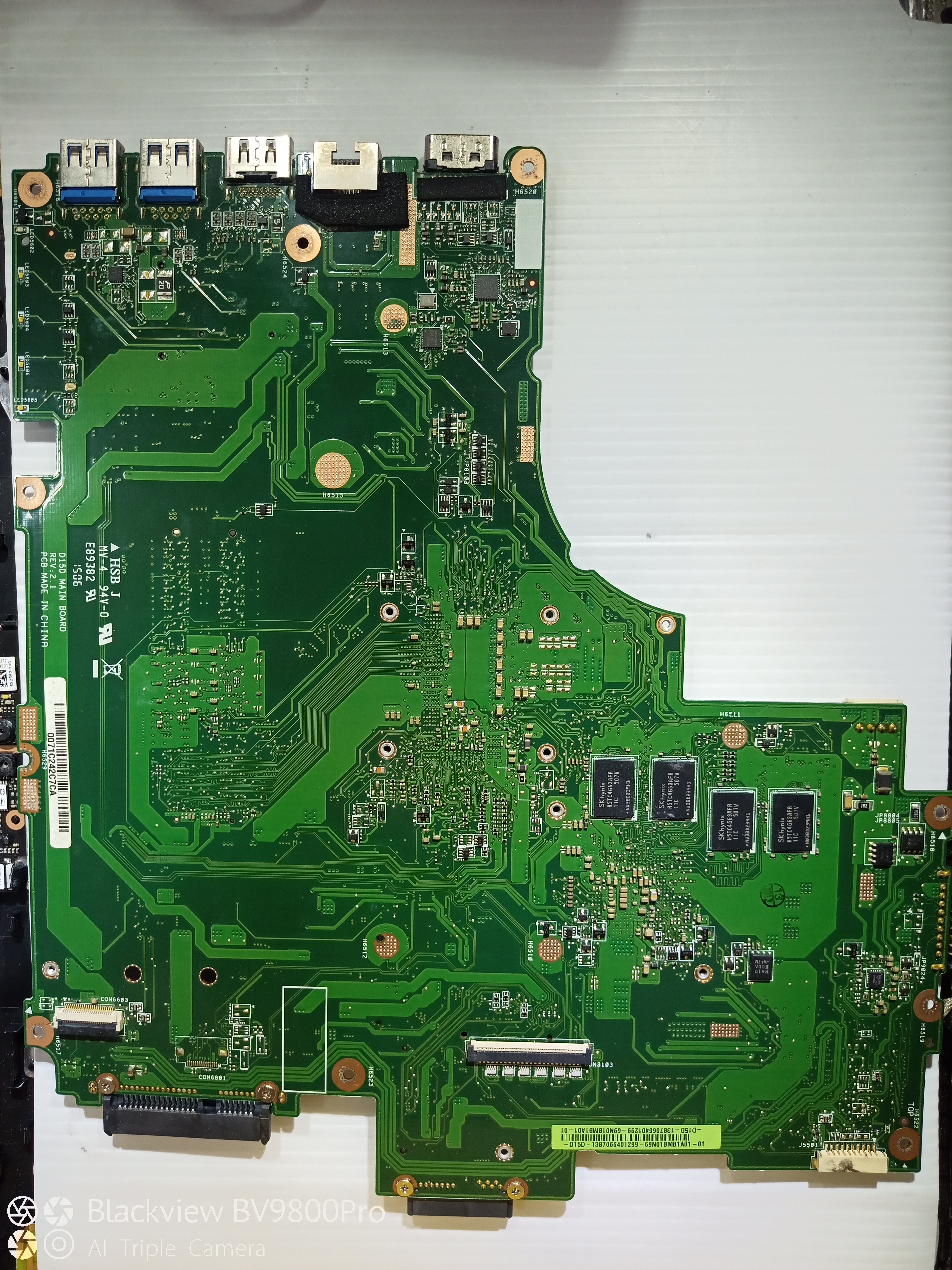

I've an issue on Casper D15D (C500 disc) D15D MAIN BOARD REV:2.1
PC boots up to the bios shows Intel ME FW: N/A
On uefi boot win10 it resets right after loading flash to ram on system.
On legacy boot it shows bluescreen ACPI BIOS ERROR then resets.
Different boot environmet tryed result is same
No liquid damage or something.
RAM tryed
Ethernet, audio codec, card reader ic removed tryed
Differet bioses tryed (yours also) Intel me/txe injector tryed
firmware analysis shows ok
What problem causing that?
