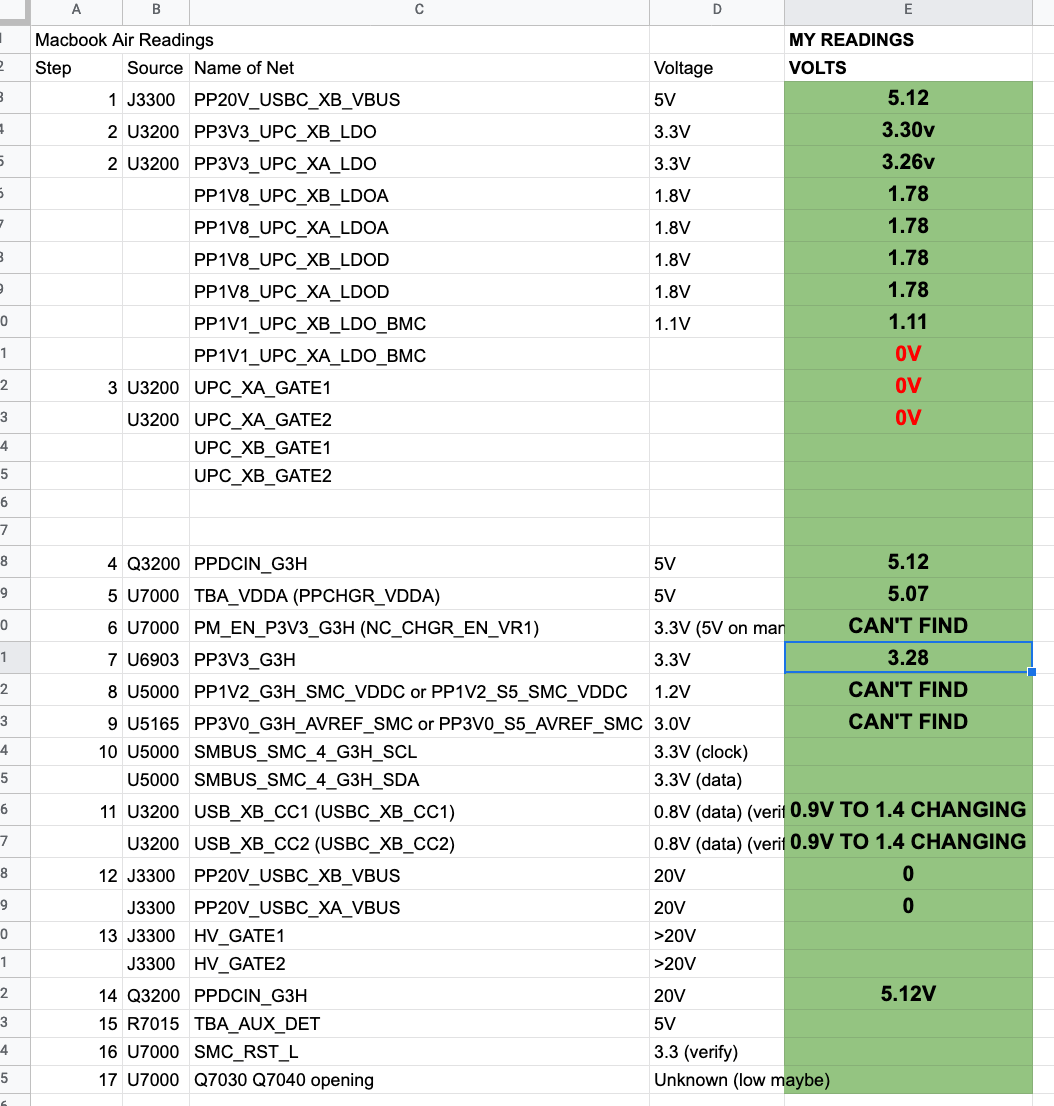

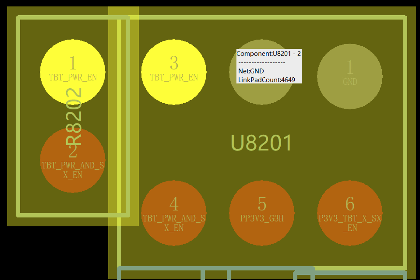

MODEL: MacBook Air 2018 A1932 820-01521

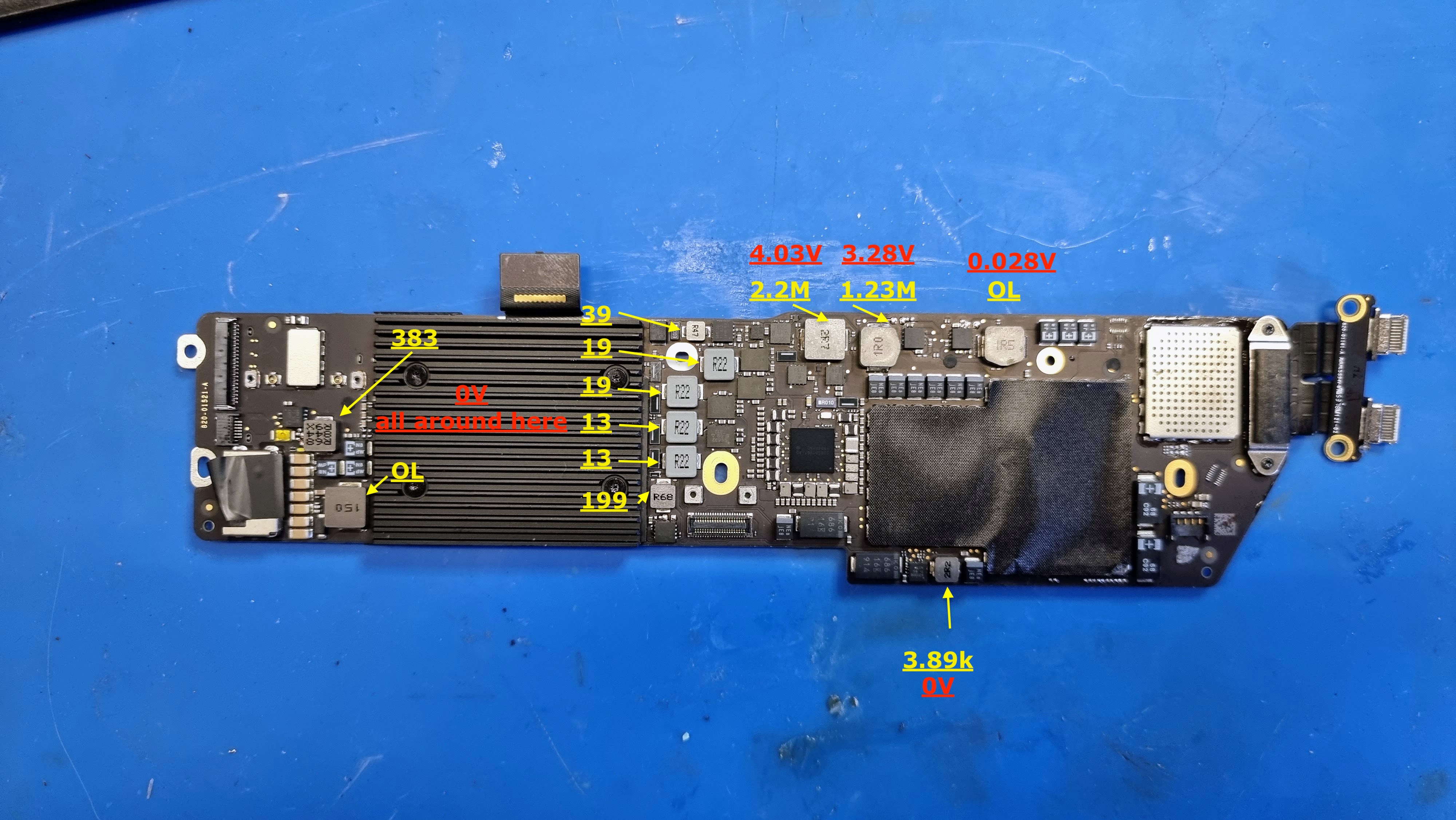

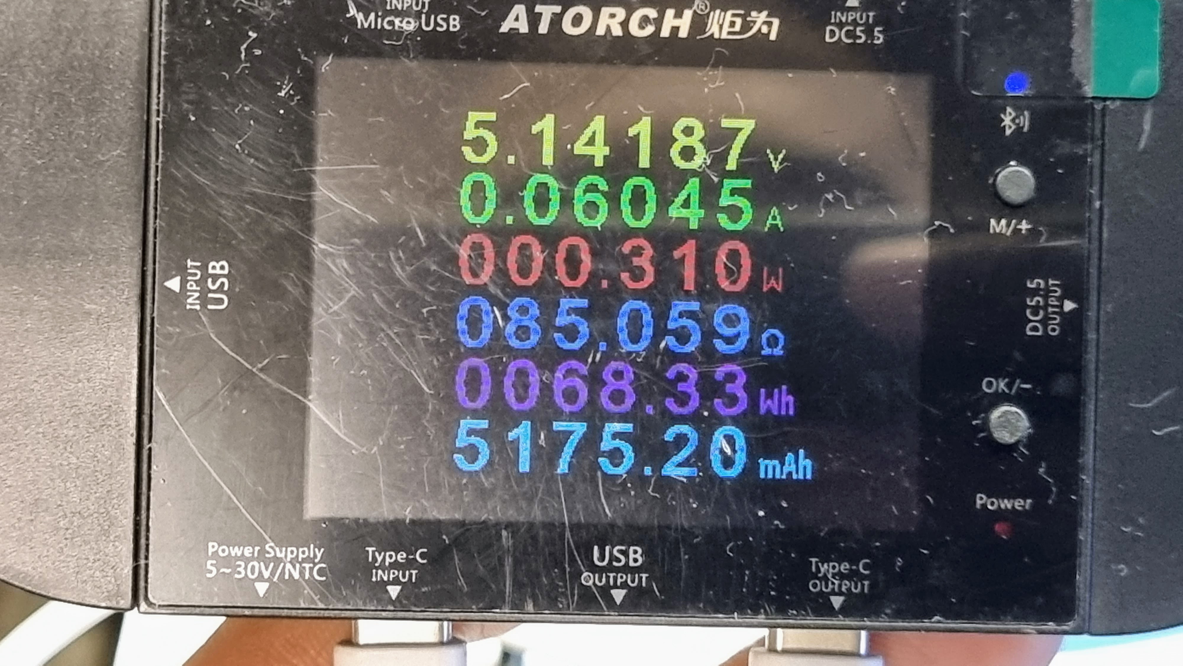

Problem: 5.12V / 0.60Amps

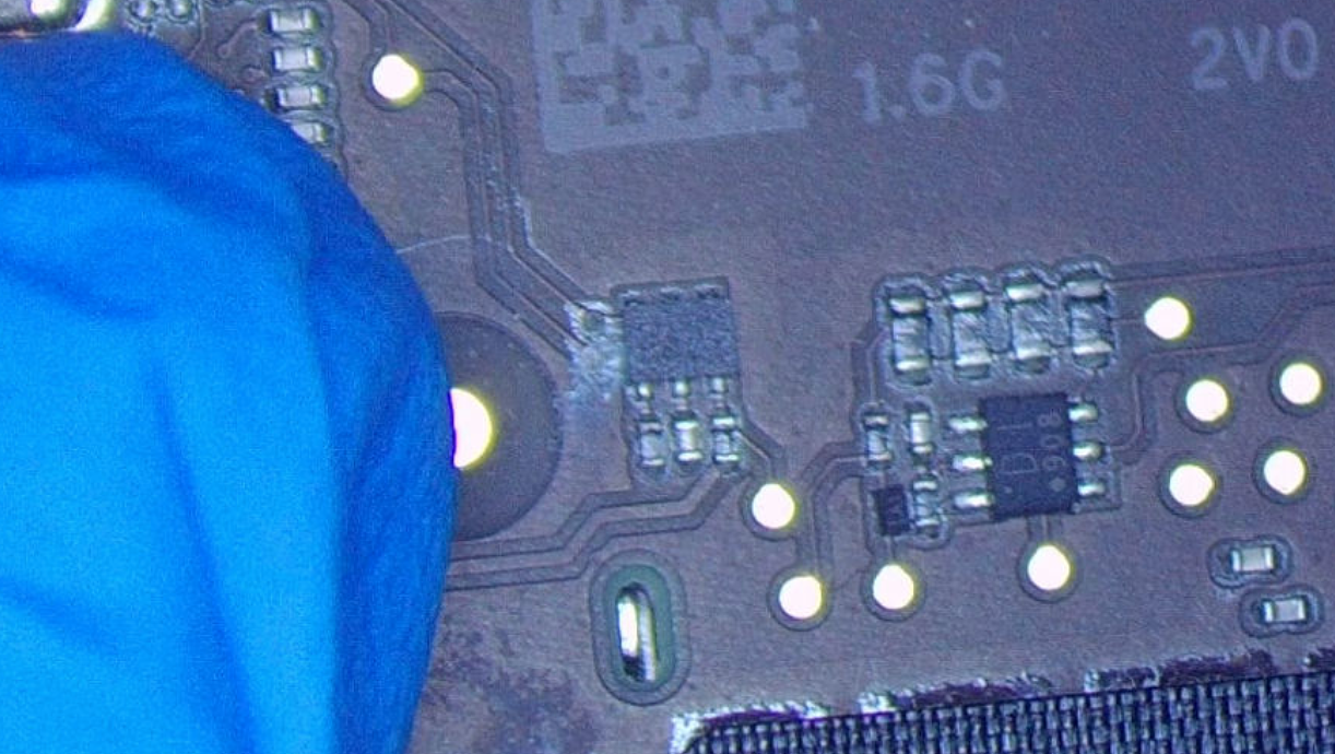

History: Unknown but I can see slight liquid spill on IC U8201/74aup1t97gm

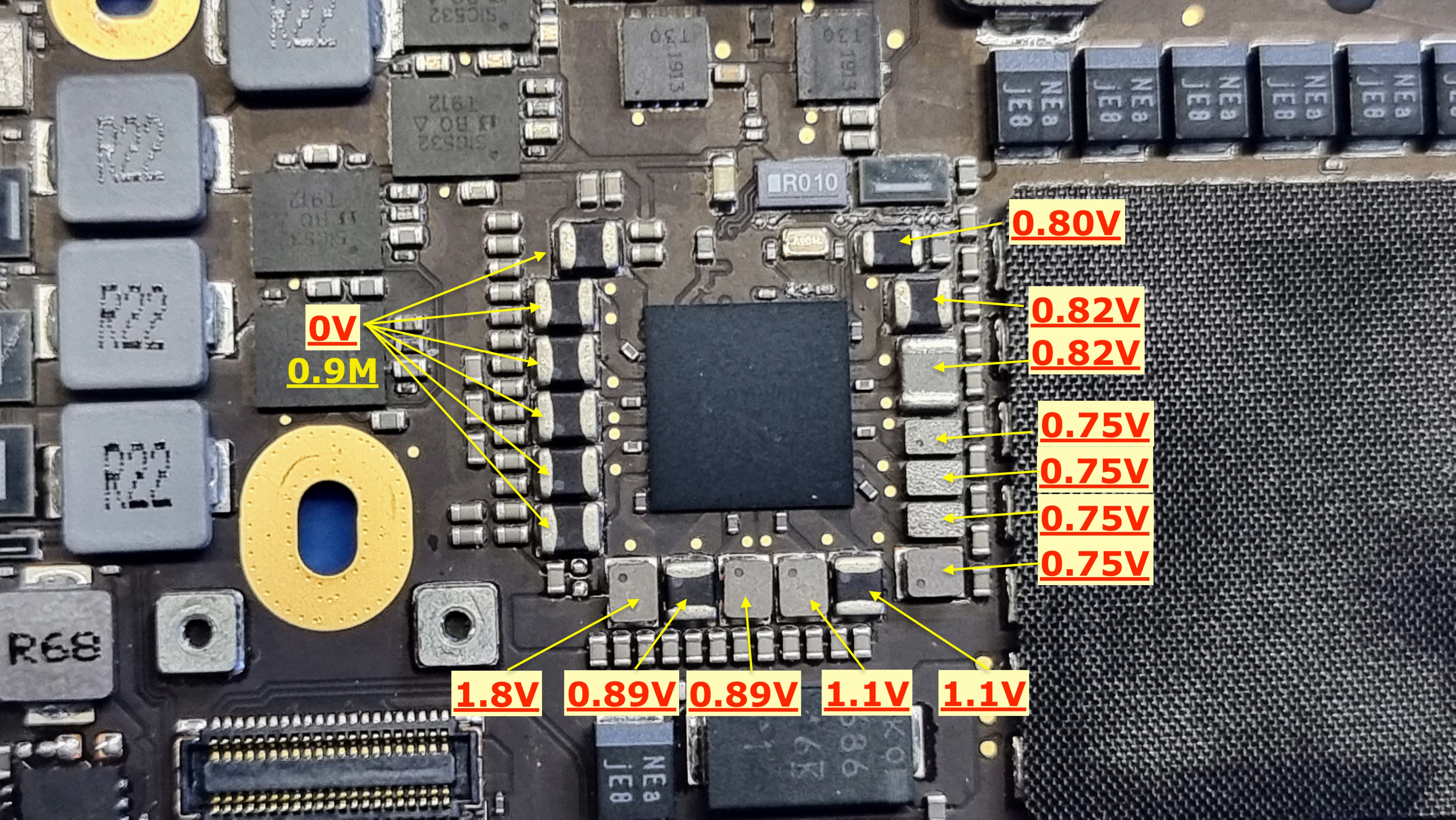

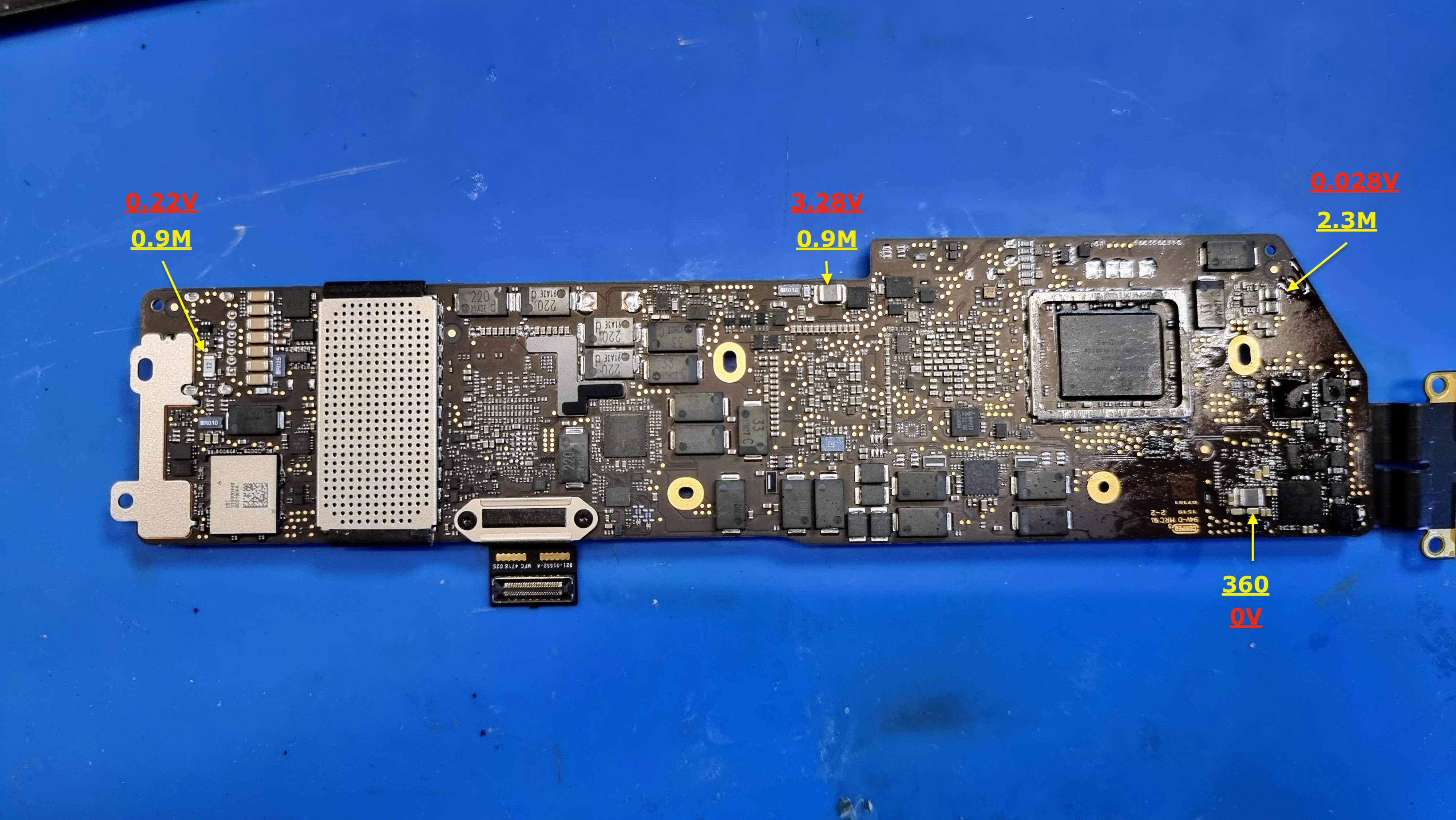

Things tried: I've cleaned the liquid area, removed the IC U8201/check pads, good/ chip looks good, put back. Replaced CD3215C x 2 times, so 4 new chips just in case. I've attached photo readings of V/resistance and signals as per logi wiki website. Please advise what I can check next. Schematics available upon request.
AmpMeter.jpg 20220805_144423 copy.jpg 20220805_144435 copy.jpg original_a50e6855-be86-4071-abec-fd731fc5bb27_20220805_165014 copy.jpg LIQUID MARK U8201 BV.png Signal CHIP READINGS.png LIQUID MARK U8201.png
