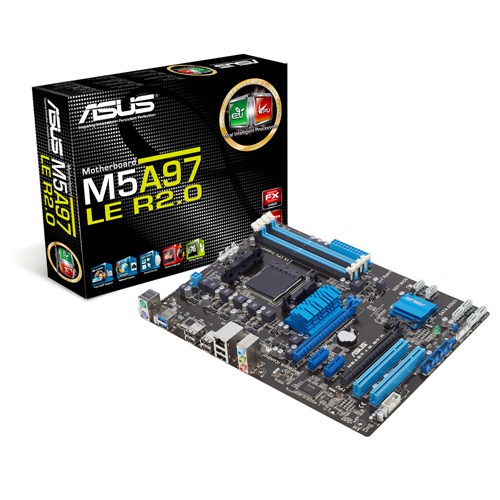

Asus M5A97 LE R2.0
M5A97 LE R2.0
M5A97-LE-R20-ASUS-2601
ASUS Dual Intelligent Processors, Extreme USB 3.0 Transfer Speed, and Windows 8 on AMD 970
  • Dual Intelligent Processors - TPU + EPU
  • USB 3.0 Boost - Faster USB 3.0 Transmission with UASP
  • Network iControl - Real-time Network Bandwidth Control
  • UEFI BIOS - Flexible & Easy BIOS Interface
  • Auto Tuning - Auto System Level Up
  • Quad-GPU CrossFireX Support!
  • True USB 3.0 & SATA 6Gb/s Support - Fully Unleash Performance
