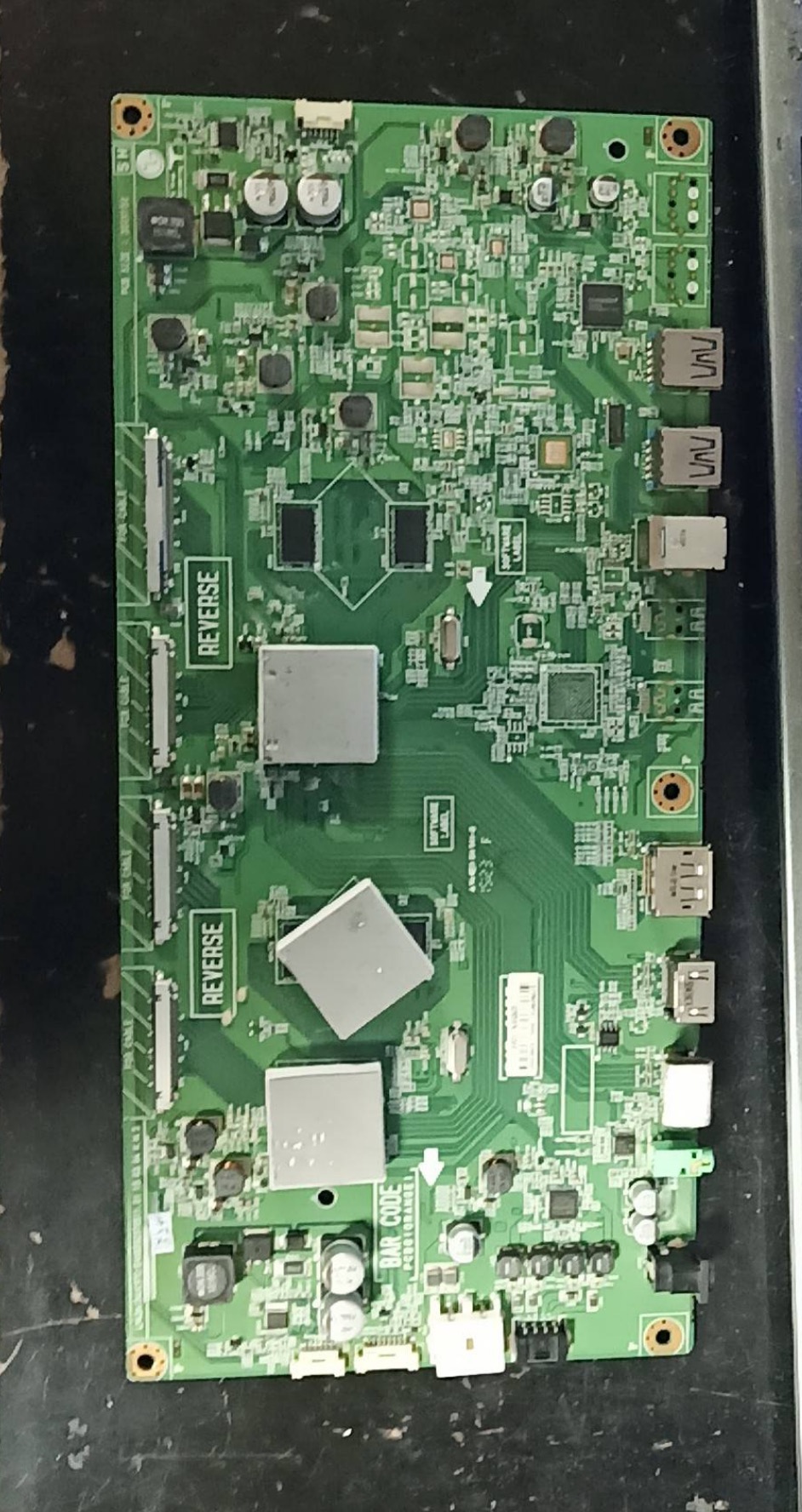

Hello, does this dump include the both dumps = 25X40CL & MX25L8006E or just single BIN.
LG 34UC97C board I'm working seems to have power but no response to power button.
I'm assuming if could be firmware, 25X40CL has massive blocks of FF in BIN, is this normal.

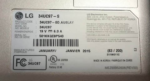

I flashed the LG34uc97-S BIN file on the LG34uc97-S monitor and it does not work, is dead. Then I flashed the LG 34uc97c BIN file on it , and it came to life. However I don't know if all the features (thunderbolt etc) work...
old bios BIOS error what ?
now it's working if use your bios LG 34uc97c.BIN.zip on first post
but my LG model 34UC97-SD
it's should be ok that right ?
