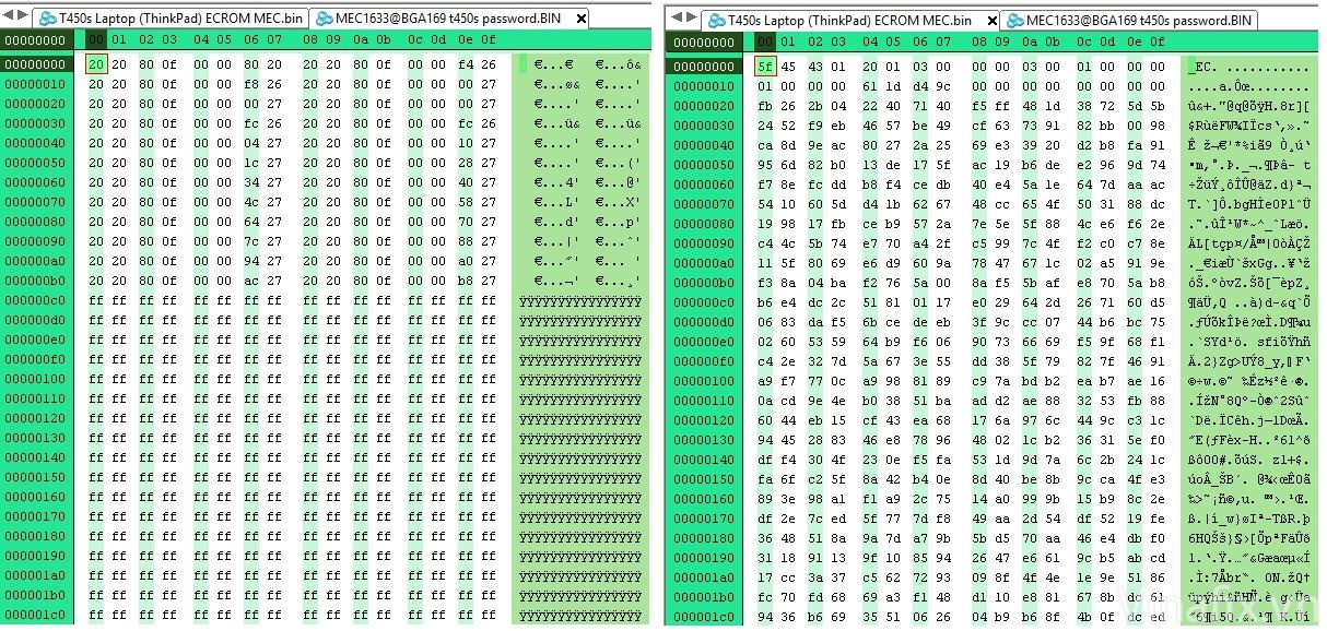

máy của e là T450 NM A 251 bị pass bios, nạp file này ko lên hình, các file trong này đều ko lên, chỉ có file clear me là lên nhưng vẫn có pass, tìm ko thấy rom nhỏ nào cả, ai có file gốc cho e xin với

Pass trong con i/o thì phải bạn,
look this file is from innounp .. i know that .. this its code in not matched with smsc reading ... i added some codes from original copy to lenovo EC file .. but there are many location in HEX which are different .. so it is not working this way .. i need and original read from smsc

Nó có mã khác với tập tin gốc ...

could you tell how are you reading the mec1633 i tried in t440 and i failed many times , i soldered a wires on the jtag connector "tdi,tdo,tms,gnd,clk afterthat i placed a resistor on jtag_rst because it was empty, but i couldn't read it, i succeded with x240 but t440,T450 nothing
on JTAG_RST you dont need to put resister .. it is A10 ball .. even you can check continuity with a needle .. and it is always connected to a capacitor ... just follow the pins and connect rst ... it will read .. :) by the way i appreciate your effort
