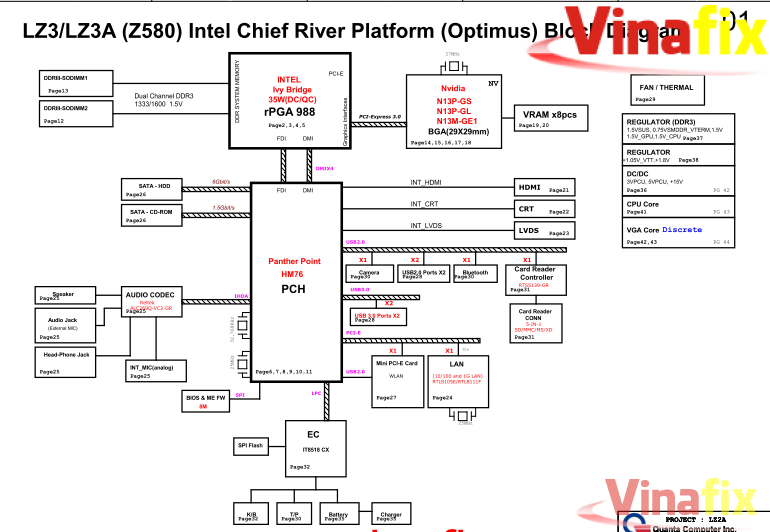

Hello. Boardview avaliable? Someone converted to UMA, need to make it discrete again PL3 and one other part is missing but the number is not there. Need to change the chip on board
dalz3amb8e0 anyone tested the DIS bios and EC? I tried to flash it but no video on output. When i turn on UMA it works. So i replaced BGA chip (N13P-GL-A1) and reverted all UMA changes. Now no video on output again. Any ideas?
