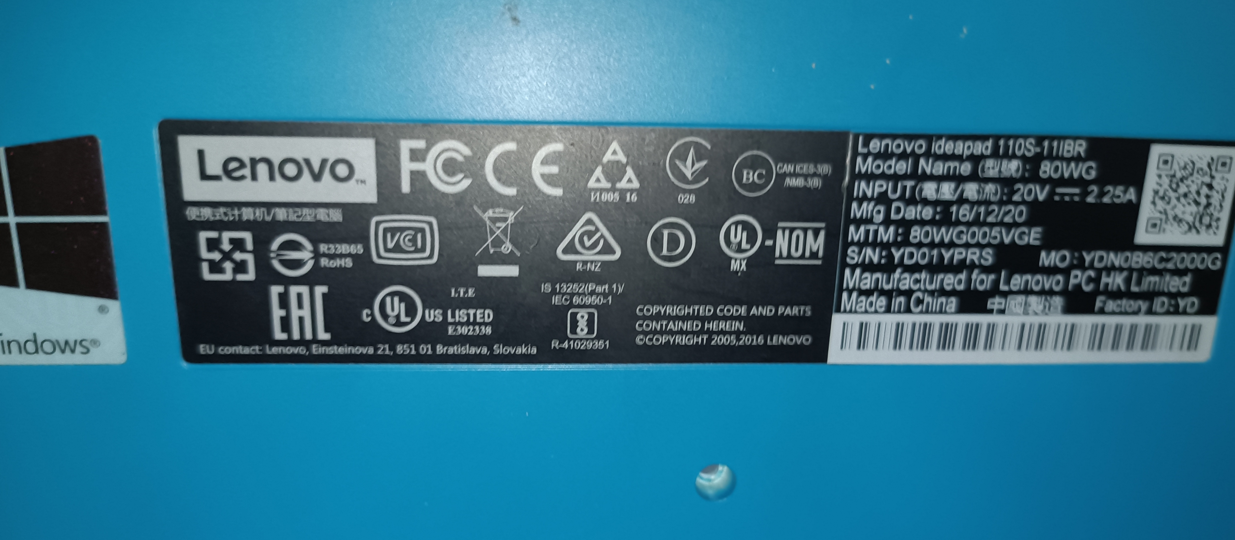

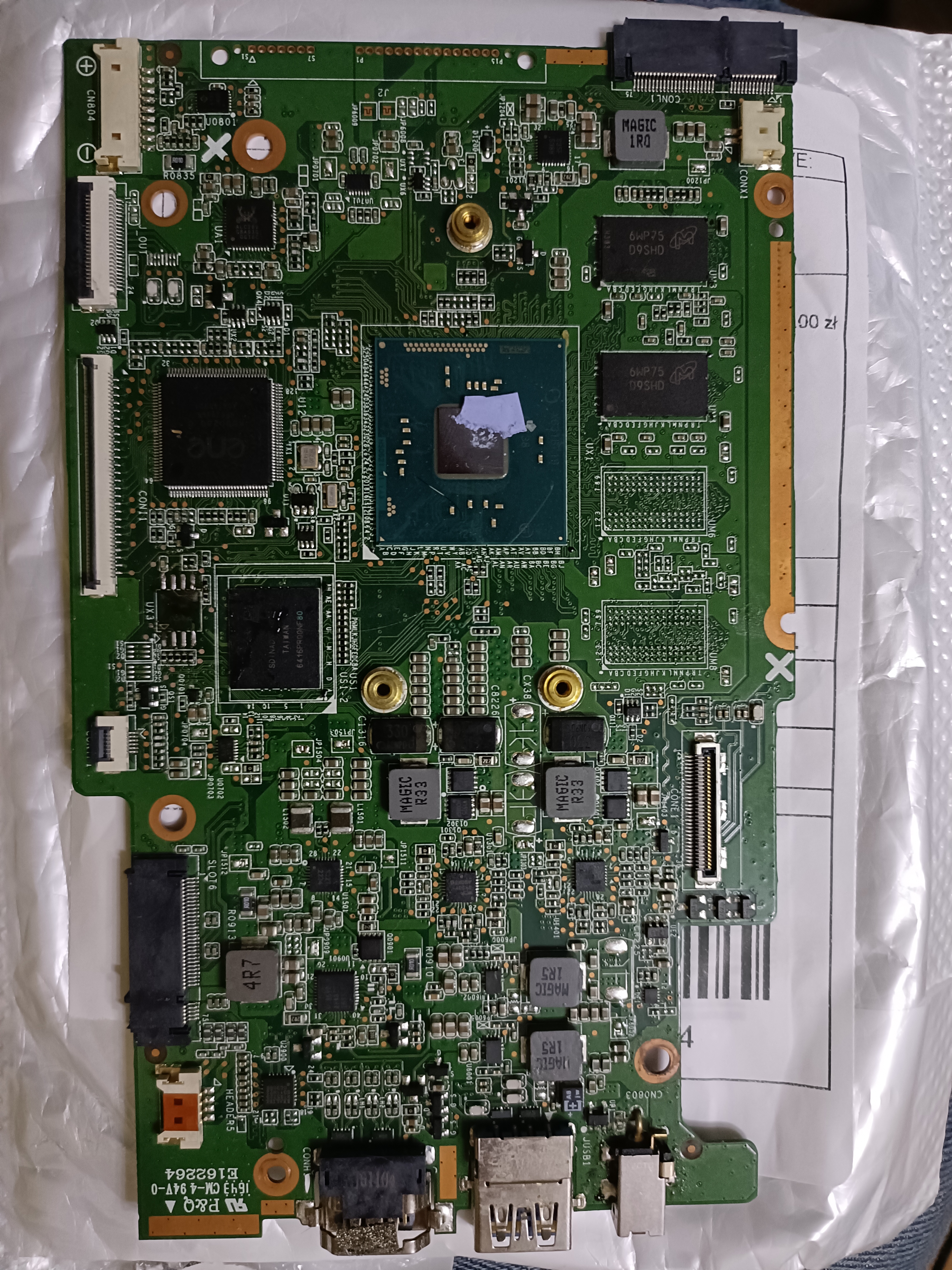

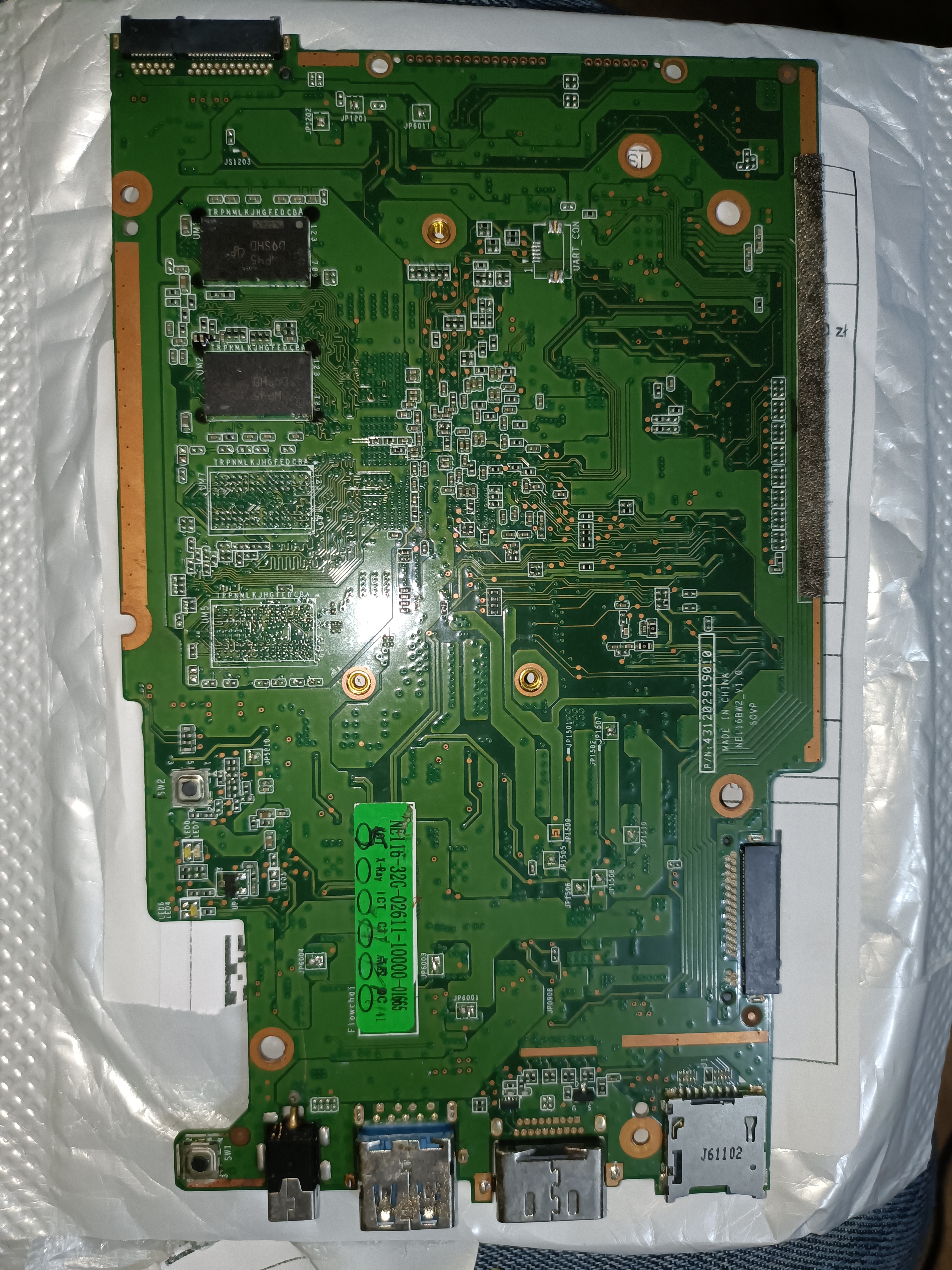

Please help. I tried many BIOS files from this forum, without any result. There was only worse, laptop ask for password on the first screen or it doesn't start at all.
P/N 431202919010
There is BIOS password, I can't upgrade SSD.

I figured out I used 3.3V version of W25Q64, so it can't work with this laptop.
When I replaced Flash chip to W25Q64FW (1.8 V), file 8.bin works fine, there isn't any password. Thank you, @ThienBui for your help.
