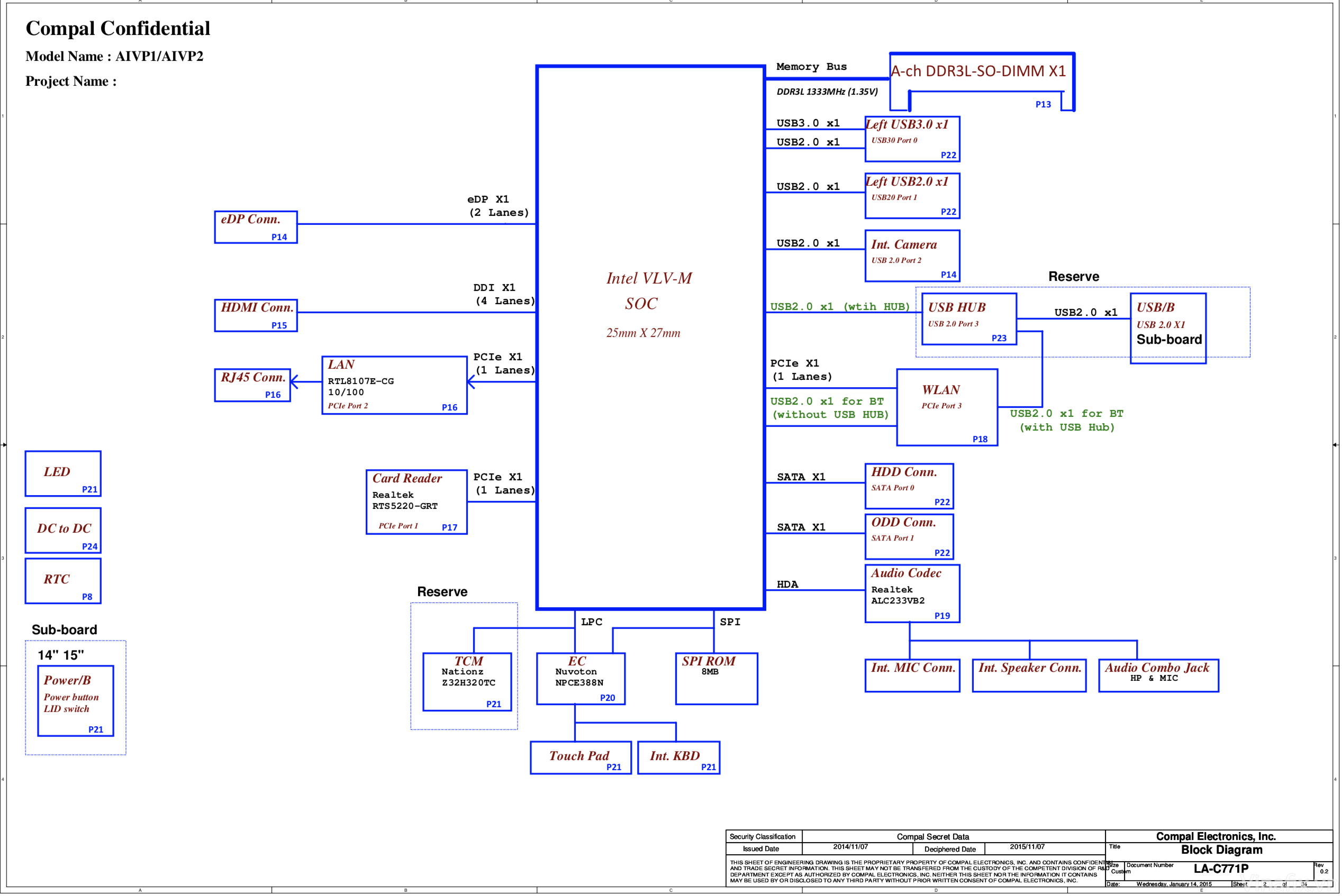

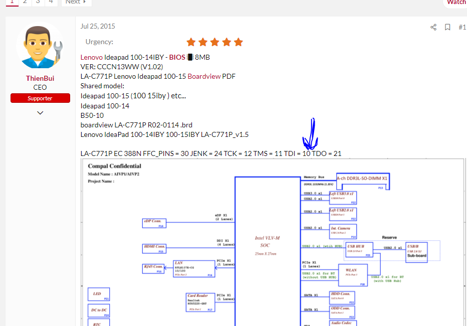

LA-C771P EC 388N FFC_PINS = 30 JENK = 24 TCK = 12 TMS = 11 TDI = 10 TDO = 21
Lenovo Ideapad 100 - LA-C771P photo
Schematic Compal LA-C771P AIVP1-AIVP2_r02_20150115

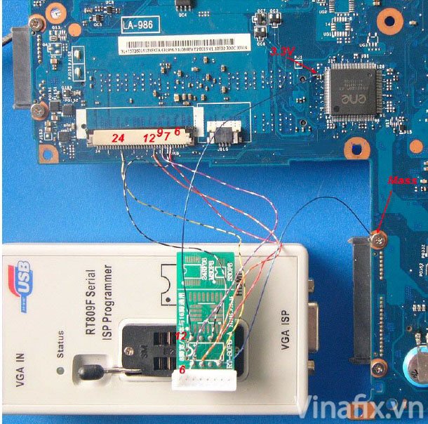

QUESTION THIS Configuration IS IT Valable For RT809H PROGRAMMER !
Hello, my question ,, can i programme npce388 with out desoldring and using the jtag with the configuration pin that you menttioned LA-C771P EC 388N FFC_PINS = 30 JENK = 24 TCK = 12 TMS = 11 TDI = 10 TDO = 21
I have only rt809h
Hello, my question ,, can i programme npce388 with out desoldring and using the jtag with the configuration pin that you menttioned LA-C771P EC 388N FFC_PINS = 30 JENK = 24 TCK = 12 TMS = 11 TDI = 10 TDO = 21,, like the the setep pin of kb9012
I have only rt809h
I have only rt809h
you need try
