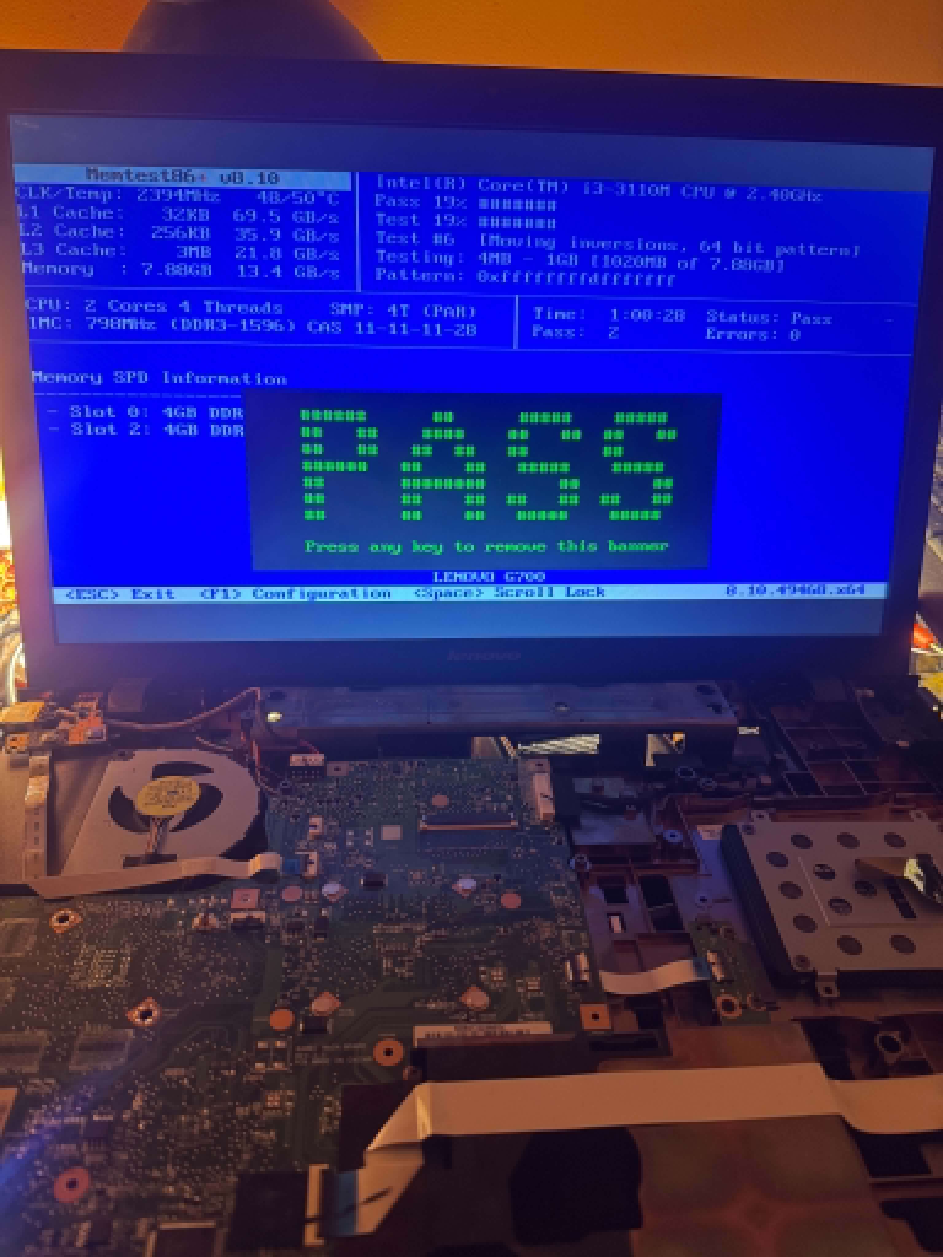

  • Tested CPUs:
    • Pentium – works correctly
    • Core i3 / Core i5 – system resets after approximately 30 minutes

  1. Full backup of both SPI flash chips was created.
  2. Original Intel ME 8.1.2.1318 region was replaced with:
    • Intel ME 7.0.4.1197
    • 1.5 MB
    • PRD RGN
  3. A new BIOS image was built using Intel FIT 8.x.
  4. The resulting image was verified with ME Analyzer:
    • Intel ME 7.0.4.1197 detected successfully.
  5. The modified image was processed with me_cleaner:
py me_cleaner.py -S mecust.bin
  1. me_cleaner:
    • removed most Intel ME modules,
    • preserved the required BUP module,
    • set the AltMeDisable (HAP) bit,
    • kept the FTPR RSA signature valid.
Result​
After flashing the modified image, the laptop successfully booted and started running MemTest.
Long-term testing is in progress to determine whether the modification eliminates the approximately 30-minute reset behavior when using Intel Core processors.
