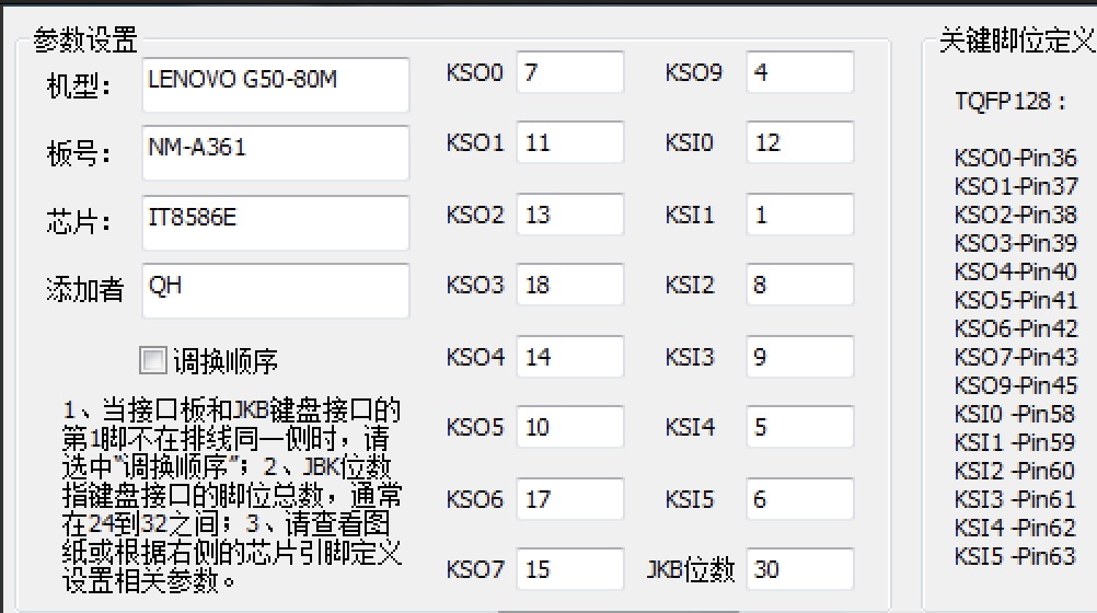

I have the board ACLU1/ACLU2 UMA NM-A272 Rev:1.0 with lenovo IT8586E and in coil LE2 & LE1 I measure short. I think the chip is off.
Can anyone help me how to program it again? I mean where is the pins for programming and witch programmer I need. I already have TL866a
