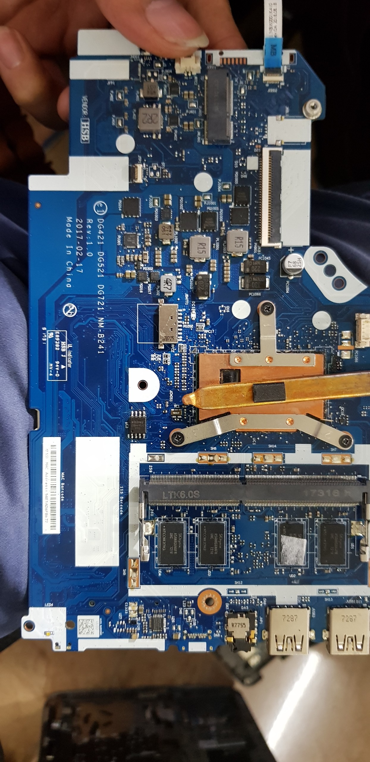

Lenovo 80XH NM-B241
NM-B241 org OK
Lenovo 80XH NM-B241
BIOS, ECROM
Schematics, boardview NM-B241 R10.tvw

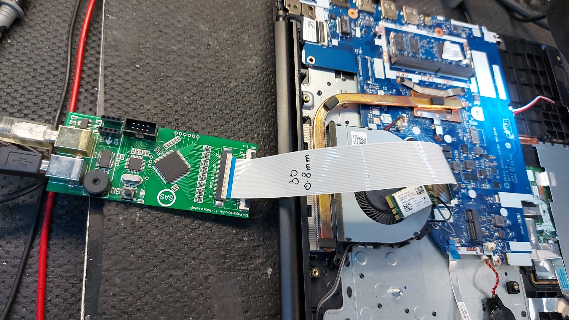

NM-B241 KB_pins=32 (JKB1) LEFT DOWN 08MM PD0=20 PD1=16 PD2=14 PD3=9 PD4=13 PD5=17 PD6=10 PD7=12 BUSY=23 STB=15 AFD=26 INIT=19 SLIN=18 KSI4=22 KSI5=21

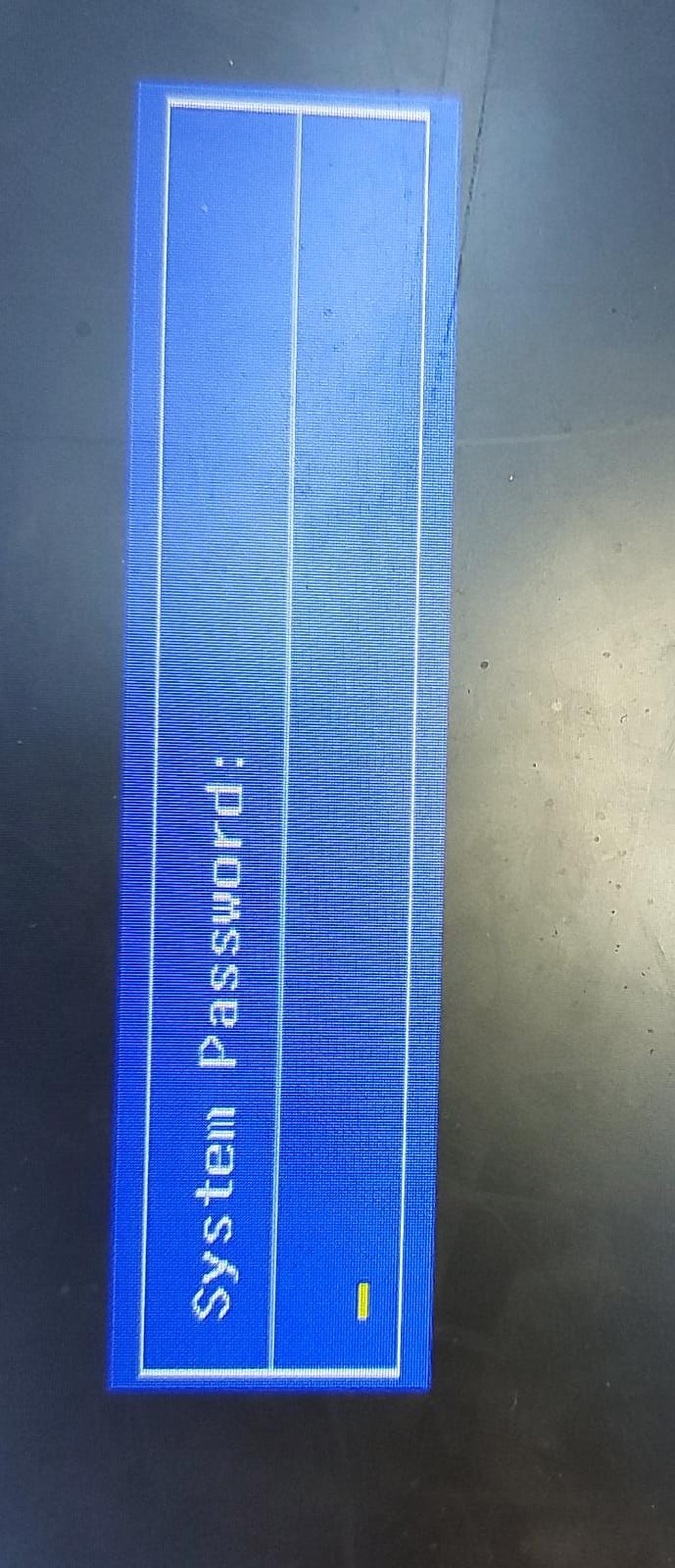

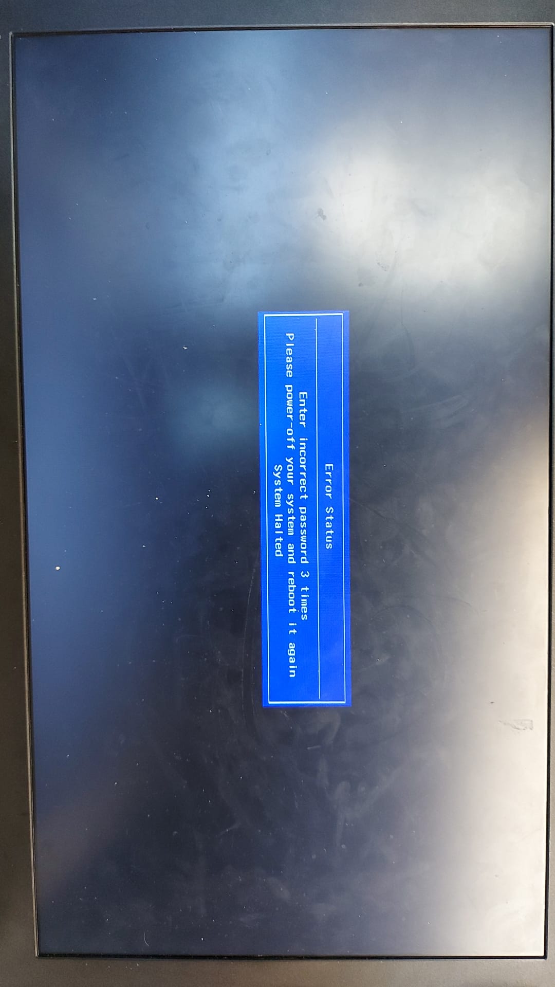

plz How can I delete this password?
DG421 DG521 DG 721 NM-B241 REV 1.0

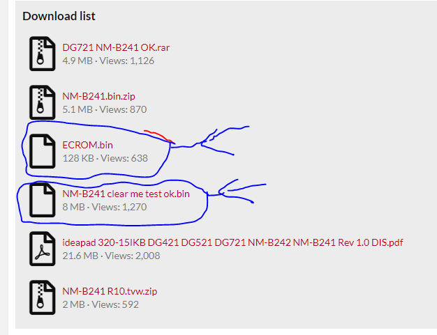

try gile clear me ok this
or you need Programming ECROM

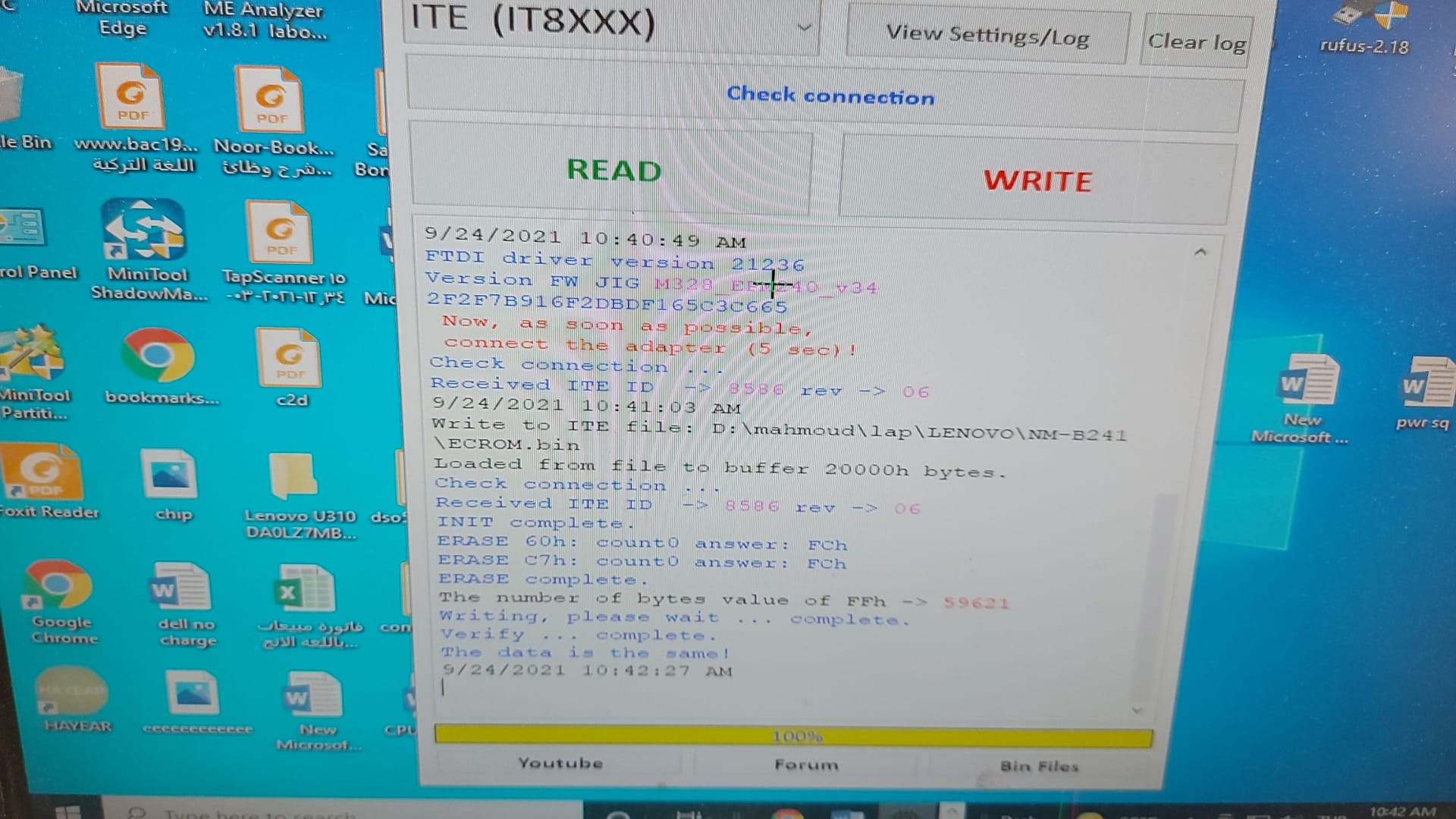

plz I do bios and the programming ecrom but the password is still there

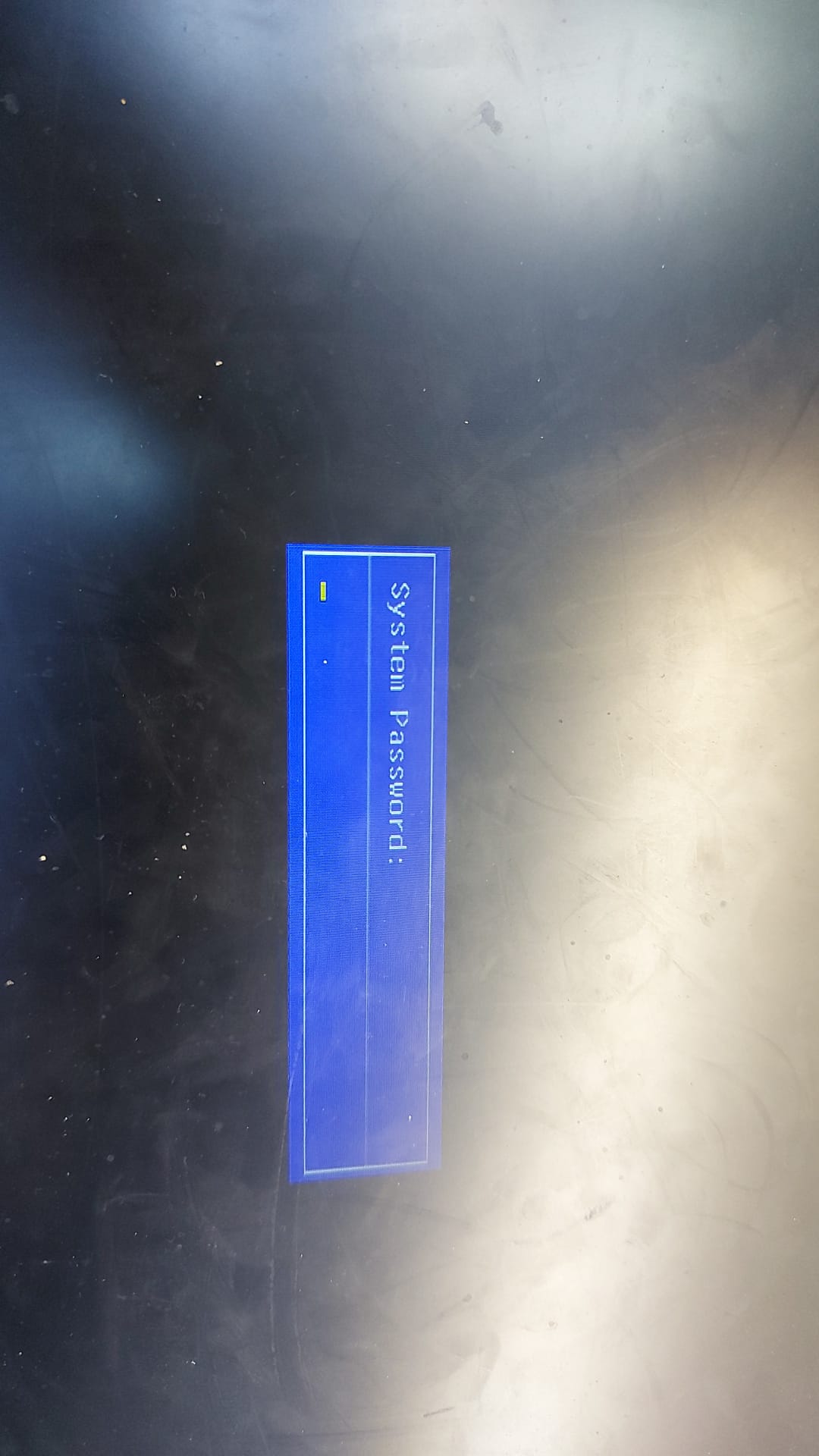

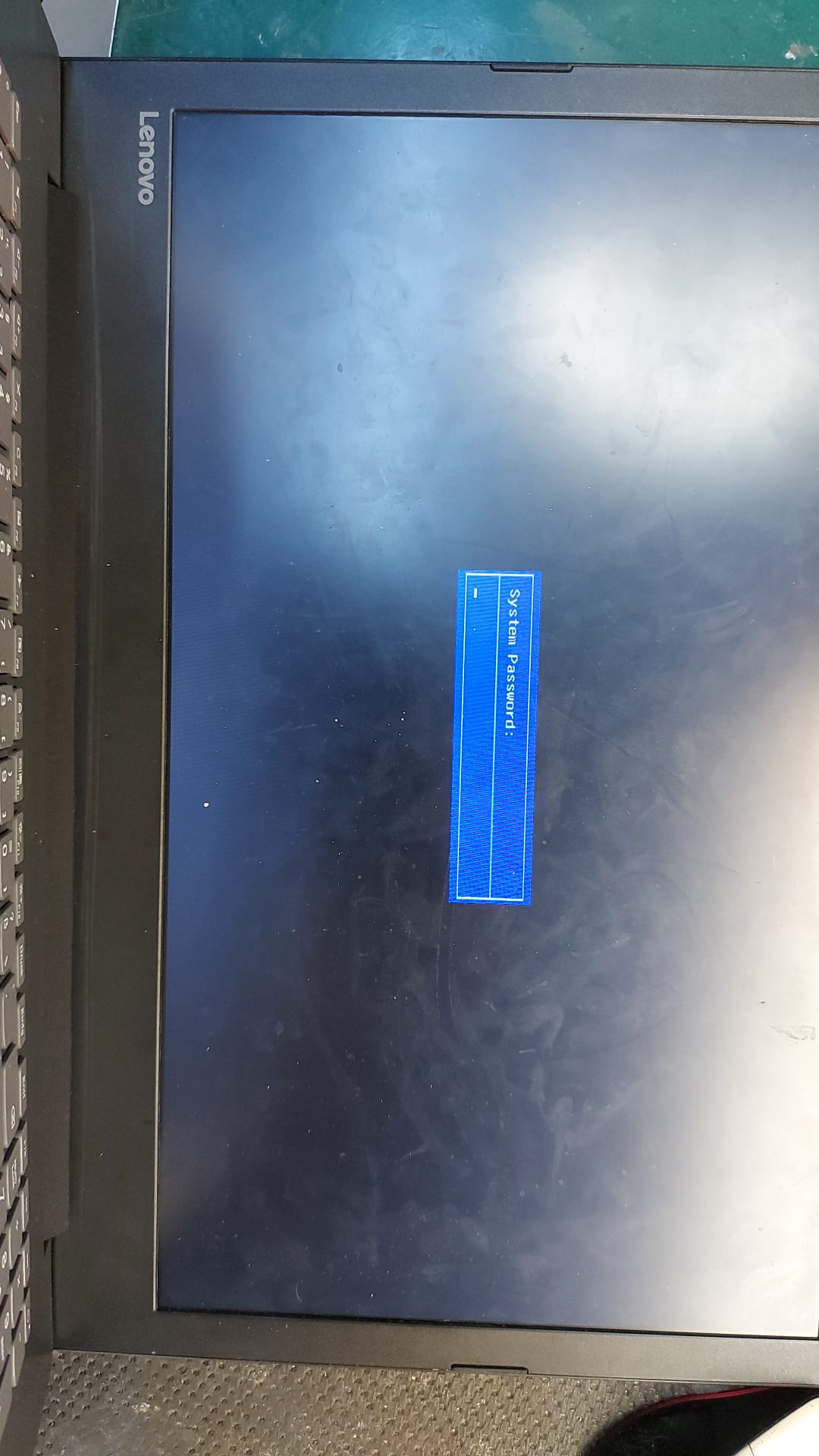

send photo display lock I check ?
Are you sure EC programming is complete?
