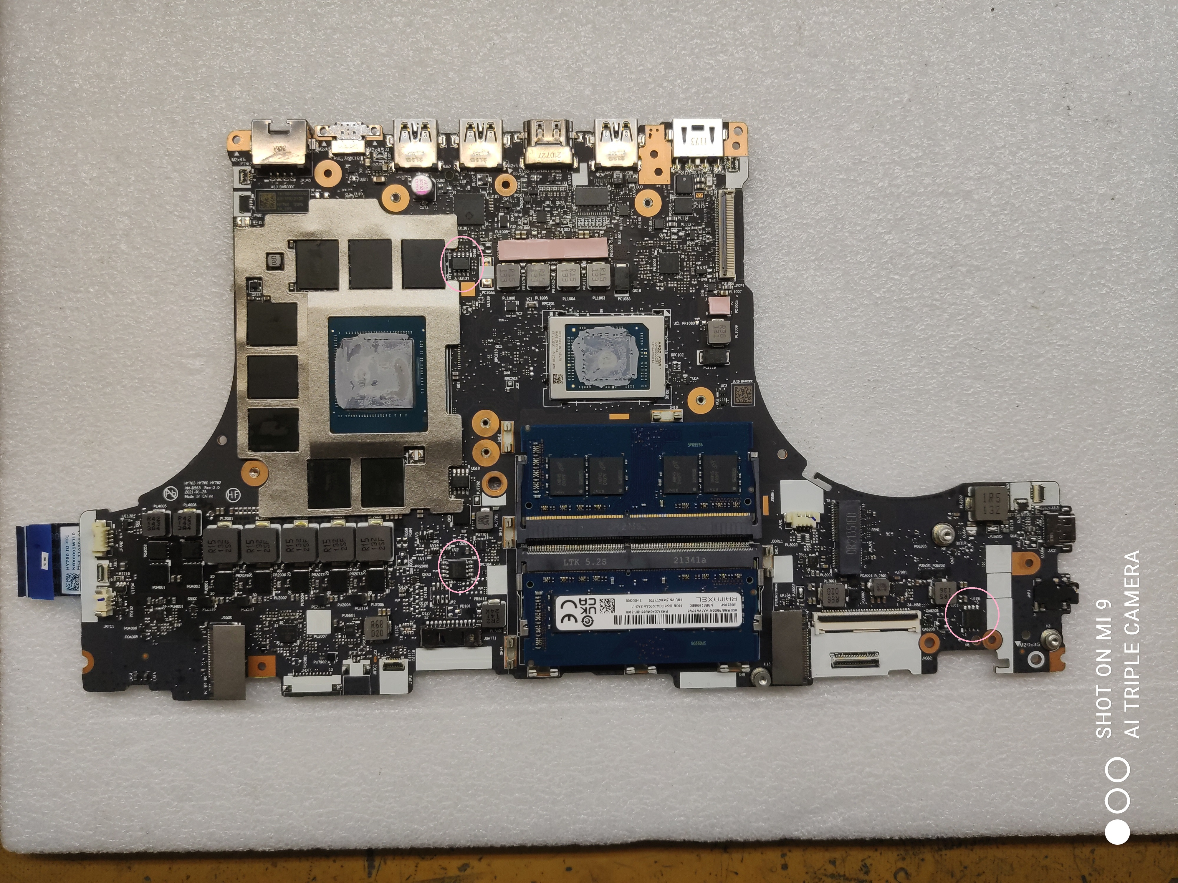

here i have a

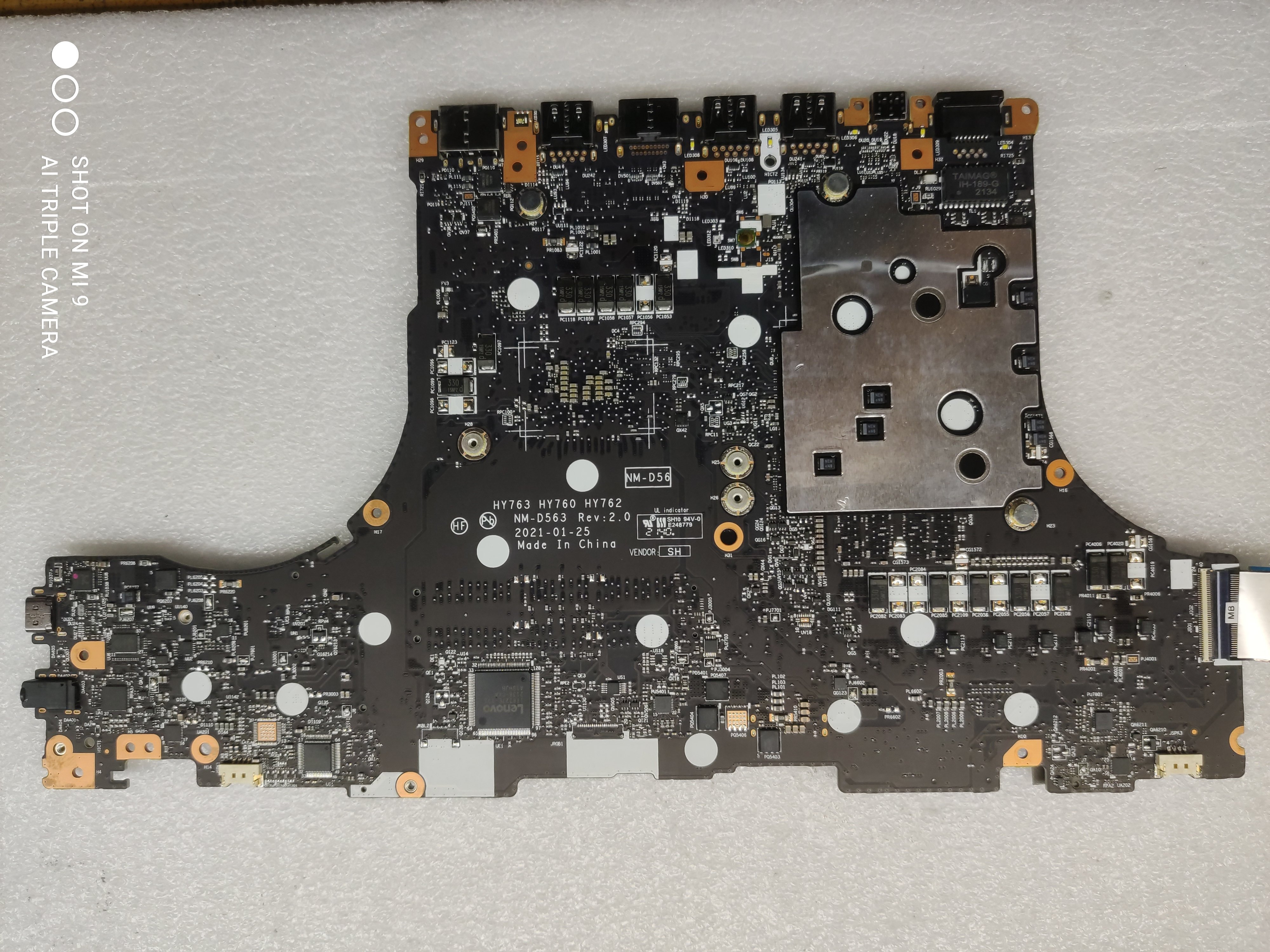

Lenovo Legion 7 16ithg6 HY764 HY765 HY766 NM-D721 REV 2.011th Gen i9-1198QHK,​
with issue Keyboard not working only flashs once the laptop posts on screen , according to schematic keyboard is being controller by IT8258E-248A, do you have IT8258E-248A firmware and Ui26 spi flash 2 Mb UI26 W25Q16JVZPIQ spi eeprom dedicated to keyboard firmware for ( IT8258E-248A) next to keyboard connector. UI26 when i read it it was found empty Blank​
please help , thanks in advance

i need
What i neeed is 2Mb UI26 chip dump, what you sent doesn t match with my model, i checked the 8 Mb file not even Clean ME its alredy initialized , Me version you sent is lower than my version ,15.0.30.1716 than my version 15.0.45.1422 and no DMI transfered
2mb not Programming

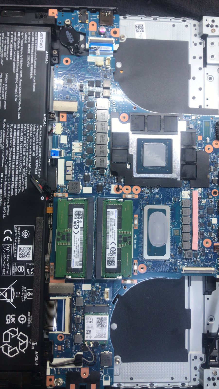

Please rebuild. Legion 7 16-ITHG6 NM-D721 R 2.0 i7 11th rtx 3070. I have attached what I believe is original bios 16mb/8mb from board (not sure if previous user tried flashing)
8mb and 16mb bios from this thread me is already initialized and not working. No display (lcd backlight turns on quickly on first boot if cmos reset). RGB turns on, fans spin. Reboots around every 30 seconds.

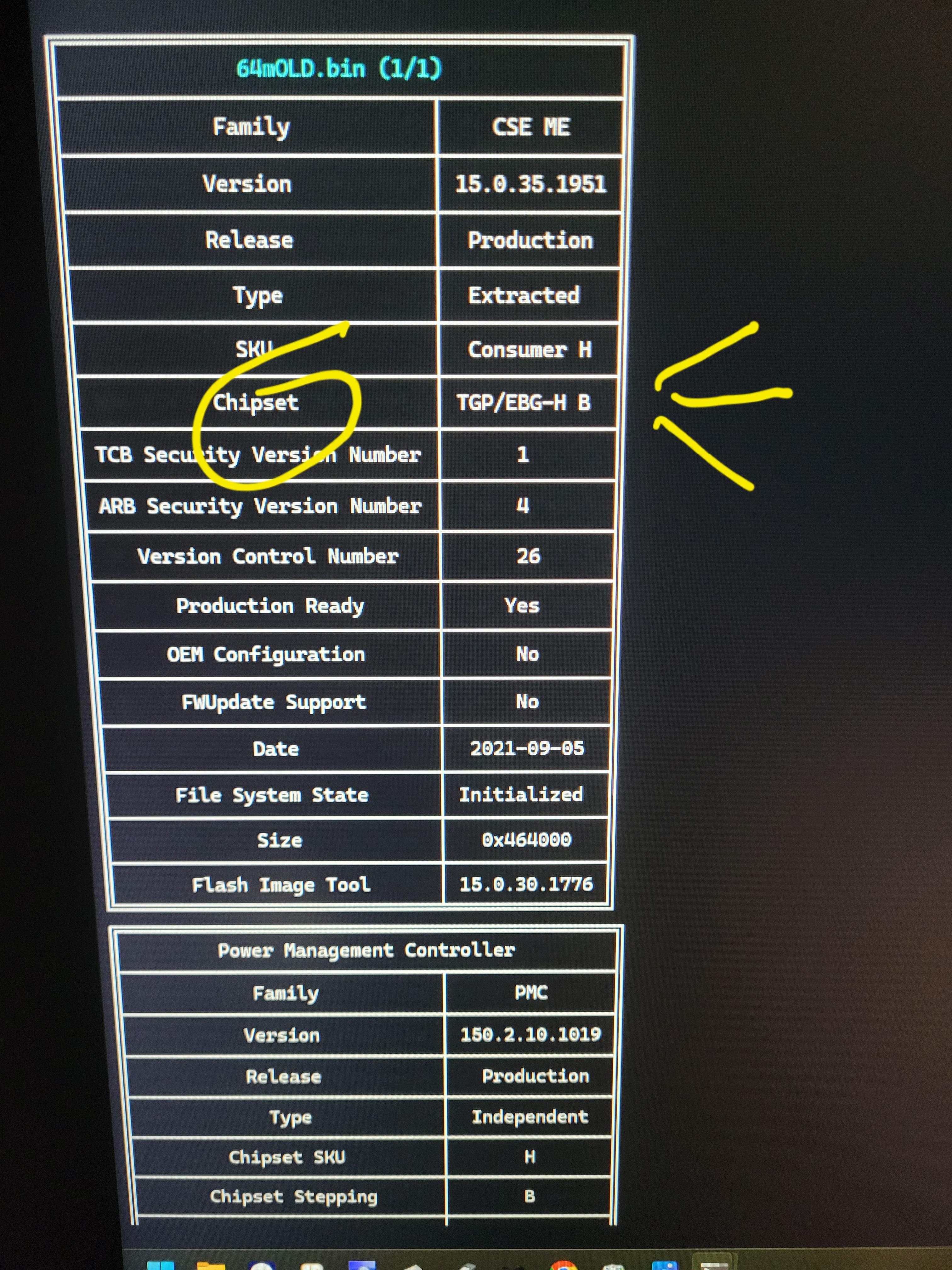

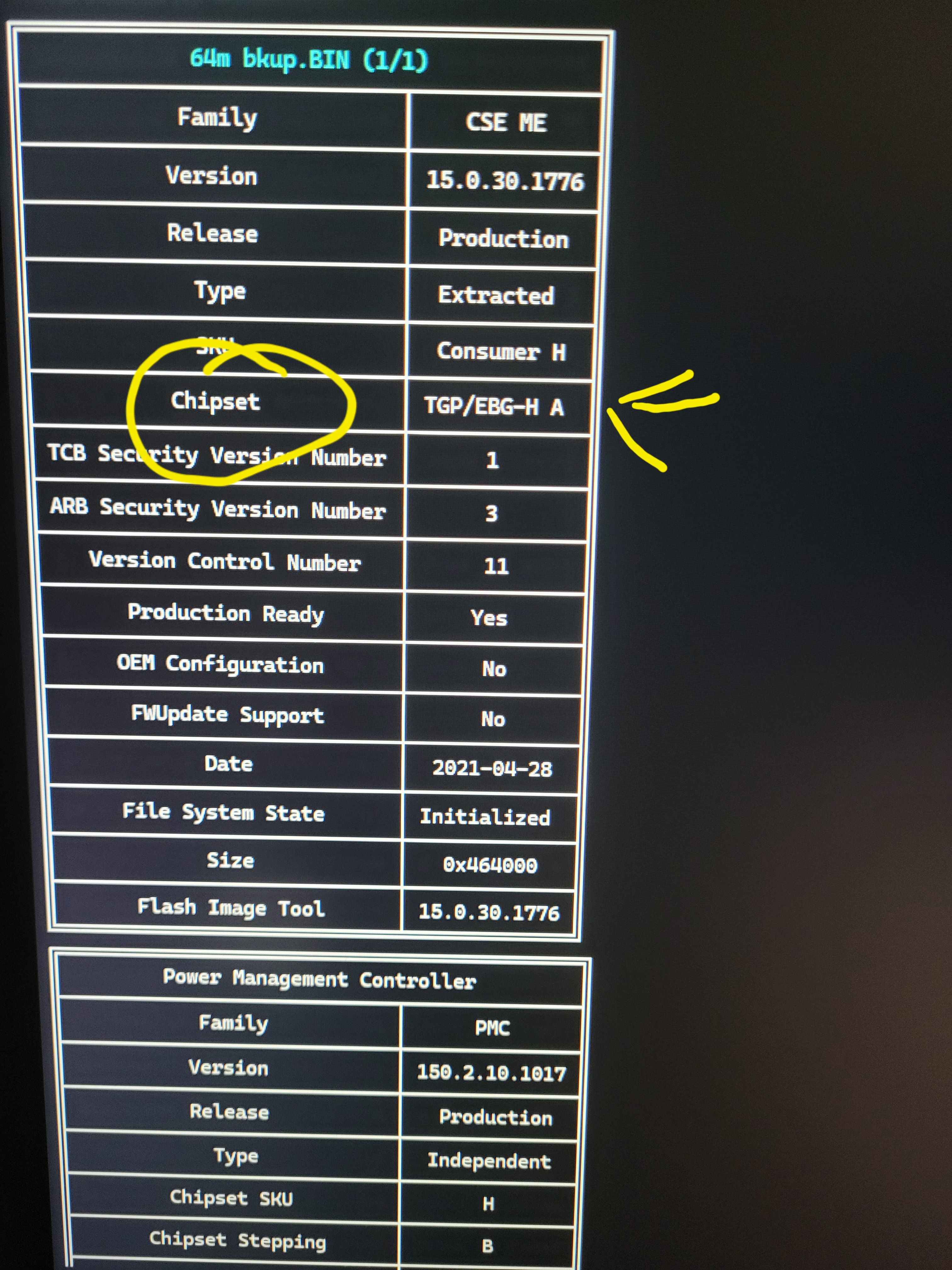

I flashed the rebuilt files and the symptom is unchanged: powers on, RGB works, black screen, restarts every 21–22 seconds. After CMOS clear, the LCD backlight flashes only once very quickly on first boot. I can send video if requested.
Can you rebuild using my original 64mOLD.bin as the 8MB descriptor/ME base? My physical PCH is SRKMA / HM570 B1 and my original 8MB shows CSE ME 15.0.35.1951, TGP/EBG-H B, ARB 4, VCN 26. The returned 8m.bin shows older CSE ME 15.0.30.x / TGP/EBG-H A.
The original 8MB (64m old.bin) should be the correct board ME/descriptor.
