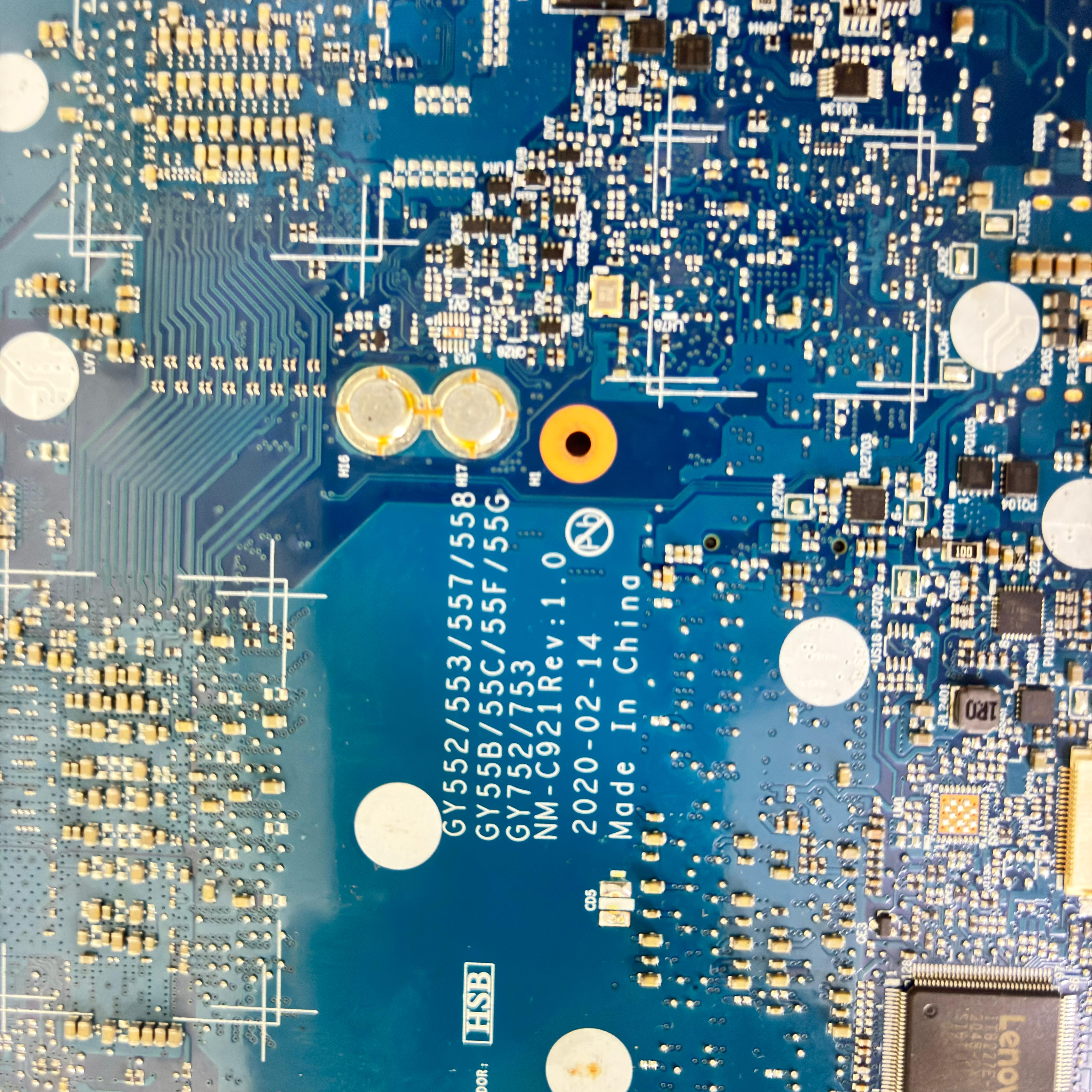

GY552 GY553 GY557 GY558 GY55C GY55F GY55G GY752 GY753
NM-C921 REV 1.0

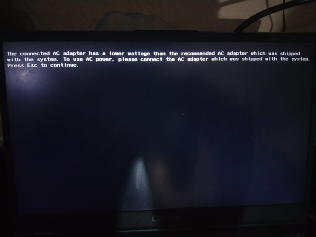

hello sir,
please help me
is this error is bios problem
but we are alreday change the adapoter and battery

This is bios oroginal of Lenovo Legion 5 15IMH05 S/N: PF2LZXAJ no video on LCD screen only HDMI work ok.
“The UX2 IC with the marking WE OUG (type >G2898KD1U_TDFN14P_2X3) is faulty — it is burned out. Please check this component, as this was the root cause in my case.”
