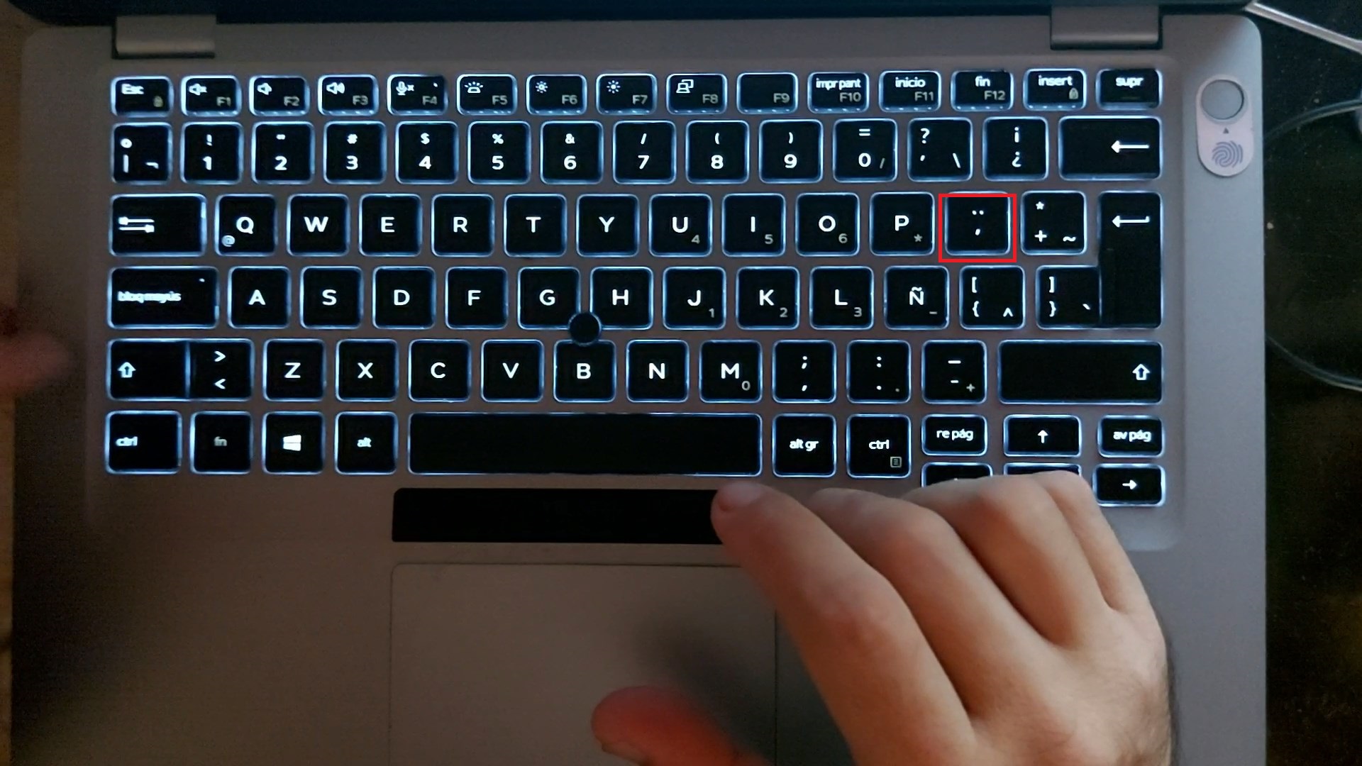

Así le estoy haciendo
You did wrong you press wrong button open bracket.The above password is US standard keyboard.you press only open bracket next in P button in video you press with shift or wrong button
thanks, but can u try check again. I have still late display and he always restart few times when try run:
