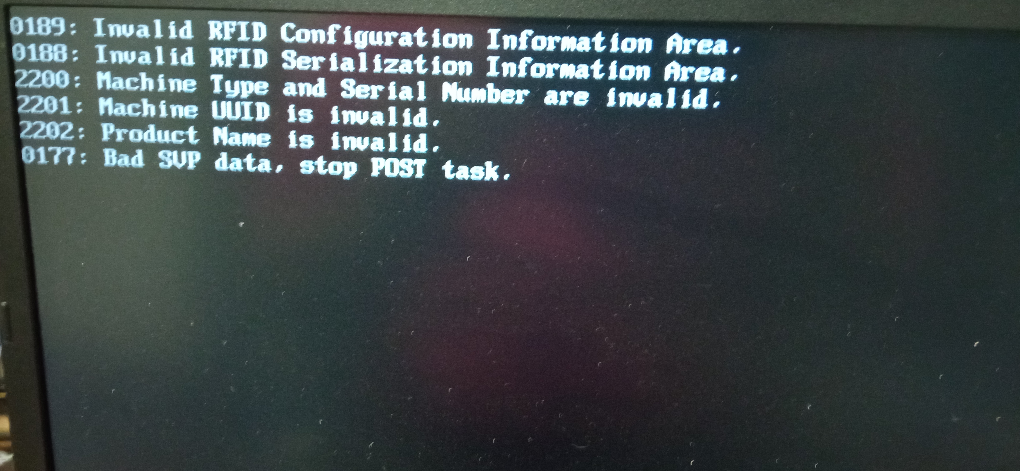

do you mean clearme can fix all computer errors??
I mean that I have this bios working fine, but when I copy to another mother it doesn´t have ME version, so this bios works but it hasn´t got clean ME. When you cleared ME this bios does´t work, no turn on the mother
If you don't trust me with clearme then clearme by yourself
this file doesn't have enough data, i think that's the problem when you backup
now laptop error what ?
can you remove password? I tried the one here but it gives me errors
that's the limitation when programming EC it will leave this error
try tool this
