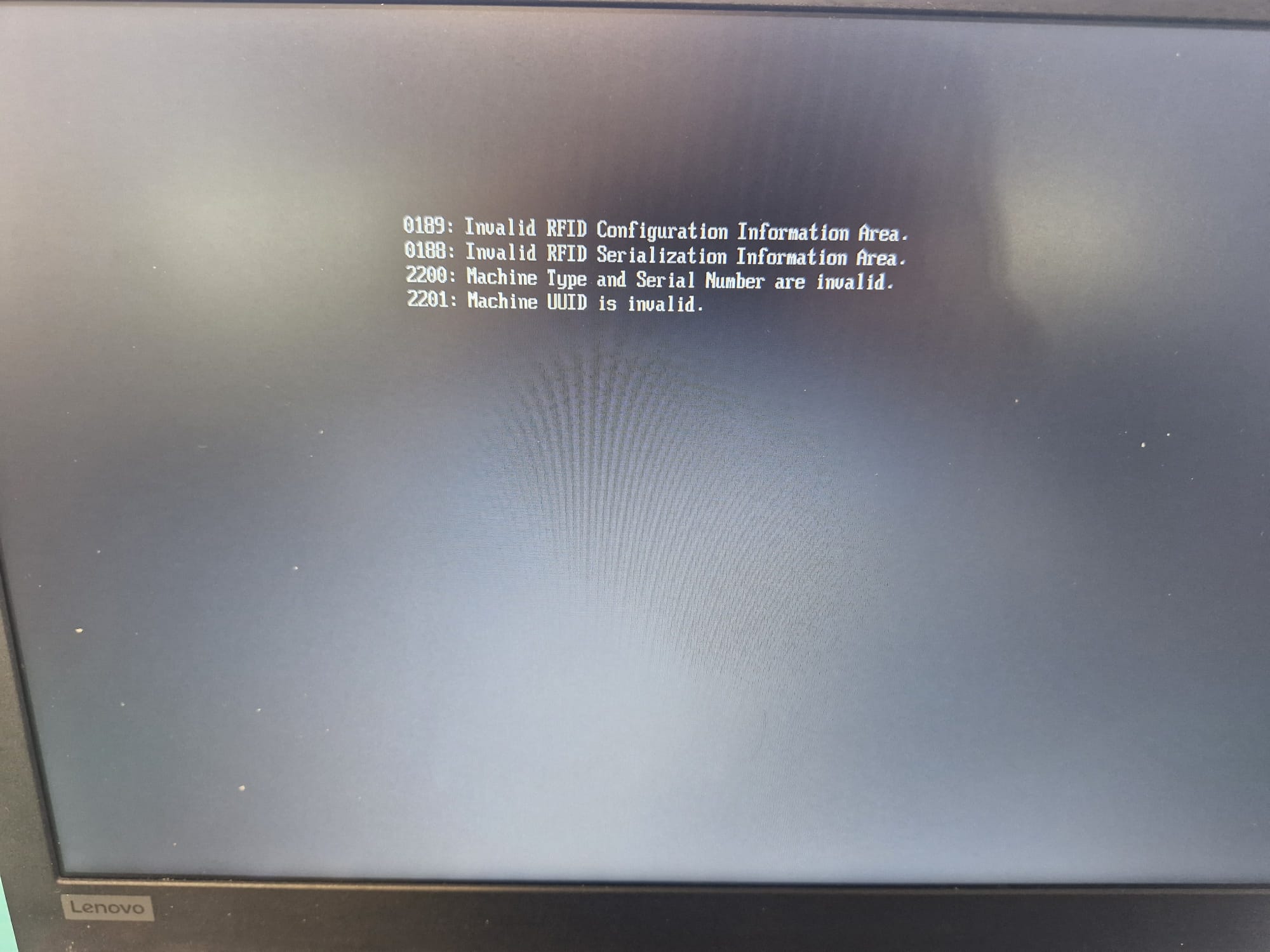

HI I programmed the ITE chip with the firmware from the main post. Now I'm getting this message on the screen. What can be done about it? Before programming the ITE, the laptop was working without these errors, but sometimes it wouldn't turn on.
This is an error due to the I/O programming board
Need to buy patch $ 30 to fix
