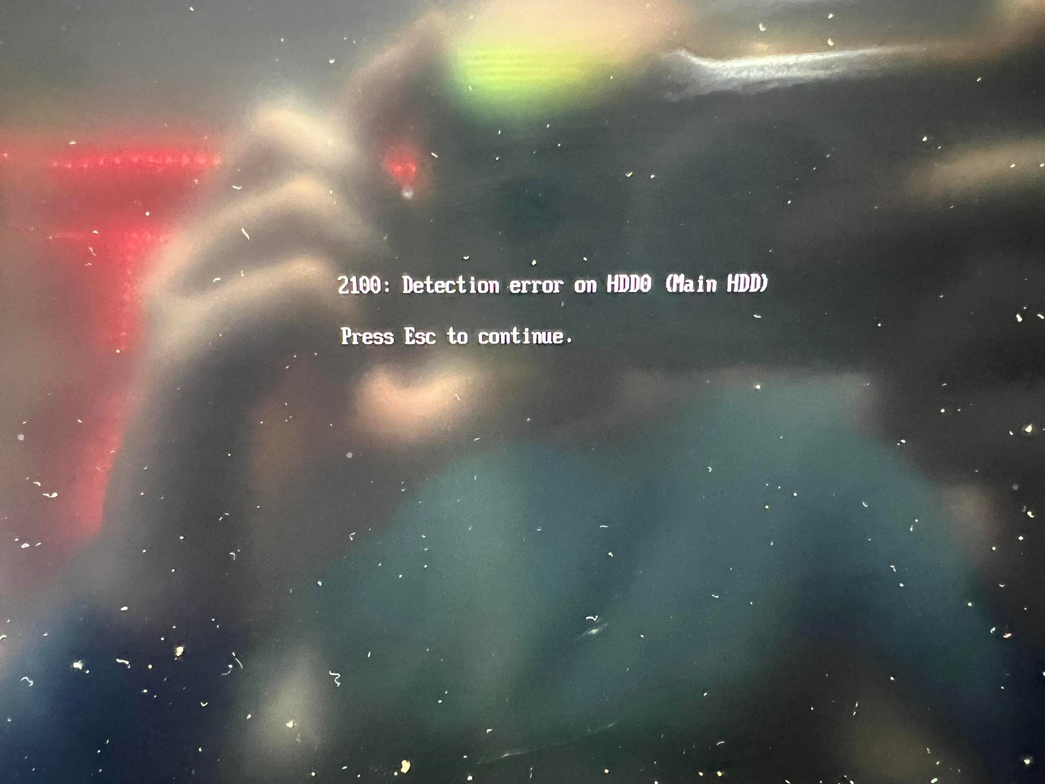

Everything was OK. After replacing thermal paste nothing on screen and werid Lenovo melody.
I repaired old bios and have display. But only left that 2100 error.
It's 100% problem with the bios because before cleaning laptop working ok with that disc.
