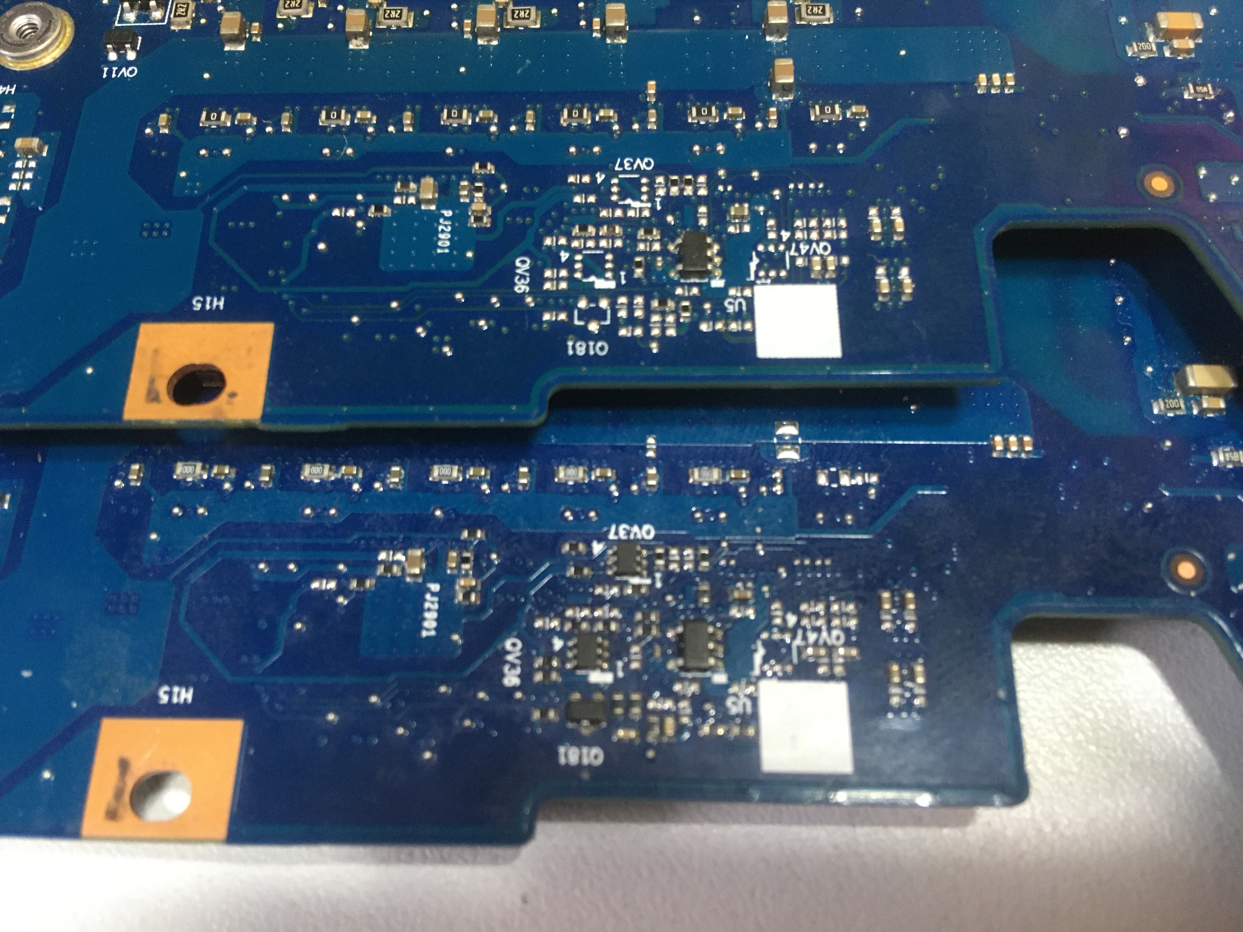

Hello ThienBui,
I have two motherboards NM-C361 which have different way of EDP_AUX. One motherboard has CPU_EDP_AUX, and the other has IFPD_AUX, comming from gpu.
The only thing that was broken on the motherboard with IFPD_AUX whas the EC. I replaced it, and programmed it with your file. Problem, I have no display on laptop display, but I do have display on externel screen. LCD cable, and screen tested, and are oké. 20v is on lcd connector. Also pin 16, 21, 24, 30 have 3.2v, and pin 19 has 2.4v.
Both laptops have same gpu, but cpu is different. On CPU_EDP_AUX it is i7-9750H, and on the IFPD_AUX it is i7-9750HF.
Are the EC, and BIOS file for both laptops the same?
Do I need to have voltage on pin 11 EDP_AUX, and pin 12 EDP_AUX#?
Hardware is difficult to diagnose online I can only help with BIOS related errors
Read question from again, because I ask you if there is a difference in the EC and BIOS files with two motherboards, both NM-C361, but different way of function.
Theoretically the same Motherboard code will use the same BIOS file, but there are many hardware problems that lead the BIOS to work differently...
