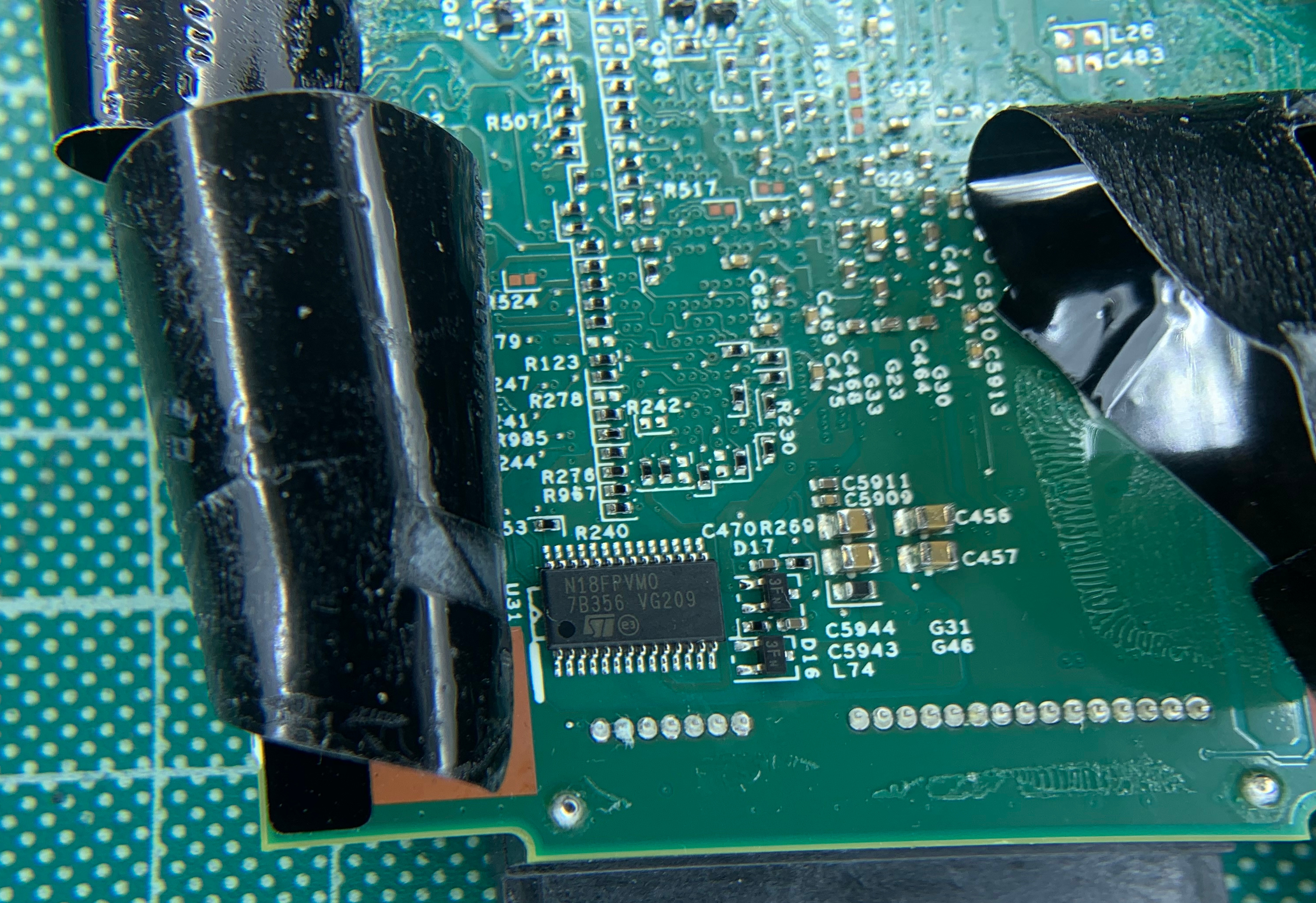

I am looking for the LPC/SPI Pins from the TPM on a Lenovo W520.
Is this Part the TPM (Trusted Platform Module)?
Where can I get a datasheet/pinout for N18FPVMO?

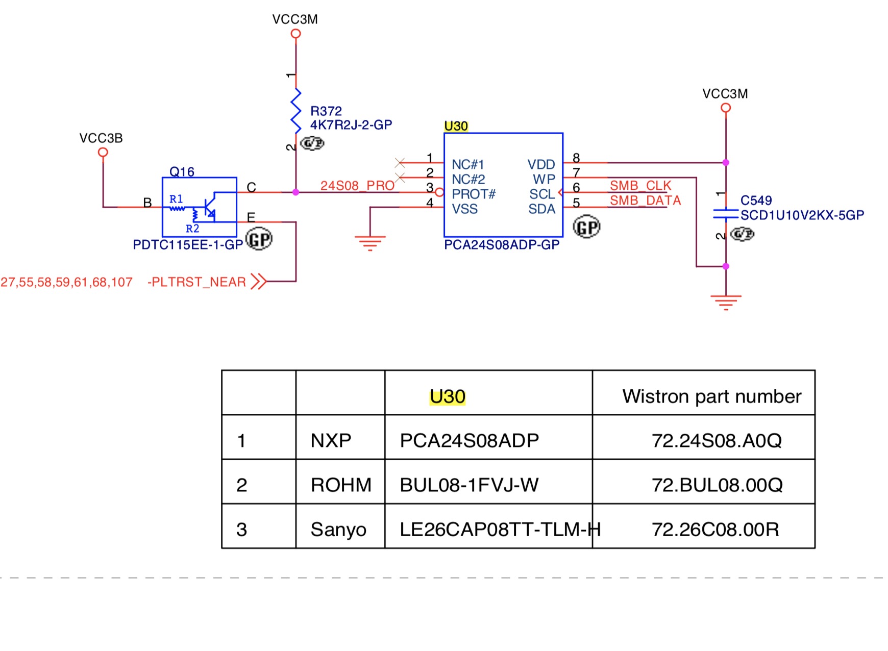

I think I have found what I need with the schematics - the "Golden Finger for Debug" (DY), but where is this located physically on the board?
