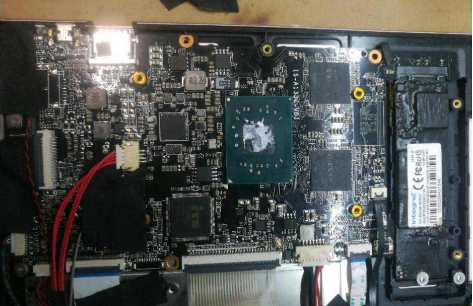

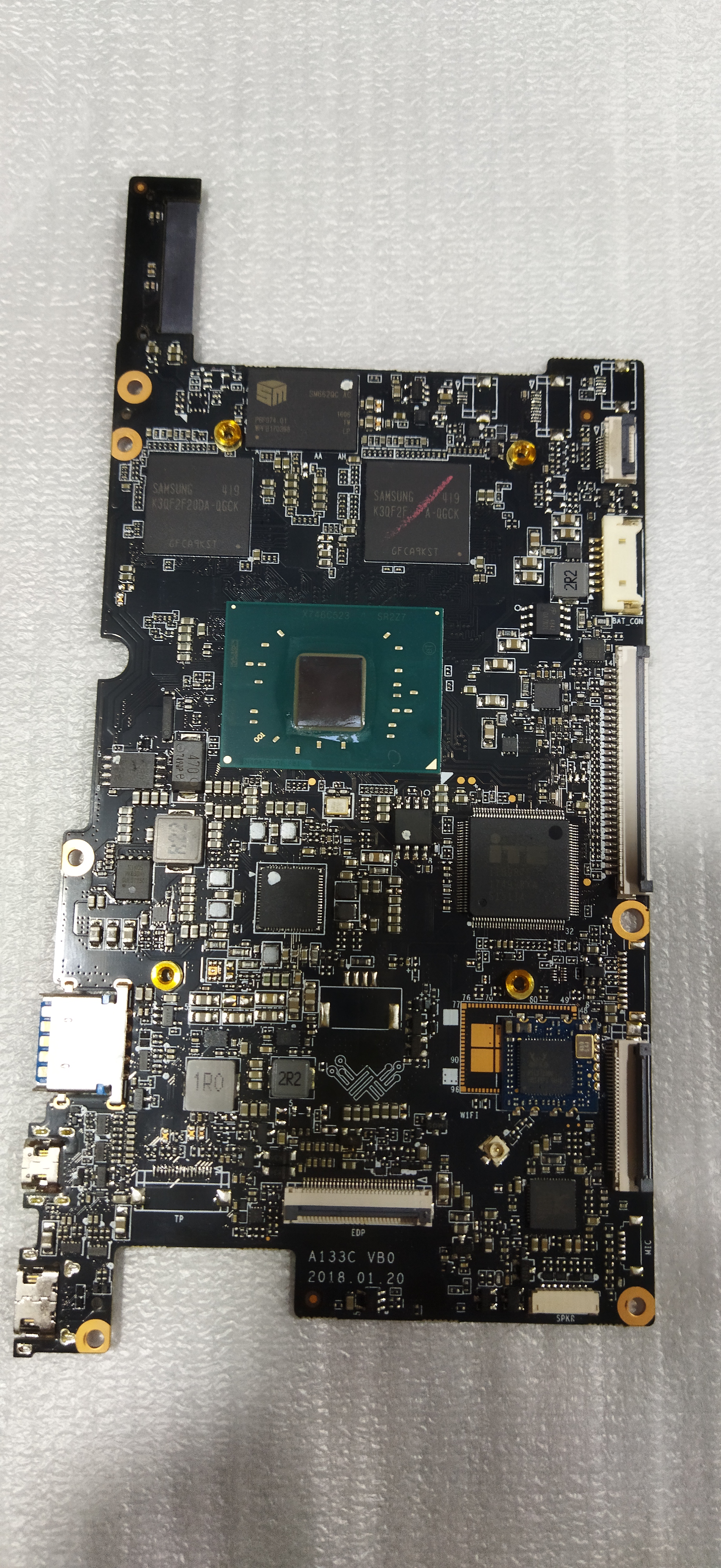

BIOS IS-A133C-VD1 GD25LQ64C_1.8V In-SG133H-C VD2
Old bios had password, but after desoldering chip damaged, couldn't even back it up
So I think you need to check that position again, replacing another IC can also make the Motherboard not work.
Note that it only uses 1.8v, make sure your setup tool supports 1.8v
I know all that, I've already checked more than twice, I have replaced the SPI chip with one working same brand same model (GD25LB64C) reprogrammed it with the file you provide, laptop doesn't have image, what I'm looking for is the file for that model, not a file for another model that is a different processor architecture, obviously it won't work, anyway I've searching over internet couldn't find it, btw thank you for your time.
