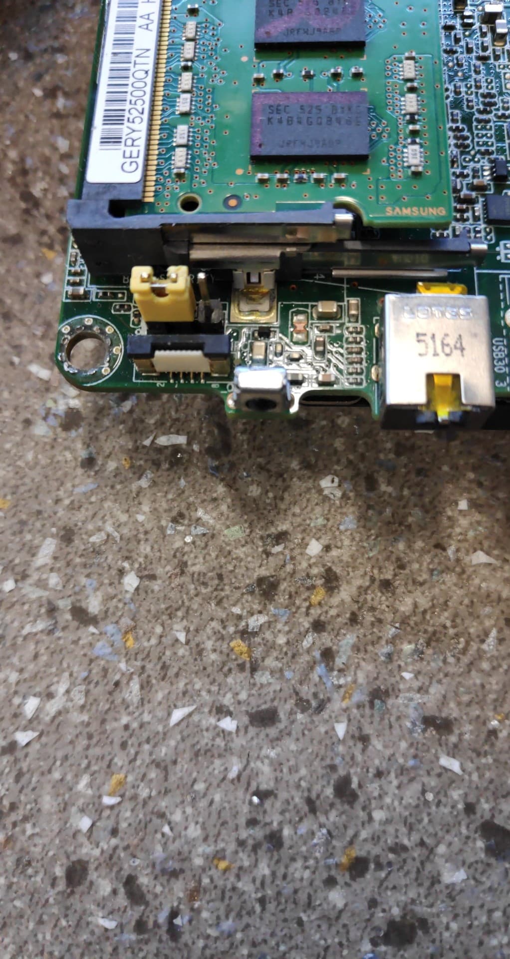

BIOS Intel NUC5i7RYB
i removed jumper and it runs now, do not you know, what is the purpose? when i put it back, it does not work. Does it need do be on there?79702848_1237266936461061_1752182975564349440_n.jpg
Good morning
Could you see if the BIOS is functional?
Everything on the PCB seems to be operational. Starts up but no picture.
On these BIOS from the forum similarly.
The original which was in the attachment.
Intel_NUC5i7RYB.bin
hello, after power on, power LED blinks 3 times. What i found, it means memory error, i tried brand new RAM (PC3L) in both ram slots, but issue continues. Any idea why is it doing this?
