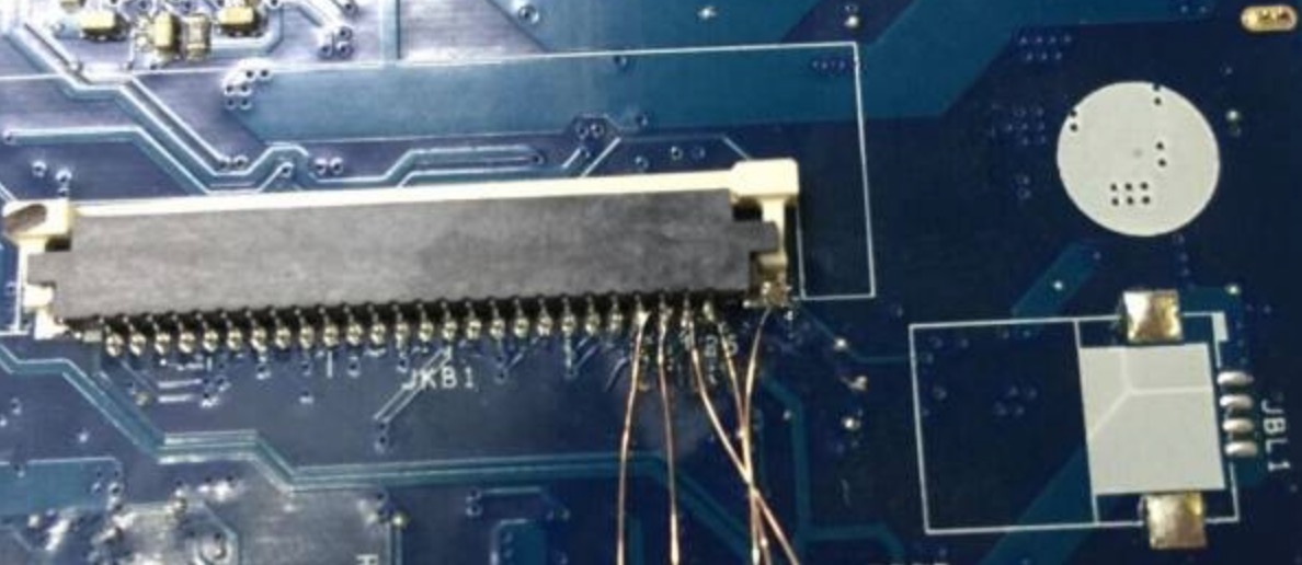

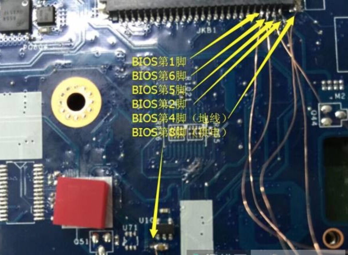

Greeting Master ThienBui. i have this model problem no display After a few seconds 2 to 4 turn it off. if I try to press power up. Check all voltages on the mobo usually have +3 and +5v. used this posted bin file to load in. Yes have a display problem with the Windows activation for license authentic and also the post or boot up is slow. anyway, I would like to fix or repair the original Bin I have a copy of the backup bin. thank you and Good Morning

i think you need to try another bios to compare first maybe not bios problem
I try to download Build902. i flash using this bin. no display. compare the bios post have display. i think need repair or build my bios bin send before can you do to me please?

Please not use bios builds it's only for old BIOS vendors
